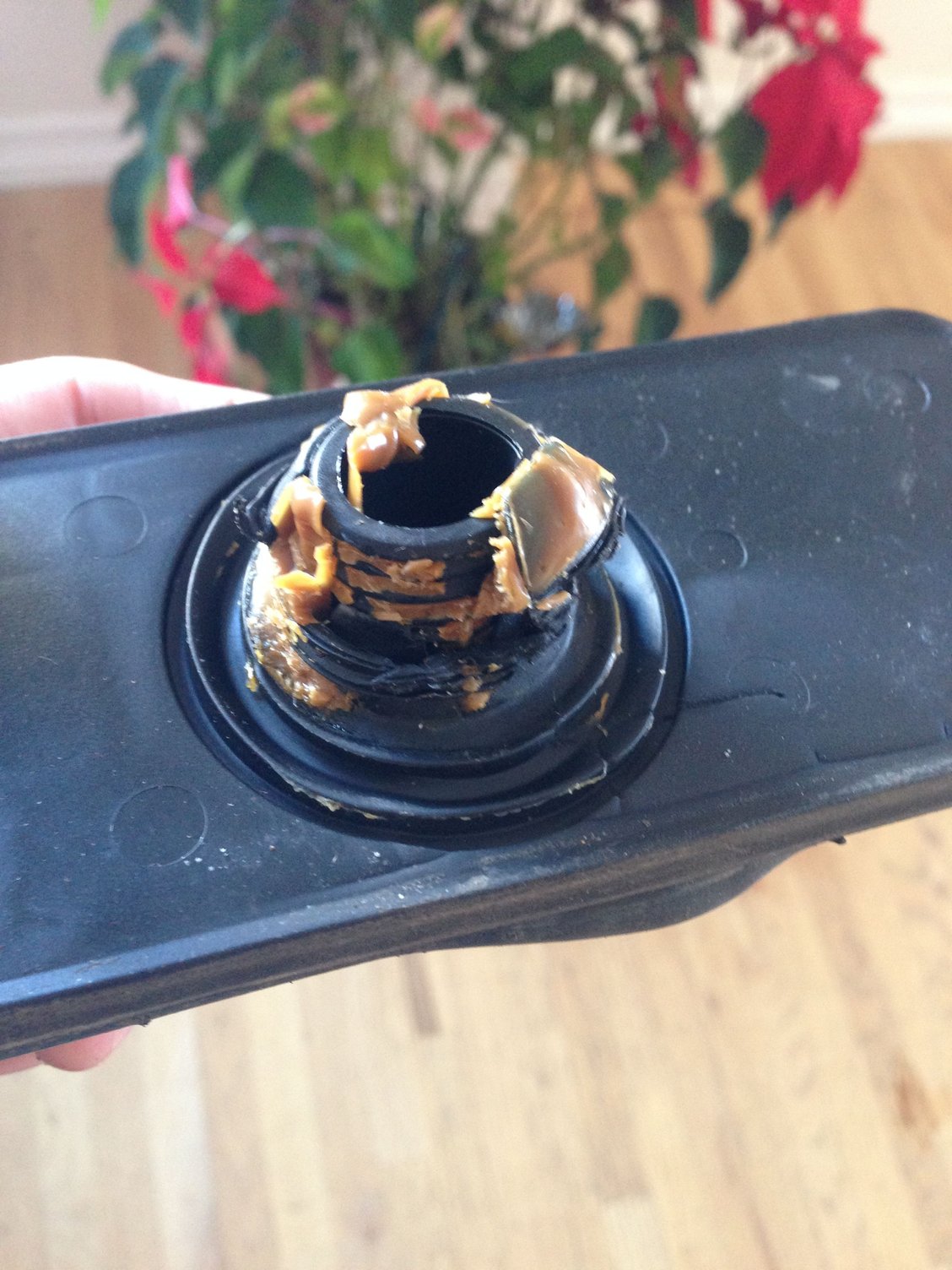

I was changing a flat yesterday, and did everything as the manual says (not my first time changing a tire, but my first time using the jack kit that came with the car). I had the car jacked up and the wheel off, but before I could get the spare on, the jack point completely broke off the car, car when to the ground, and the jack went up through the side faring and dented my door.

The jack point where the little white plastic dohiggy on the jack fits into is plastic. And it straight broke off the car.
I contacted MBUSA and they told me that it might be under warranty, but there are certain exclusions, and that I would need to go to the dealership to have the service manager determine if it is under warranty. Basically said that service manager's word will be taken as fact, so I'm hoping our service manager will be on my side! I'll update after I take it in.

I thought they were hard rubber, with a rectangular cavity where the plastic piece from the OEM jack fits in. Either way, I don't see how either part could "break off"... Tho only way I could imagine something like that happening, you'd have to have some sort of horizontal shearing force that might cause some damage to either.
If the car had been jacked up properly, then the forces that are in play are vertical -i.e. the weight of the car loading down on the jack... A wild guess is that in this case, the car rolled in one direction or another at which point, the jack swung up and out from underneath it and dented the door!

The hard rubber piece with the cavity is what broke off:
The tire I was changing was the driver's front... I had the passenger rear chocked. Here's the confusing part: The manual says to use the chocks, if so equipped, and then says to chock the front and back of the tire. My car is only "so equipped" with one chock, not 2. Since I was jacking the front of the vehicle, I chocked the rear of the opposite rear tire, as per the instructions... assuming that if I was jacking the front, movement would more likely be backwards than forwards. Anywho... My kit doesn't even have a space for a second chock, so not sure how I could have chocked the front of the tire anyway.
