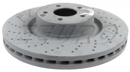

Is your Front rotors drilled or solid..?, see attached...
*Drilled rotor:-
What are the part numbers for front and rear brake pads and rotors?-2044212812.jpg
*Solid rotor:-
What are the part numbers for front and rear brake pads and rotors?-2124211312.jpg
ZAYED,,

*Front rotors #: "212 421 13 12"
*Rear rotors #: "204 423 15 12"
**Front Pads #: "007 420 57 20"
**Rear Pads #: "007 420 60 20"
ZAYED,,

I'm really sorry, I just went and checked. The front rotors are drilled, the rear rotors are not. Again, I'm sorry!

Front drilled rotors should be "204 421 28 12", all other #s are the same...
