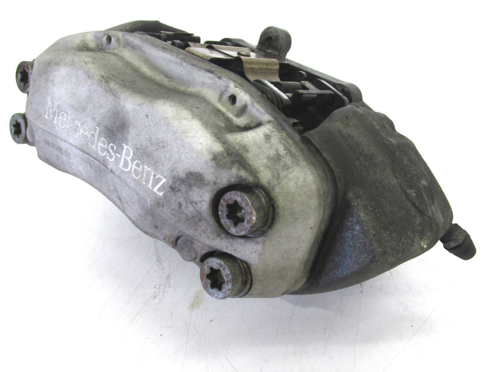

This caliper can be fit to the C350 ?
Old Jan 17, 2015 | 11:31 AM
Scoop SJ's Avatar
Joined: Jan 2015
Posts: 7
From: Seoul, Korea
2009 W204 C350 Sport, 2012 BMW Z4 35is
Question This caliper can be fit to the C350 ?
Front..... W211 E350 4piston caliper
Rear....R230 SL500 2piston caliper
This calipers can be fit to the my W204 C350(2009) ???

It would be trial and error, the E350 has a 330mm disc with a 64.9mm hat, the C has a 64.5mm hat... So the 4pot setup with the 330mm rotor may work

hat????
Do you mean disk offset?
Processing the caliper or change the disk?

yes disc offset. I believe the 09 c350 use a 322mm rotor, so you would also need the 330mm rotor to use with this caliper you have pictured.

Wink same holes???
size between the caliper holes and the knuckle holes the same?
