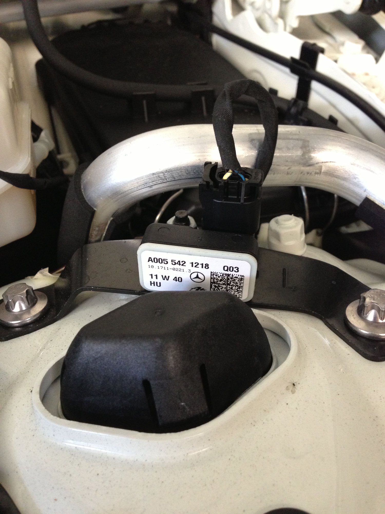

Depends if the car originally had the "Dynamic Handling Package". If it does, then it changes the following...
>Start in 1st gear (like you already mentioned).
>Later shift points when left in auto.
>Shocks become stiffer
>Steering becomes stiffer.
You can tell if it has this package in 2 ways...
From the inside. Notice a dedicated "SPORT" button. On regular W204's the button near the shifter will say C/S instead of "M" for manual.
From the outside (engine bay) you will see a control module on top of each strut tower that is controlled electromagnetically.
If you do have this congrats. Generally, unless you specifically factory ordered it, you will not see this option in the US market.

Great info, thank you. That's too bad. Someone else sent me the original sales brochures and options for the 2012 C350, and it implied it had all the Sport stuff available for the model - there didn't appear to be separate options as you list them. They referred to the model as the C350 Sport and grouped it among Sport models of the 250 when you chose those optional packages.
My shifter says E/S
I'll check my struts.
All your info is relevant to the 2012 C350? Just checking.
