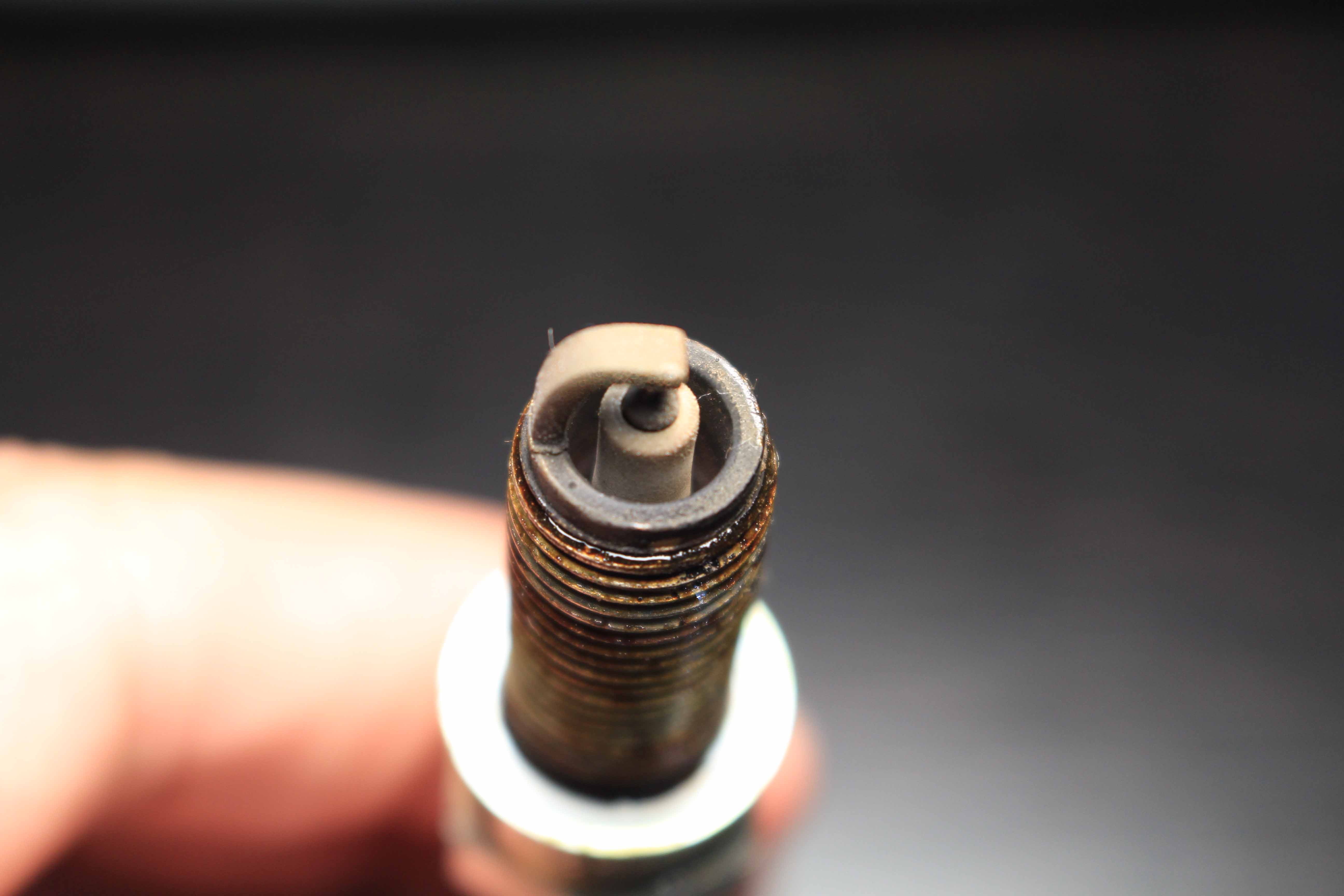

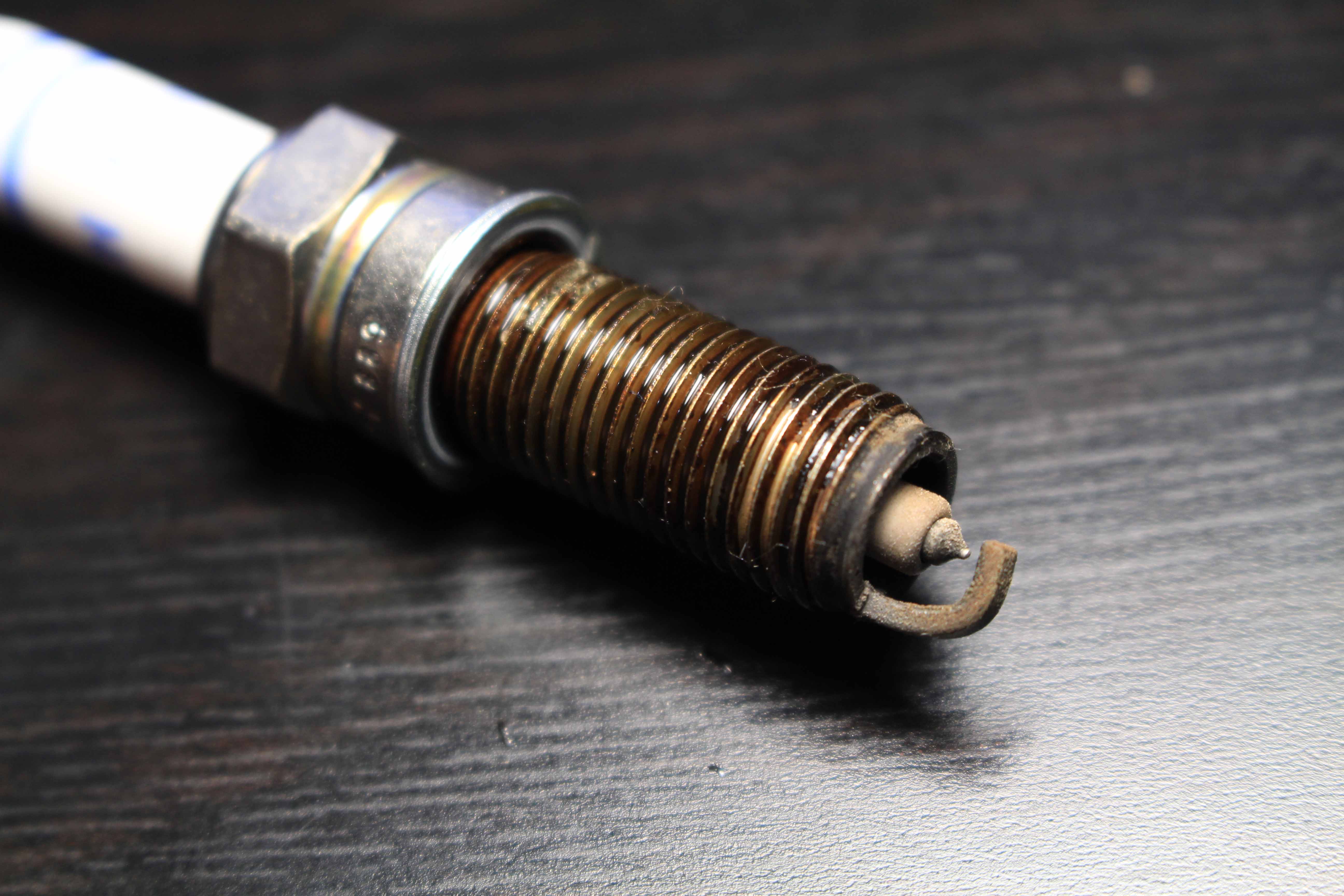

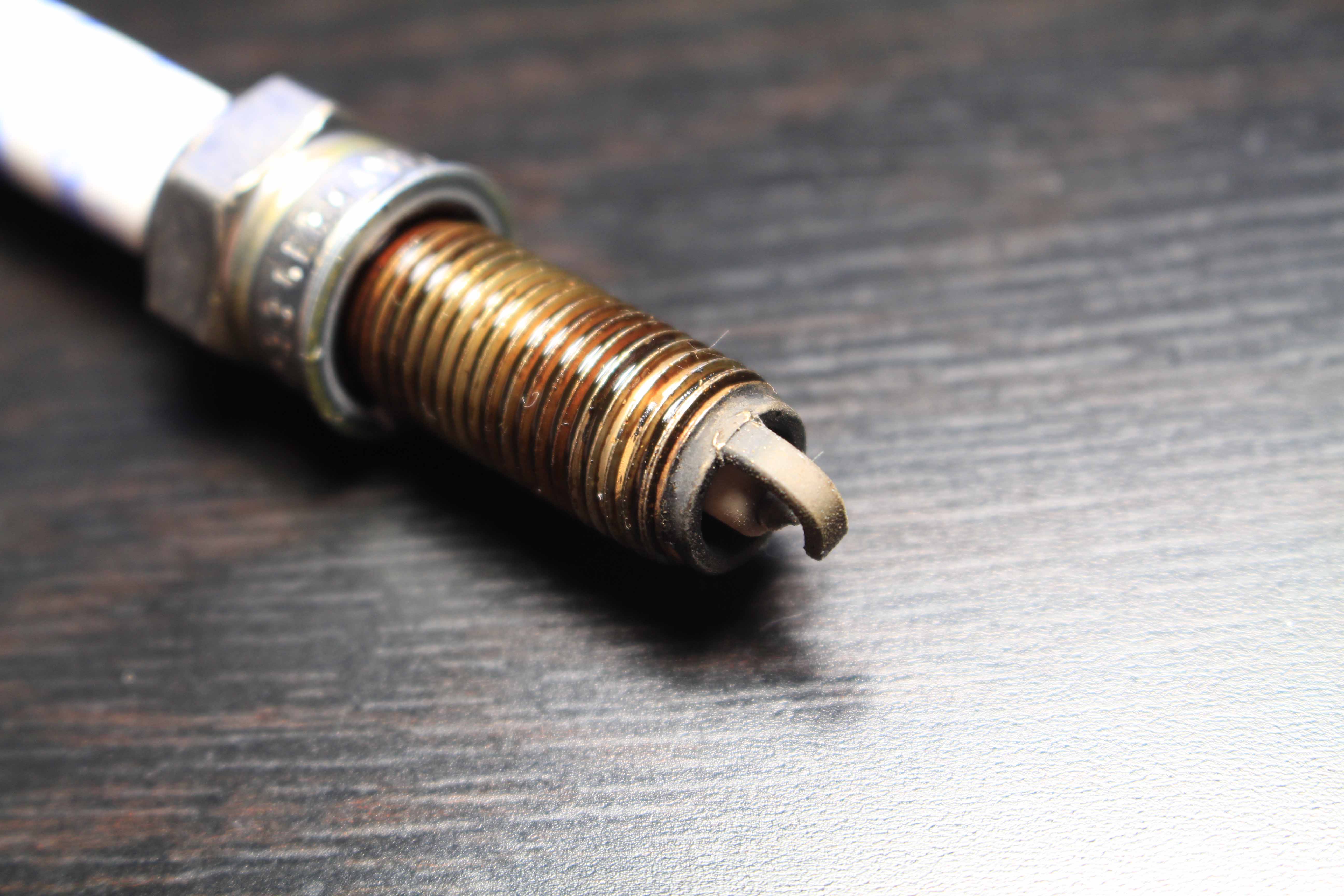

Just pulled the plugs yesterday and replaced them. This is what I saw and since this is the first time I pulled my own plugs I have no idea how bad they are. I know you can tell a little bit on what is going on inside the engine when you look at the spark plugs but since I am no mechanic I would like people who are technically inclined to give opinions on what you see here. The motor has 102k when I pulled it out and I believe this is the original spark plugs from the factory.

Old Mar 29, 2016 | 02:07 AM
95Sinned420's Avatar
Joined: Mar 2010
Posts: 477
Likes: 124
2016 S550
Those plugs actually look good. Very normal, no signs to be concerned of. Seems like a healthy engine to me. No visible abnormal wear/corrosion or excessive deposits. The brownish you see is very normal. In fact, if you pull the new plugs after 5k miles, it'll have the exact same brownish color. Keep up the good maintenance
Also, the threads have anti-seize material on it. So if they're original, it must have been applied from factory. I don't recall the boxes having a notation about not using anti-seize. I've never heard of that, actually. I did my plugs several months ago and used it as well.
