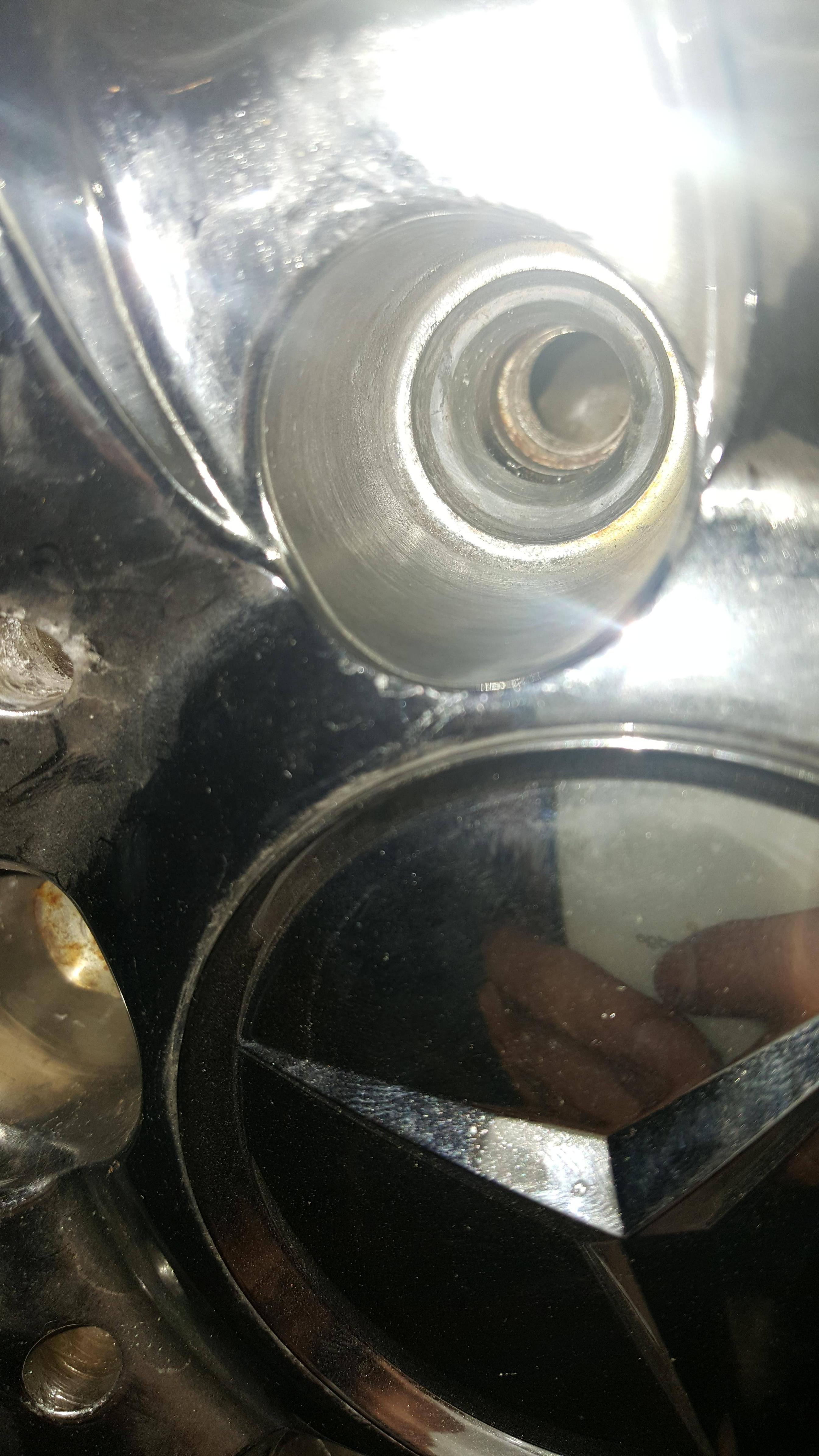

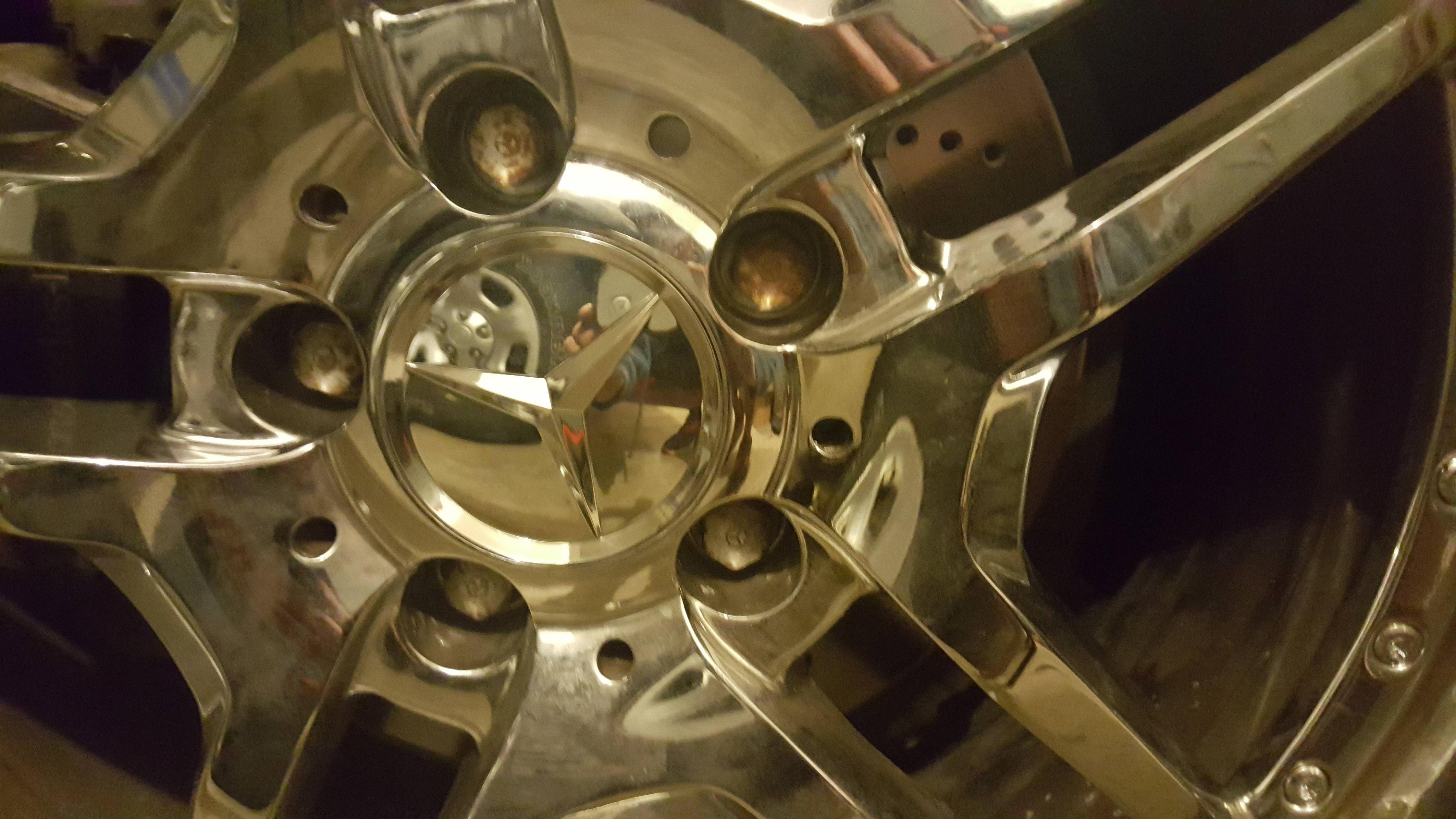

The back bolts (oem) sit flush while the front sit much deeper. I want to try and find bolts that will sit flush with the face of the rim in both front and back. Not sure if it's even possible to find extended head bolts that fit.

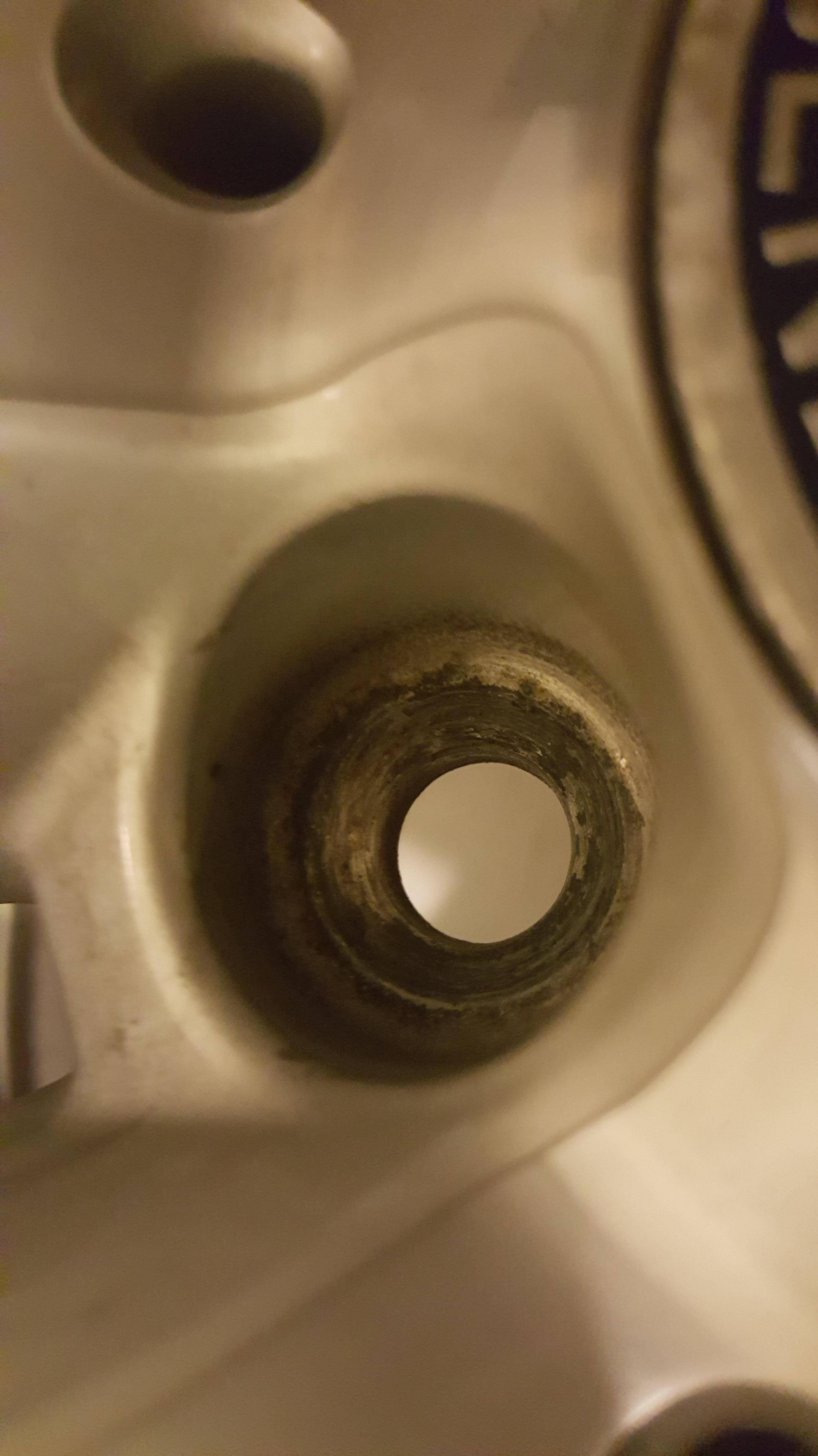

Apr 6, 2016 | 08:58 PM
My aftermarket rims definitely look like they use conical, which corresponds with what the manufacturer said.
OEM rims Ball seat
This is how the front and back bolts sit in my aftermarket rims.
FRONT

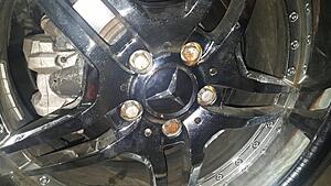

BAC

Apr 7, 2016 | 03:58 PM
Quote: Despite being the same size the car would not move at all. Also the front bolts sit far deeper inside the wheel then the rear lug bolts. Why is this?
Take a closer look. The replacement bolts have a different angle on the heads that'll make it go in further.
