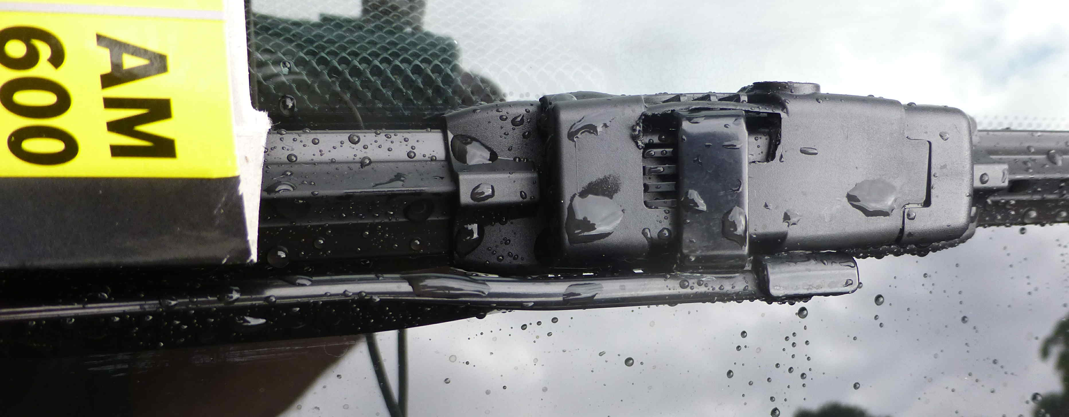

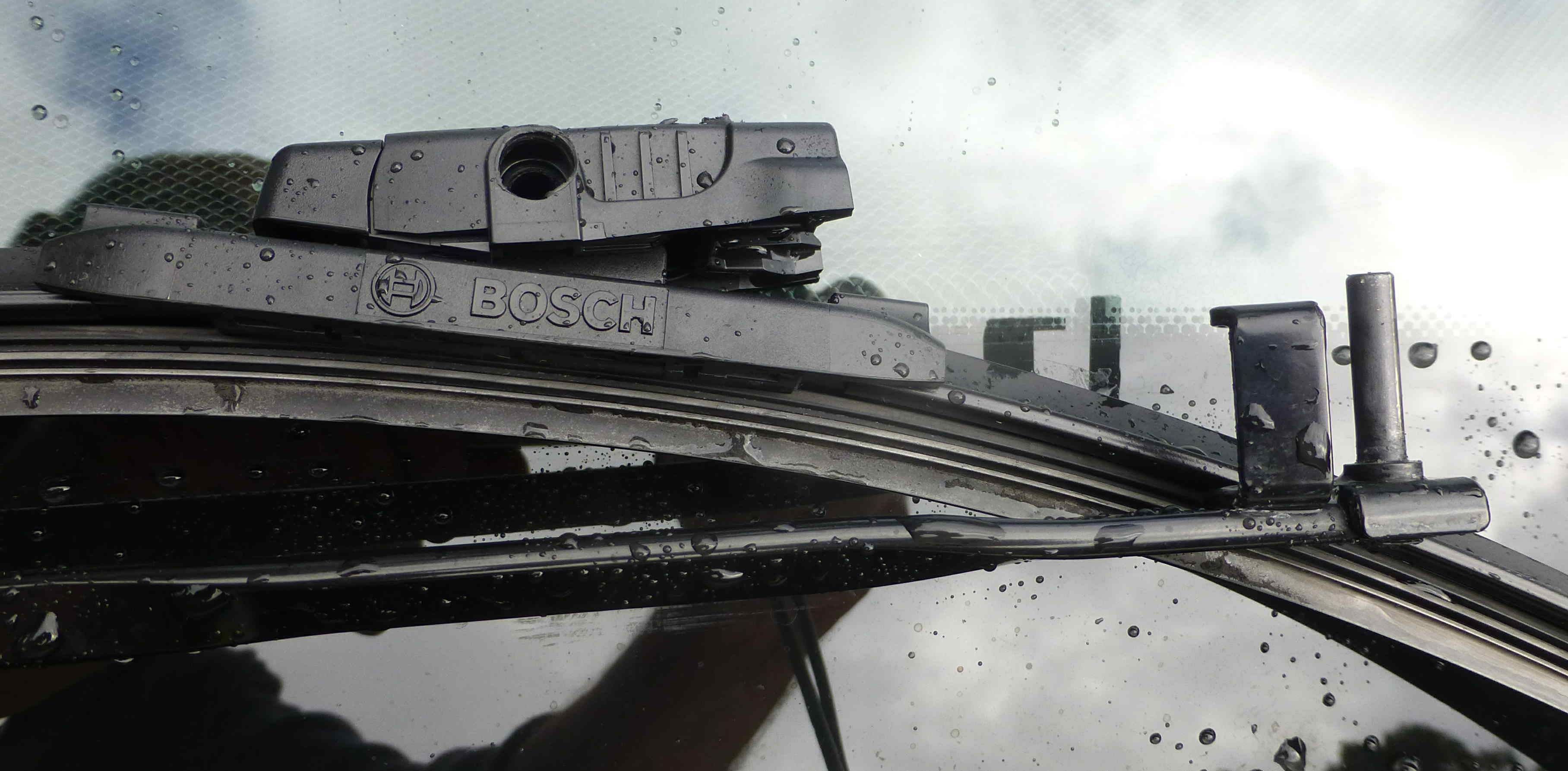

Originally Posted by NUFC1975
Thanks Carsy, that's interesting.
I'm in the UK & have checked out a number of internet sites where you enter your reg & they claim to match your wipers to car, but matches, even though the sites do identify the car correctly. Bit odd this, as these wipes seem to have basically vanished from the market, which I could understand if I drove something obscure but odd with a MB.
So you bought a set of basic wipers of the same length, popped off the end of the MB & swapped the rubber wiper strip?
G'day NUFC,
I have a pair of Bosch AeroTwin Wipers AM600U in the garage that I had not used because the trim cover would not fit when the wiper was installed on the arm. They look reasonable without the cover & worked well but with a little fitting the cover will fit also.
Please see photos attached, I have enlarged the hole in the cover to 8.5 mm so the cover will now fit over the boss at the base of the attachment pin. I then slotted a hole in the cover so the retaining steel piece would sit down through the cover allowing the blade to sit on the window. The first one took a while but the second, 5 minutes .
All the best of British luck !!.

That's pretty cool & cheers for the message! Looks ok on the window. Will give that a go. What was the part number for the wipers?

Bosch AeroTwin Wipers AM 600 U
