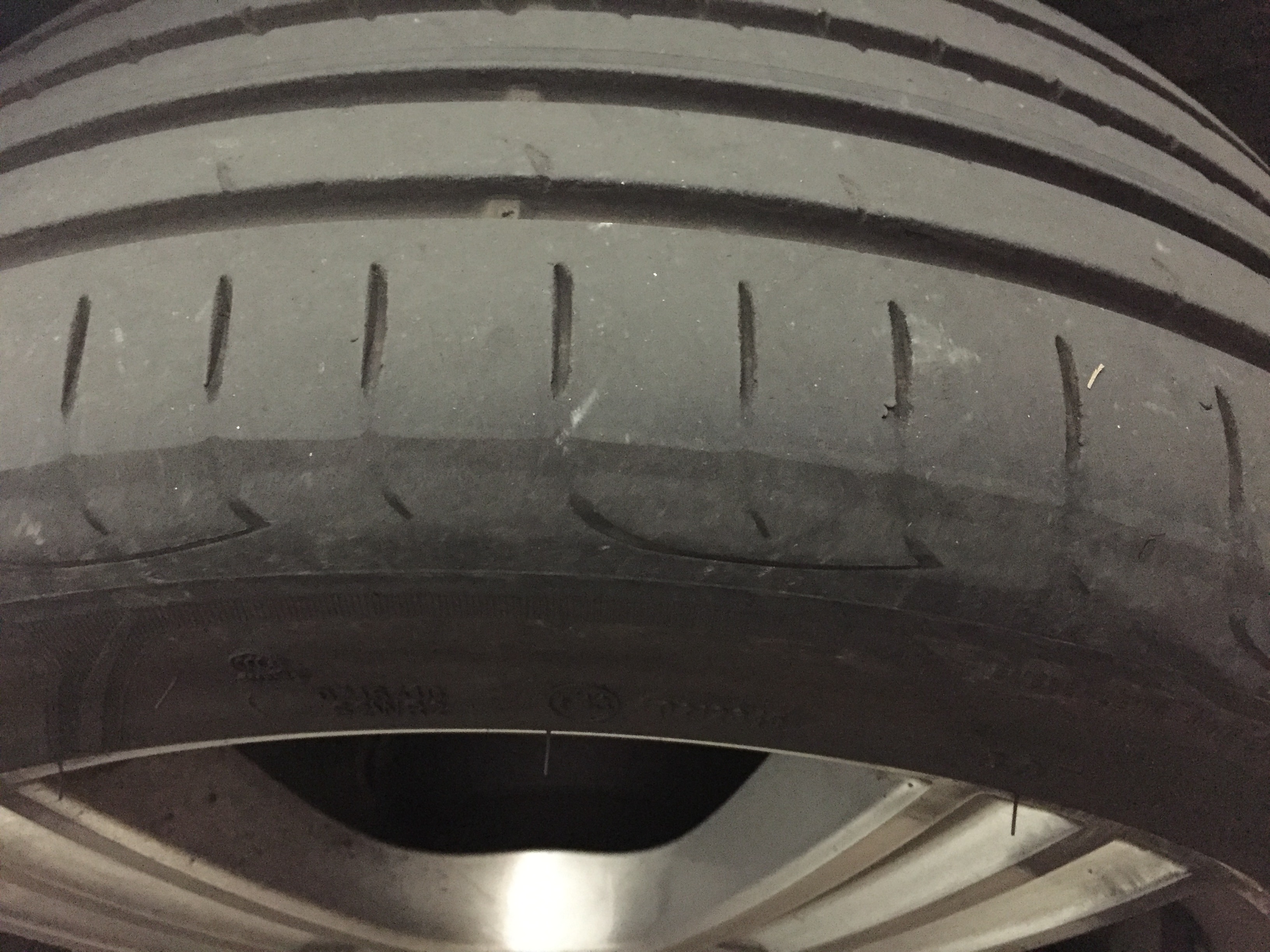

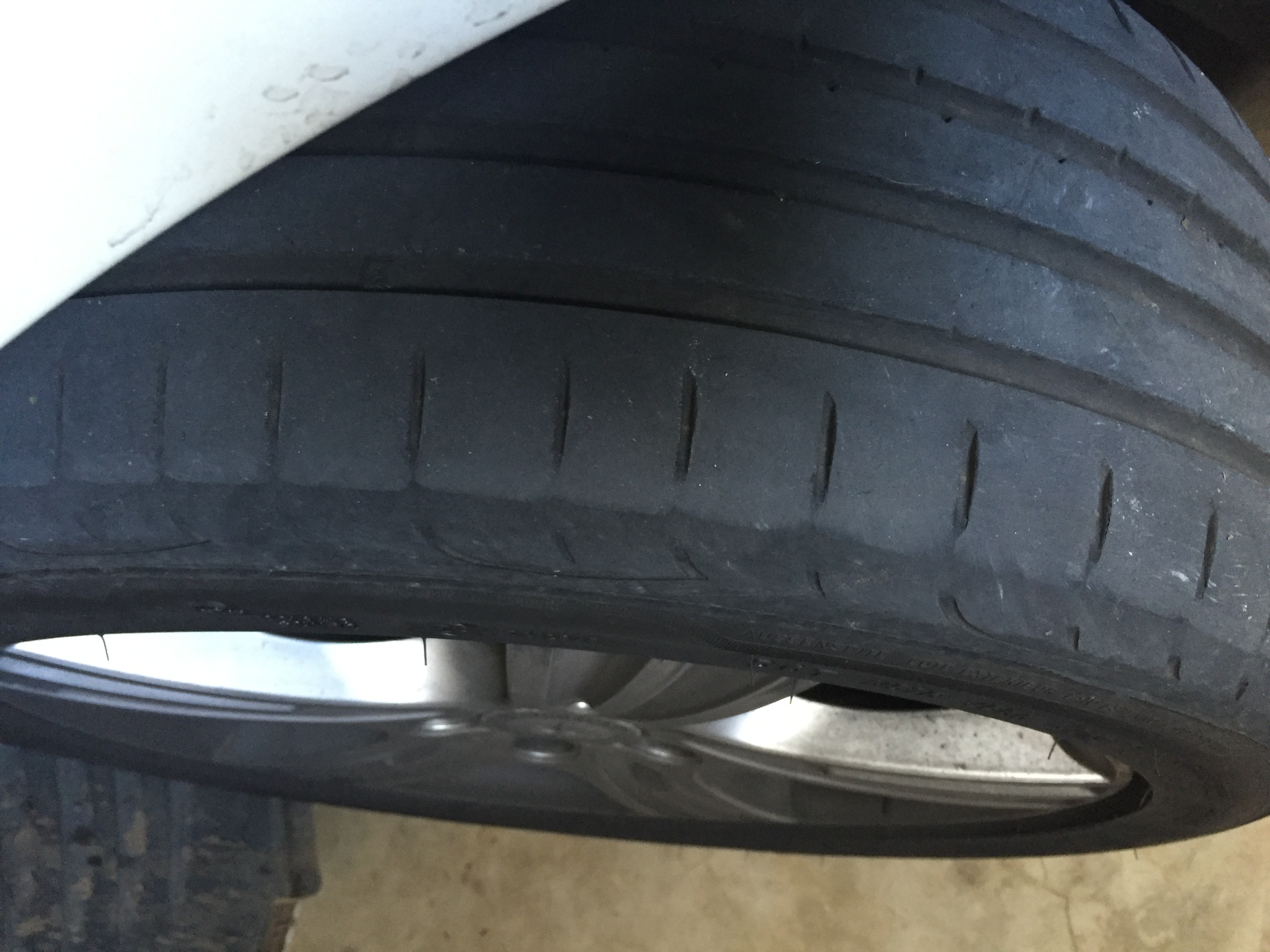

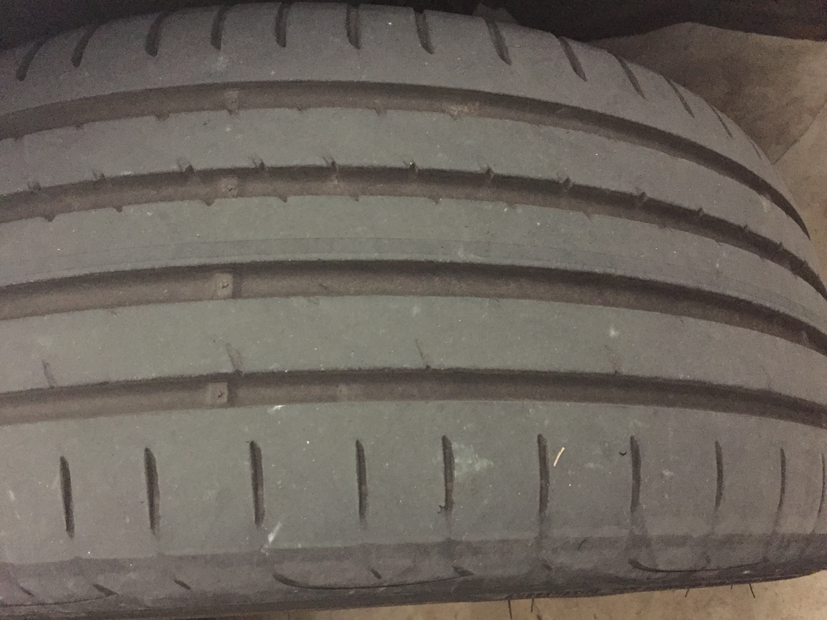

Thanks, I will check the rotors.
I am still convinced the tire wear is suspension related, I have noticed for the past few years a thud when braking downhill on uneven roads.
I have attached pics of the tire - its only a few months old.

The tire wear is most definitely suspension related.
Have you checked for bent rods/toe out/camber?
If your camber is off with stock suspension then something is bent.
Or at least that's how it is on the 4Matic models. Not sure about RWD.
