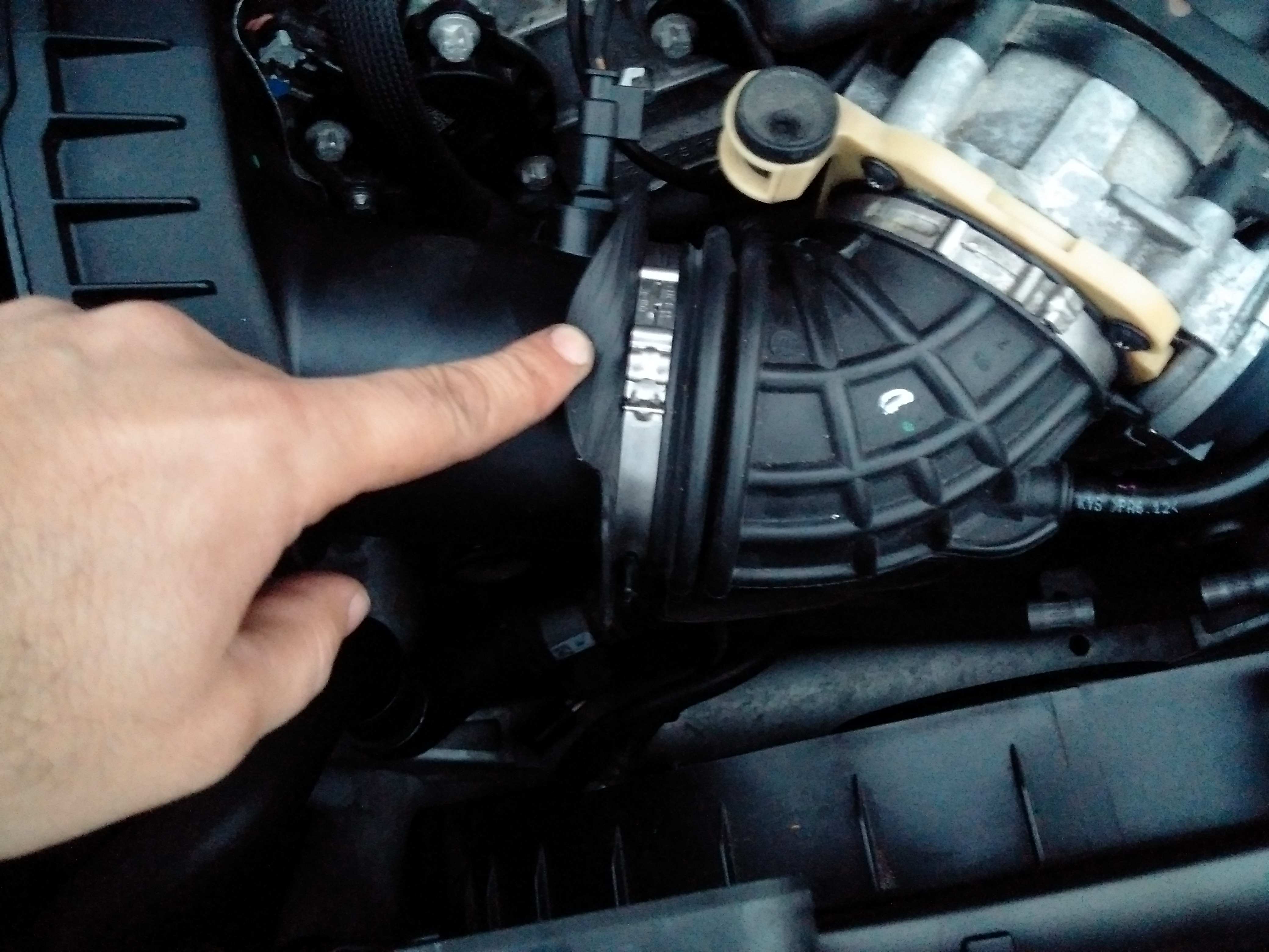

Here

If I were to guess it sounds like you need to double check that all the intake tubes are seated properly.

I got out and when I lift the hood I can hear hissing sounds. Investigation continues

It says 1 of 3, are there 2 more codes?

Problemo solved.
All three codes were saying the same.
Here is the story.
In an effort not to remove that one time use clip, see pics and as per instructions I lifted the air box upwards which as a result misaligned the plenum and the box was sitting slightly higher creating tiny gap where air was going through.
This time I removed the clip and aligned everything properly.
If I get new clip seems I need special tool to install it, I might buy just regular clamp.
Any suggestions?
Thank you for sticking with me on this one, it sure freaked me out and I was not looking forward to removing the plugs.
