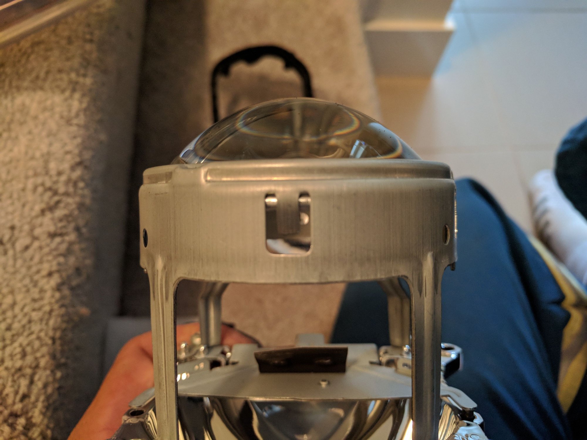

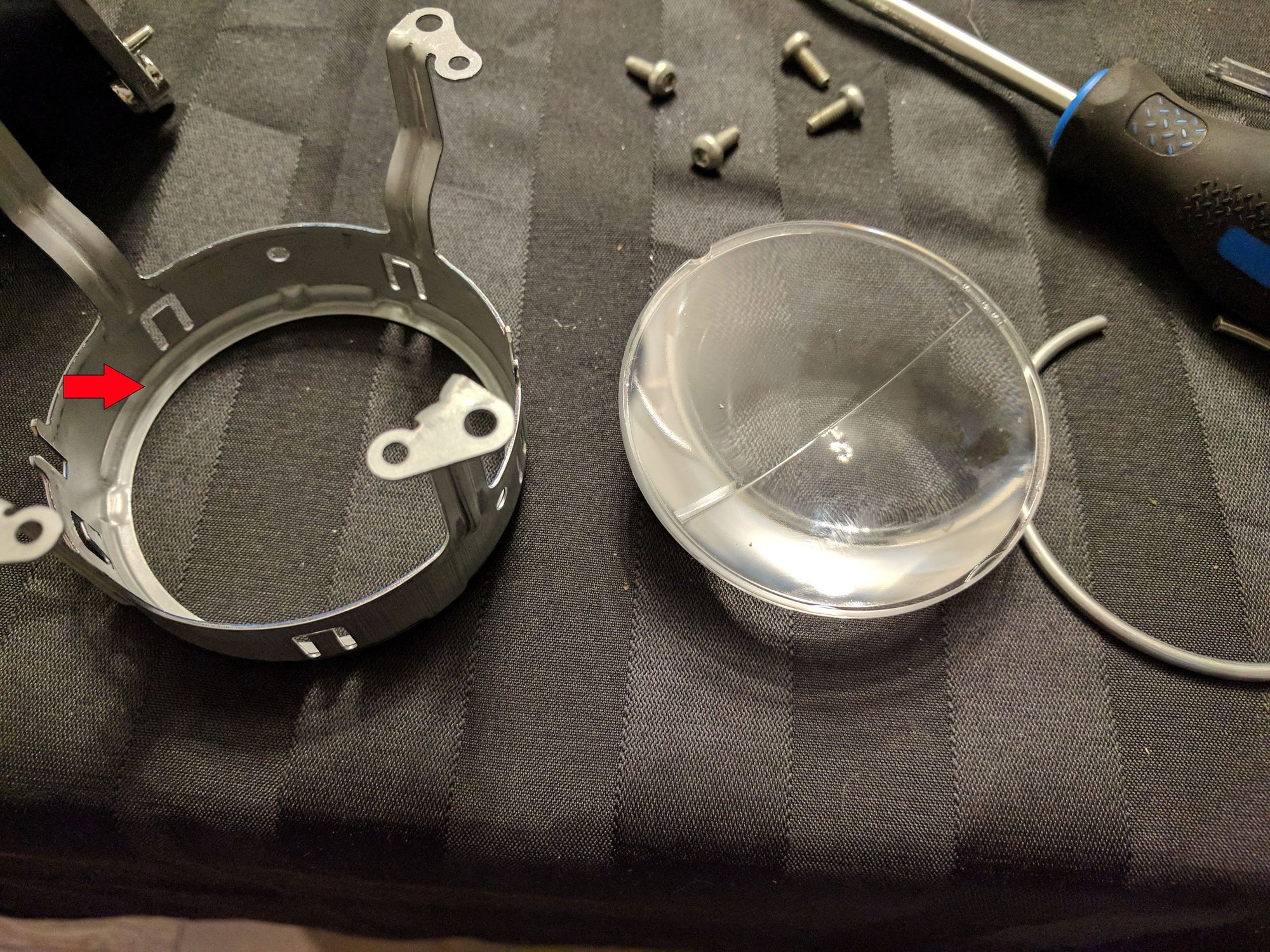

Sorry forgot to post pictures for everyone.
Headlights were easy to bake open, just throw it in the oven at 250 for 10 minutes, take off the metal clips and pry it open with a flathead screwdriver.
Haze inside the headlight came off right away with some isopropyl alcohol, only took 1 wipe and it was gone.
Morimoto lenses were a little bit bigger than the factory lenses. Had to take a hammer and a punch tool to the lens holder for it to seat properly.
Chrome pieces come out easily if you want to do black housing.
Red arrow pointing to where I had to open up with punch and hammer
Factory lens
Clear lens
Tabs holding lens in place
Haze cleaned with isopropyl
Pop out where red arrow is pointing
Squeeze to remove
Bent RV shield back
Black housing done
Before with haze
After

Sorry moved on to a E-class coupe and I didn't take before/after of the light output. Cut off was a lot sharper after bending the RV shield and changing the lens. Output was brighter probably because the haze was removed.

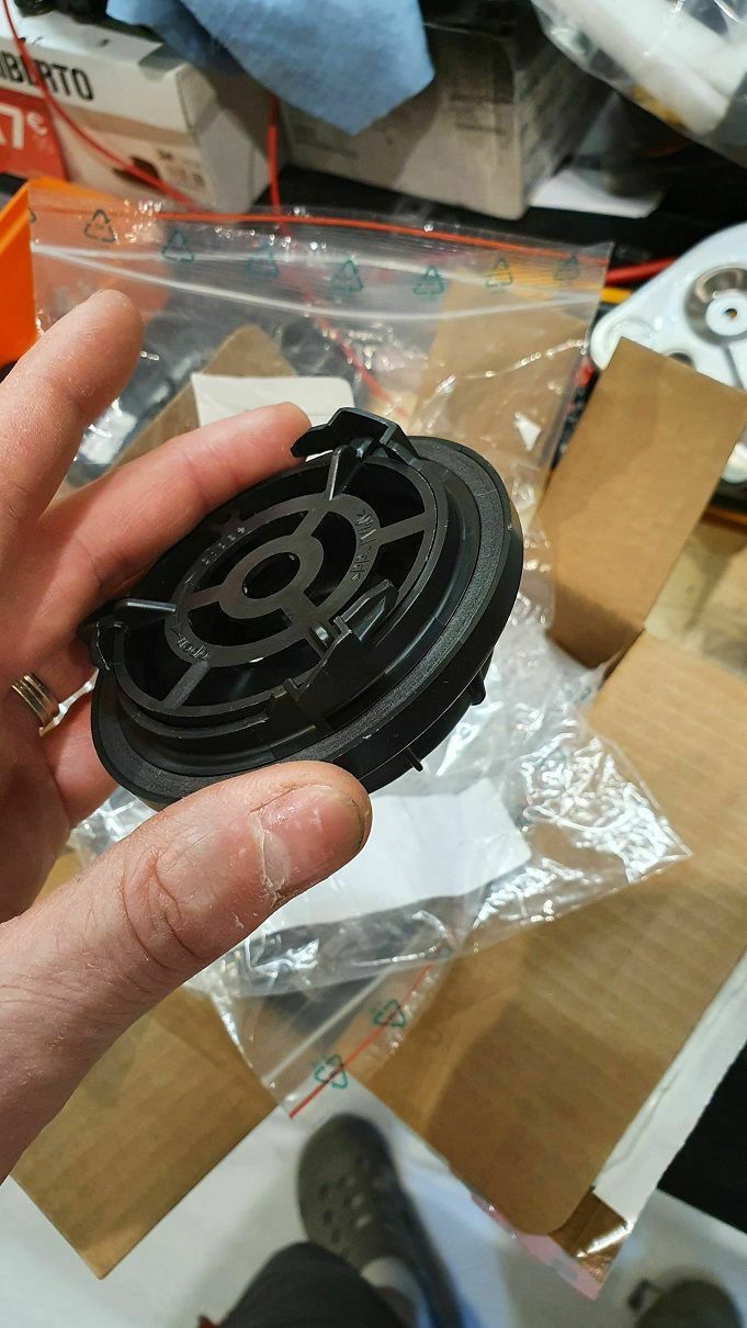

I've been looking into the haze part a little more.
Mercedes came out with a protective cowl.
Part: A0008260900
I'm no sure what to think of this.
