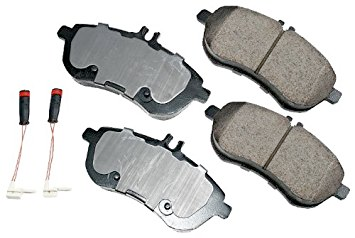

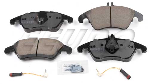

This is where I am confused. Some websites are saying I have 295mm and some say I have 325mm.
On top of that some say I have the front pads that look like this
And some say my front pads look like this.
Then there is the debate of people saying Akebonos and Zimmermans are crap for daily uses especially if you run the car at -30Celcius, and that also goes for Ceramic Brakes.
So what do people with experience recommend.
What pad style and rotors would my vehicle have, without actually lifting the car and looking and measure the parts.

The front pads and rotors in the Canadian C300 are for sure the same size as the front pads and rotors in the C350. The lower pads you posted look like the right ones with the hooked alignment tabs and the spring clips that go into the center of the piston.
Edit: To be clear the Canadian C300 Sport has the same size pads and rotors as the C350.
