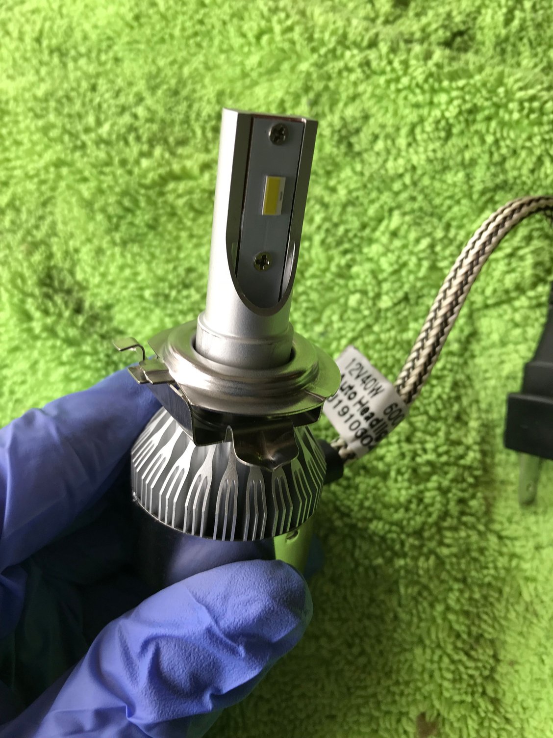

So I didnt find any on this forum installed an LED on their low beams. Here's what I bought:
LED H7 bulb LED H7 bulb
add code K6QRX9VY price drops to $29
Headlight Bulb Clips Holder Socket Adapter for Mercedes-Benz Headlight Bulb Clips Holder Socket Adapter for Mercedes-Benz
Use this site for reference on 2013 HID install
LED and socket/adapter
Remove the O ring from the LED
Insert socket/adapter
Reinstall the O ring
Make sure the plugs from LED matches + and - socket.
(+ positive) = 1 black wire, (- negative) = 2 black wires.
Started the car and no error code flashed on my screen, assuming I will not need one of these. Now my only question is will I need those error code eliminator, thoughts?
