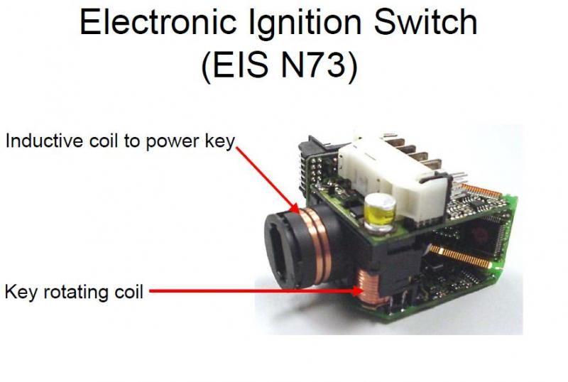

The ignition should only be able to be unlocked and turned by an authorized key. The key receives power from the ignition lock from an induction coil, it does not run off the battery in the key. The car will start even if the battery in the key is dead. i dont see how the key can be turned if the cars battery is disconnected but im not an expert.

When ESL is on its way out, I guess it needs more power to unlock (battery must have enough charge) and the sound is weakening. Install an emulator as my recommendation.
