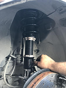

if your looking for height and dampening adjustability , you cant go wrong with a nice set of coilovers . Personally i will never run lowering springs on any of my cars.

Bc racing is all the way, im running em on my c350 for over a year now with no issues at all and car is slammed. Its a comfy ride better than stock.

Old Jan 27, 2019 | 10:25 AM
Cruel-Merc's Avatar
Joined: May 2014
Posts: 214
From: Lebanon
2009 C350
W204 C300 Suspension Upgrade-photo705.jpgW204 C300 Suspension Upgrade-photo19.jpgW204 C300 Suspension Upgrade-photo406.jpg
