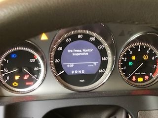

Like many of you with theses issues I scoured the internet/forums/U-tube and even under rocks for a solution. Unlike many of you with ESL issues…I think I have something different and here is why. The vehicle will lock and unlock with both keys as normal. When I open the door,(top pic), the left instrument cluster has the high beam light indicator illuminated and the right cluster has the fog lamps illuminated, orange/yellow on top and green just below it. When I insert the key the normal screen appears in the center. Upon turning the key, the ESL can be clearly heard…I also have a 2008 C300 and the sound is the same in comparison. Back to the 2010, as I continue to turn the key I get the full range of xmas tree lights including the warning indicator between the left and center instrument cluster (bottom pic). The center cluster begins to cycle through messages…airbag not functioning/tire pressure monitor not functioning/ESC inoperative… Other items of note, the headlights/tail lights will not turn. The radio, windows, locking and unlocking the car works fine but without the flashing lights indicating the car is being locked or unlocked. There is no clicking when turning the key all the way to the right for starting. Many of you may be thinking battery…my first thought as well…I purchased a new battery from Mercedes and checked it after it did not solve the issue…its putting out 12.36 volts. I swapped out the starter relay from the 2008 C300…all was the same as stated above. If there is another fuse I should check please be specific as to what fuse and its location…I’m at the point of towing to the dealership. I have also tried starting the car in neutral…nothing!

I had many of these same notifications on my 08 C300. I had to have the front SAM replaced. Good luck

I have seen symptoms such as yours related to the SAM as mentioned above but also poor or corroded canbus connections under the driver seat. Has the car ever had water in it from a clogged sunroof drain ?
Also a icarsoft i980 can be a great tool to assist in diagnosing problems and potentially saving you some serious money at the dealership.

Finally gave up and towed to the dealership...the long awaited verdict is in...SAM on driver side under the hood...$1400 repair....

Probably too late now but some on the Forum past have taken the torx screws holding the front drivers side SAM out and disconnected, cleaned with electronic contact cleaner those connectors that could be disconnected and sprayed the crud out of the bottom area..that SAM is right downstream from the cowl water drain just in front of it and if the drain tube is partially clogged or rainfall/car wash volume overwhelms it the excess goes right under the SAM over time leading to corrosion.
