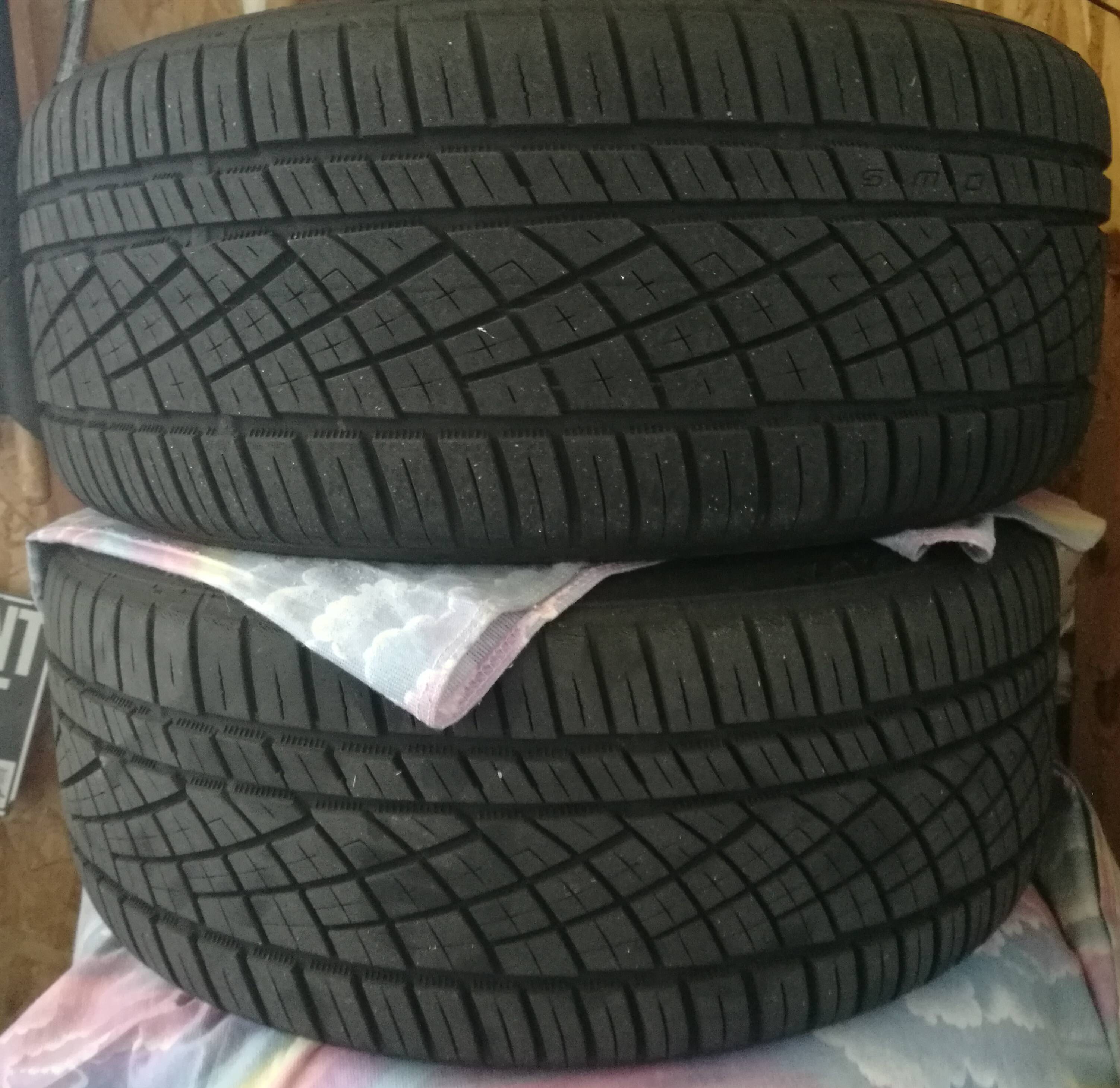

adi post a picture of your tire if you can, ill see if i can dig one up of mine.

Ok I'll try and get a picture tomorrow.

Top pic is front tires (fine)
Lower pic is rear tire (other is covered)
I know these aren't the exact pics you all were looking for but it's best I can do for now.

I follow the door jam. The gas door psi is a generic one. The sticker on the jam is specific to that cars OEM original wheel setup. Mine says 39F/42R on the jam. I then adjust the pressure based on preference/wear. Those tires will have a tendency to cup/chop easily, reason is the tread design on the outside is very blocky- better for cornering, not so nessesarily for wear. That’s why I had an issue with my snow tires which are high performance snow tires with a blocky design. Best thought is for you to experiment on the tire pressures. And make sure the rear suspension bushings are good.

Adi, what size rims are you running and what size was stock?
I noticed my rears starting to cup and it was because I was running too low of PSI. Always remember side wear is low psi and center wear is high psi 75% of the time.
I was running around 37-38 psi rear but I moved from 17 inch to 18 inch so door jam and gas cap area are wrong, I actually needed 43-45 psi to get better and more even wear. I ended up just getting a whole new set of DWS's and keeping my old ones for spares or if I burn through my rear michelins on my 63 too quick.
Just simply saying if you aren't running stock rim size and setup from stock then disregard placards on car for tire psi.
