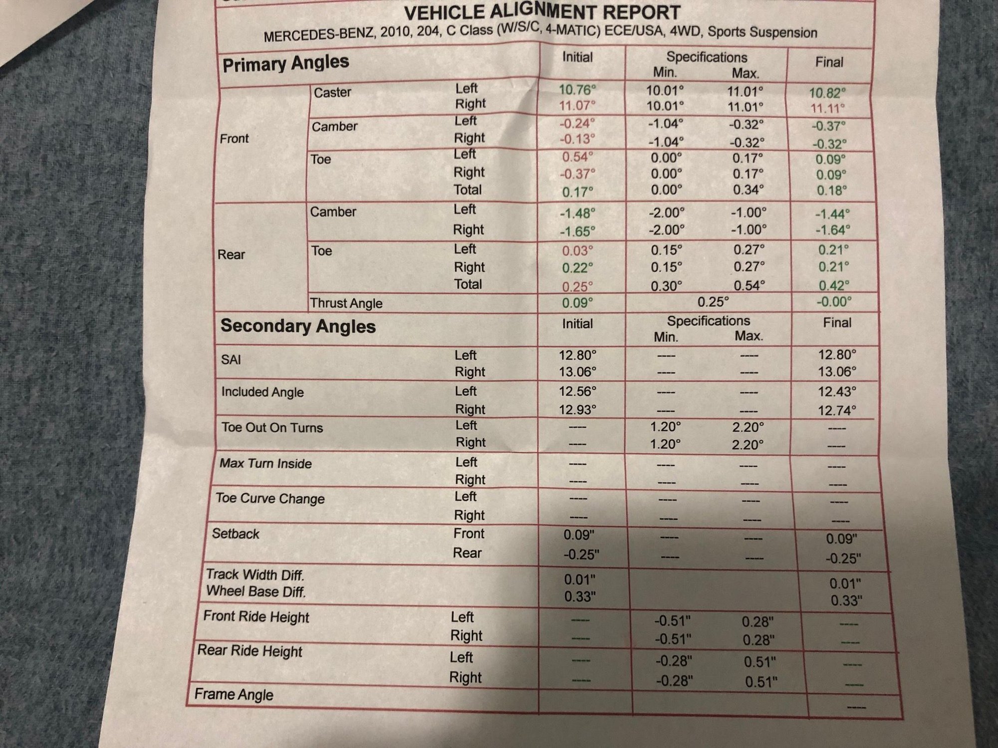

It’s not a “bait and switch”. Here is an actual alignment sheet from my last visit showing everything is adjustable. You need a 4 wheel alignment or you’re going to be out of spec.

The basic alignment was for 4 -wheel alignment.
Only the front right toe need adjustment according to the alignment sheet.
The special was for $99 down from $139. I love how the SA thinks I was going to pony up $299 from $99.
So after contacting the manager to let them know their SA tried to dupe me, it was no charge.
See attached for the readouts. They had it done in 1 hour and 30 min.

As for the creaking, when I did my suspension the sway bar end links were a little loose at the top.
Try tightening them and go for a drive while hitting some bumps, hopefully the creaking is gone.
If not, I’m sure if you get some lithium grease and spray/apply to the sway bar bushings, you’ll be able to see if the sound is still there or not after another test drive.
Makes sense, do new shocks and struts require a break in period?
