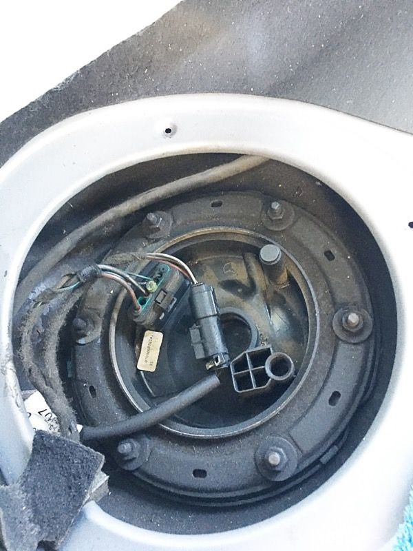

You probably don't need a new fuel pump. It's most likely just a crack in the cover. I just replaced the one on the kid's car last week: The dark area in the creases pointed to by the arrow below are actually cracks. Replace the cover and the gasket and I'll bet that fixes it.

No problems with fuel economy, but it would throw an evap error for a minor leak, and smell like fuel when filled over half a tank. I've encountered about a dozen of these cracked liked this. Unlike some other models, this one is just a simple cover that's easily replaced. The cover and seal retail for abut $150, On but you can get them for under $100 from a dealer with an online discount store (like mbpartsdelivered.com). I've worked on some W203, W209 and W211 models where it's actually part of the fuel sender housing itself so that whole unit has to be replaced. And then the plastic nipples on the fuel pump where the sender unit hoses connect usually crack so you end up with spending $500 in parts replacing everything in he fuel tank on those.

This is really easy and you won't need any special tools. The less fuel in the tank the better - 1/4 or less. Remove the rear seat cushion. Pull up firmly on the front edge of it to snap it out of its clips. then you have to push it backward toward the trunk and and then lift the rear edge to unhook it. With that out the way, you'll see the round access panel. I can't recall if it uses hex bolts of Philps head screws. Remove that and you see the white cover. Note its orientation. Remove the electrical connector and the bolts (or screws) the cover in place. Remove it and also the electrical connector from the underside. The seal has no top/bottom - it's fine either way.

You only need the tank seal if you are just replacing the cover. The other seal would only be disturbed if you removed the fuel pump, which is not necessary just to replace the cracked cover.

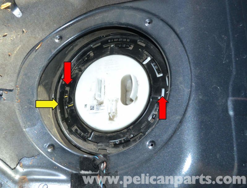

A little confused. What did you use to remove the locking ring (black in photo)?

A gentle but firmly planted tap-tap in a CC fashion with an appropriate slot head screwdriver and light hammer should do the trick.

Ah, yes, you have the "California Emissions" version. AS Gammas stated, us a screwdriver or other suitable tool in one of the slots and tap it tangentially.

Had a mobile mechanic come out just in case something should go wrong.
There was no lock ring that required a special tool. Just bolts.
We took out the cover which was black.
He cleaned it but could not see any signs of cracks.
Seal showed no signs of cracks either. Reseated the seal.
