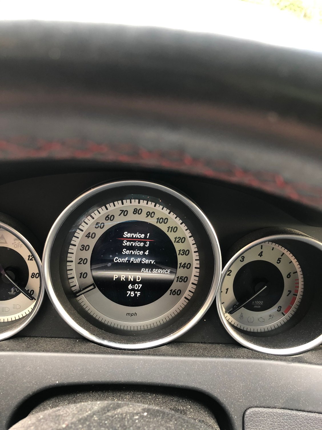

I’m wondering something. I just did my 80k service and it told me to do spark plugs, I did them at 60k. Why is it telling me to do it again after only 20k? Service manual says nothing about needing to do that at 80k. Thanks

Old Jun 1, 2020 | 04:23 PM

unfortunately I cleared the service reminder. If B3 is the 60k mark that’s confusing as I cleared every service and I’m sure the dealer did the same when they did the maintenance. This seems really weird.
actually, a while back the dealer did a Ecu update, do you guys think maybe that’s it?

Yes, it said service 12. I recorded all of them on a note pad. I guess that maybe the spark plugs were not counted as being done somehow then.

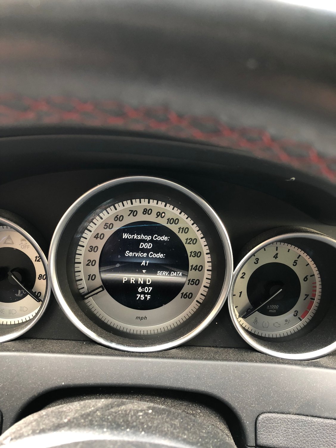

Here’s the next service info. Does this make sense?
Hi Just 204,
That looks correct as it matches the chart in post #1
A/B 1 = A service, Oil Change, Brake Fluid Change
