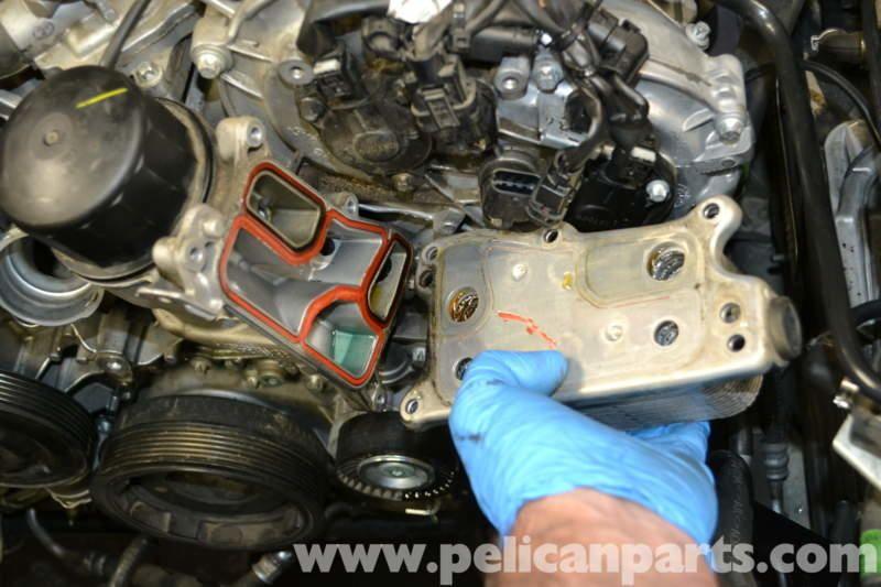

Check out this link...pretty close to your model. Talking about oil cooler/housing leaks and doing a Search with this as the subject will pick up quite a few posts. These gaskets can wear out/leak at even lower mileages per other posts. Your serpentine belt looks like it might benefit from a change anyway as you already noted...miles? In general they are pretty resistant to hydrocarbons. It might be your southern Cali temps are playing a role in things deteriorating a bit. You've got a nice DIY project if you have the time and can spare your MB being down some.
https://mbworld.org/forums/e-class-w...oler-seal.html
I always like to clean off oil leaks and run her to confirm location of leakage myself. Looks like problem is with oil cooler/ housing not just the filter screw on area as you probably already think so 'tightening" won't help.

https://www.pelicanparts.com/techarticles/Mercedes-W204/20-ENGINE-Oil_Cooler_and_Seal_Replacement/20-ENGINE-Oil_Cooler_and_Seal_Replacement.htm
Additional info Suggested:
Coolant:
https://www.pelicanparts.com/techart...eplacement.htm
+Power steering reservoir

Two Gaskets Clarification
So evidently there are two gaskets on this.
1. Oil Filter Housing
2. Oil Cooler Seal
Regardless of which one, I guess it makes sense to do them all. I suppose the other one won't be far behind...

I would be trying Permatex Aviation form-a-gasket sealant on those mating surfaces.

Yes, but only on the oil cooler seal area on my '09 C300. I have used this gasket sealer on many other difficult to fix leaks where OEM gaskets were no longer available, i.e. vintage Brit/Japanese motorcycles, Mg's/Lotus cars from the 60's. I see that Pelican sells these gaskets however. I thought your post suggested they weren't available, my bad.

They are still available. It's not clear if Mercedes is phasing it out. Another thread although W203 recommends Yamabond 5 over Permatex.
I also have to replace the breather cap. So I'm thinking of using a light sealant for that.

I think Installing new gasket only would be the safe bet, in this case I don't see the benefit of installing sealant on new rubber gaskets.
If the housing is warped or corroded at the gasket surfaces then replacement would be recommended otherwise don’t let the "experts" waste your money.
