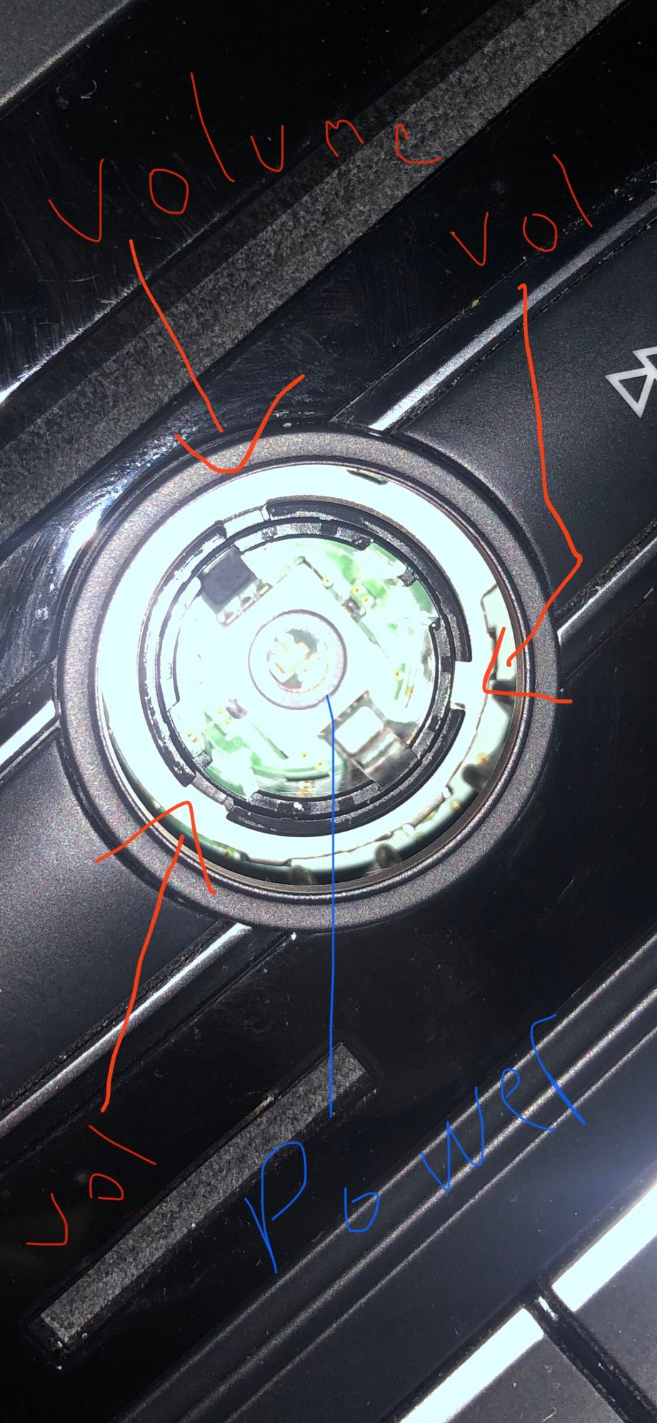

if anyone is interested in looking at the mechanism just gently wiggle and at the same time pull off the volume knob, this will pull off along with the power button. To put it back line it up and gently click back into place.
I looked at this slightly more closely today. I don’t know how it works... it seems the volume knob has 3 slots that it fits into and turns a ring that spins around in a housing.
Here is a pic. The square / circle thing in the middle is only the power button and has nothing to do with the volume. It doesn’t even move....
you can see I pointed out the 3 slots the volume knob connects to that spins that ring around which seems to sit in another circular housing
I don’t understand how it works. It also appears to have some sort of grease on it to help it move.....
Volume knob removed
Old Dec 27, 2019 | 08:34 PM

Old Dec 27, 2019 | 08:49 PM

the knob is physically clicking when you turn the knob, some contact is dirty somewhere and I don’t think WD40 going to solve anything if anything may actually damage the electronic parts + plastic.
need to be careful as any wrong move will result in the entire Command unit needing to be replaced.

Old Dec 27, 2019 | 10:35 PM
th1ef's Avatar
Joined: Dec 2016
Posts: 188
Likes: 25
Car
Found this from an e class thread on the same issue, I think this is what we are dealing with, I don’t think anything should be sprayed in there:
The "Volume" knob is not a traditional potentiometer "volume control." The control in these systems is an optical encoder, a digital device. As such, it is not likely to be even remotely user-serviceable. Yes, there may be some fixes out there (similar to those for the Comand knob on the console), but this is not an old-fashioned wire-based component. It is a device with a precision control with a lot of attendant electronics to make it work.
My guess is that Maybe you can get that part of the Comand system and switch it out, but otherwise this will be a costly one to fix.

Originally Posted by aaronBLUEeyes
Might be a good Junkyard opportunity to fix, you said we can pull the volume knob straight off, rather than replacing entire radio unit — maybe hit local junk yard and grab 1 or 2 volume knobs and see if one works correctly after purchasing it from junkyard.
It’s not the knob itself. It’s the actual radio. The knob is perfectly fine.
