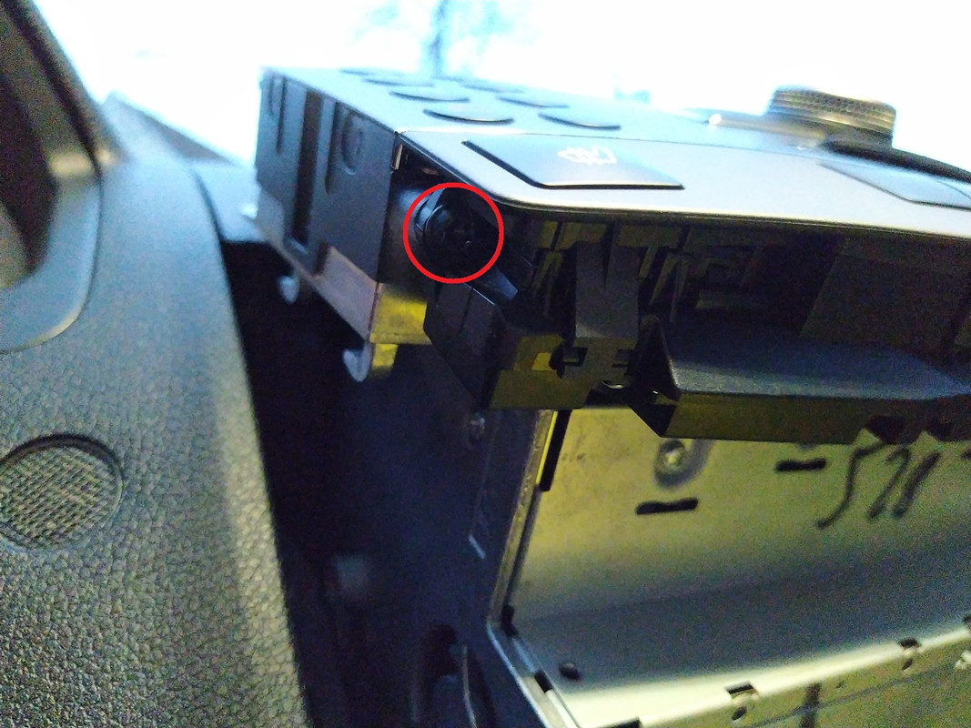

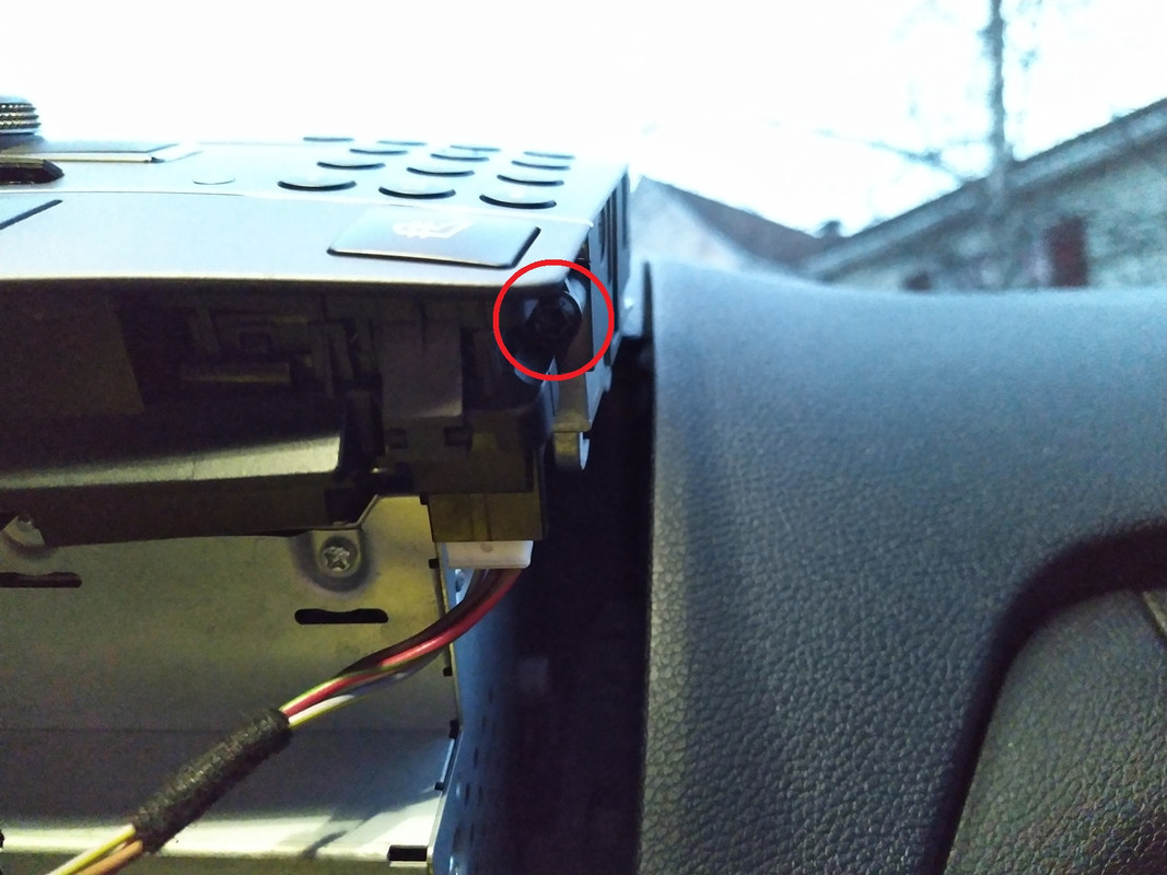

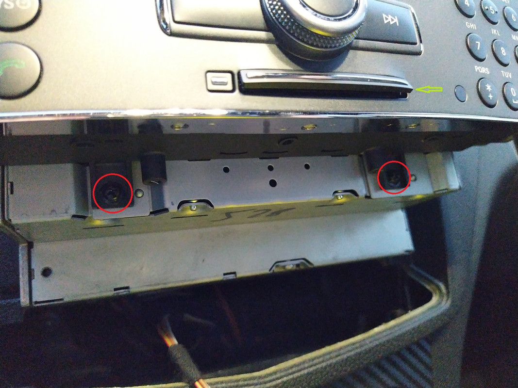

Step 1: Remove the head unit by following these instructions: https://www.pelicanparts.com/techart...eo_Removal.htm

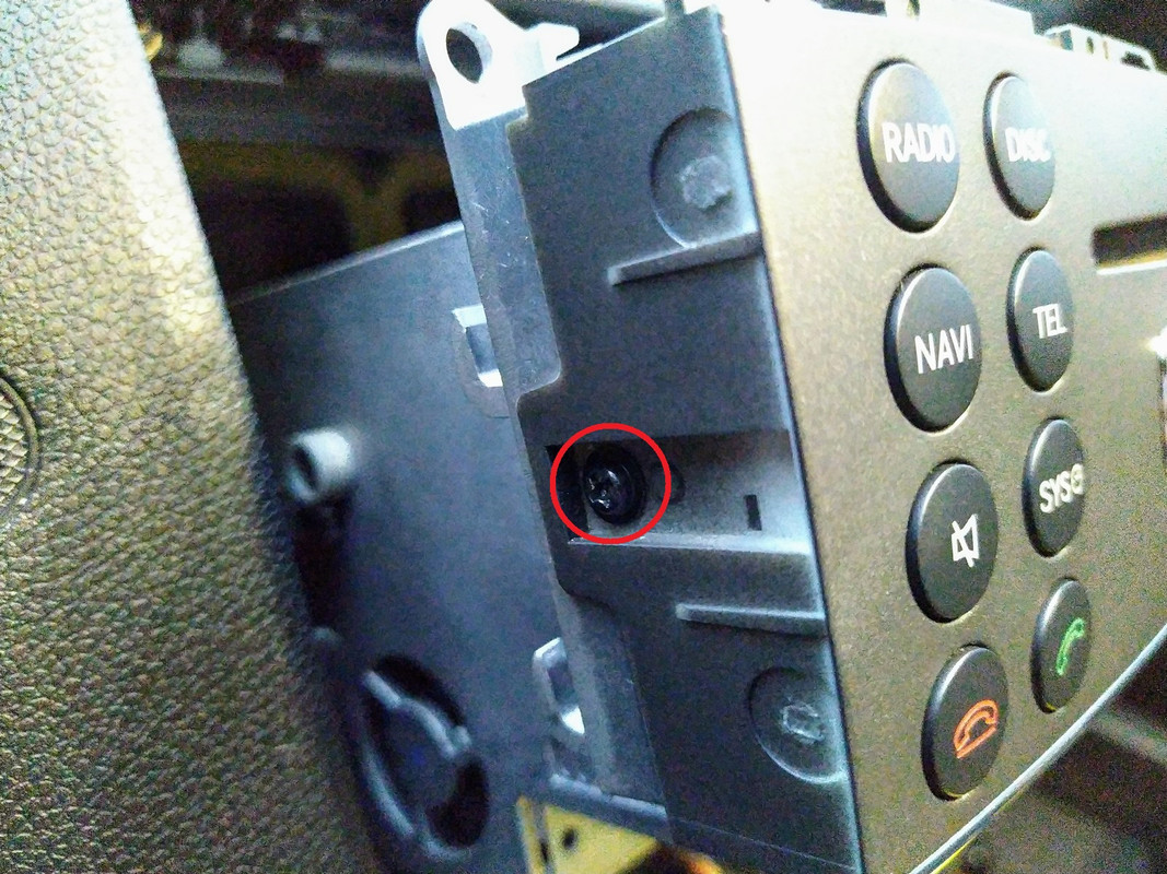

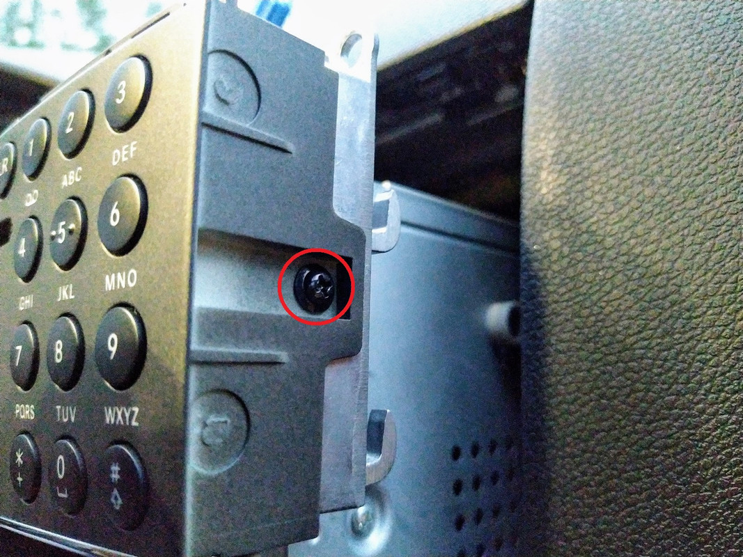

Step 2: Remove the lower switch bank by removing the four T15 screws securing it to the head unit.

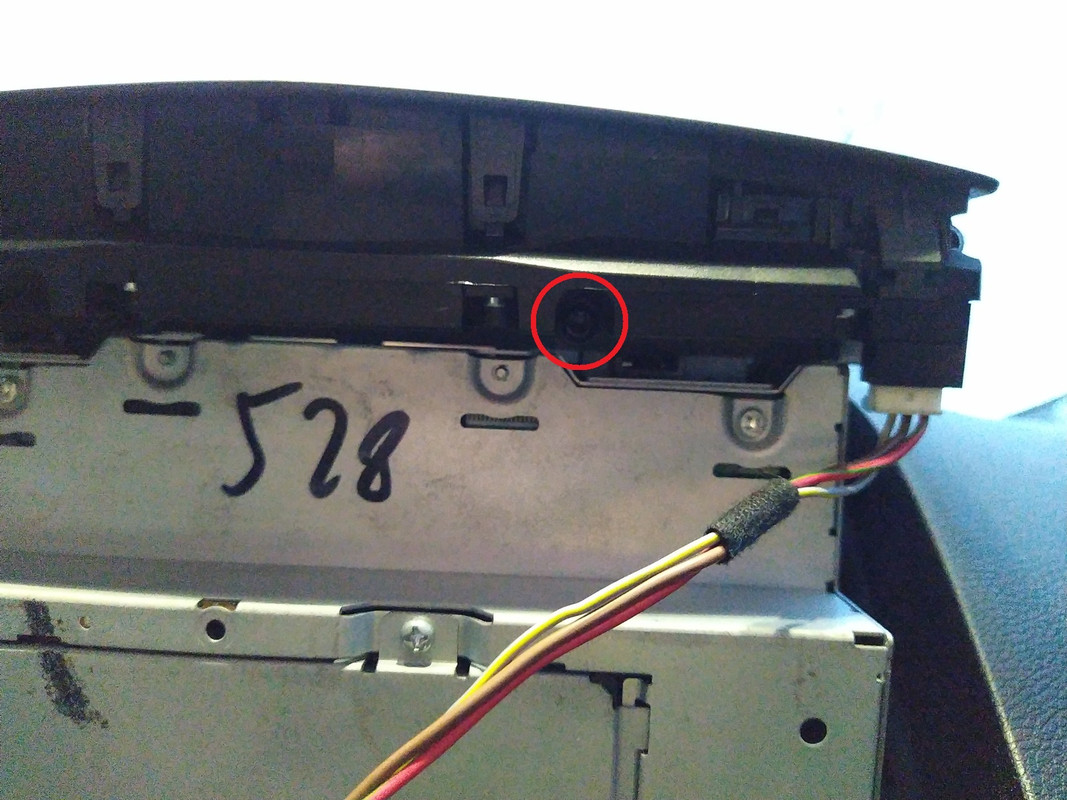

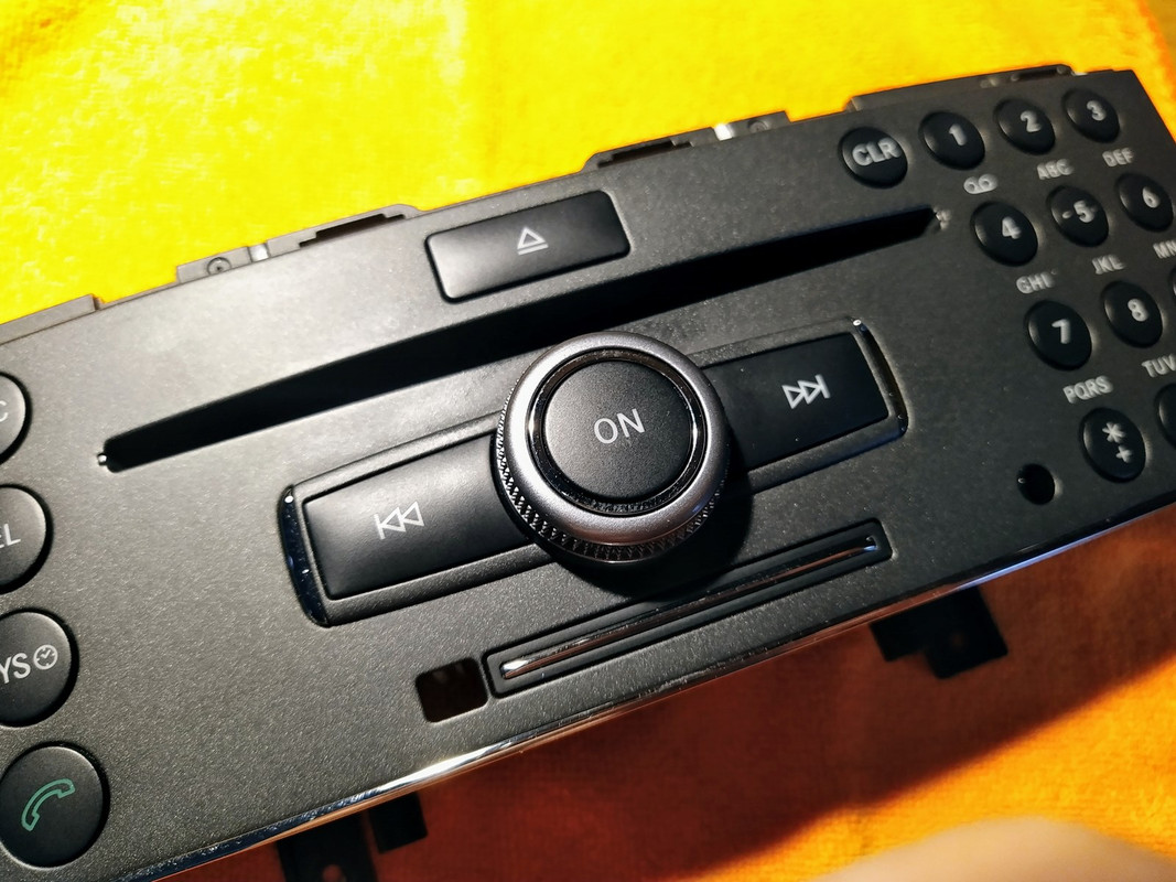

Step 3: Remove the face plate from the head unit by removing the four PH2 screws holding it on.
Step 4: Remove the volume knob by simply pulling on it.

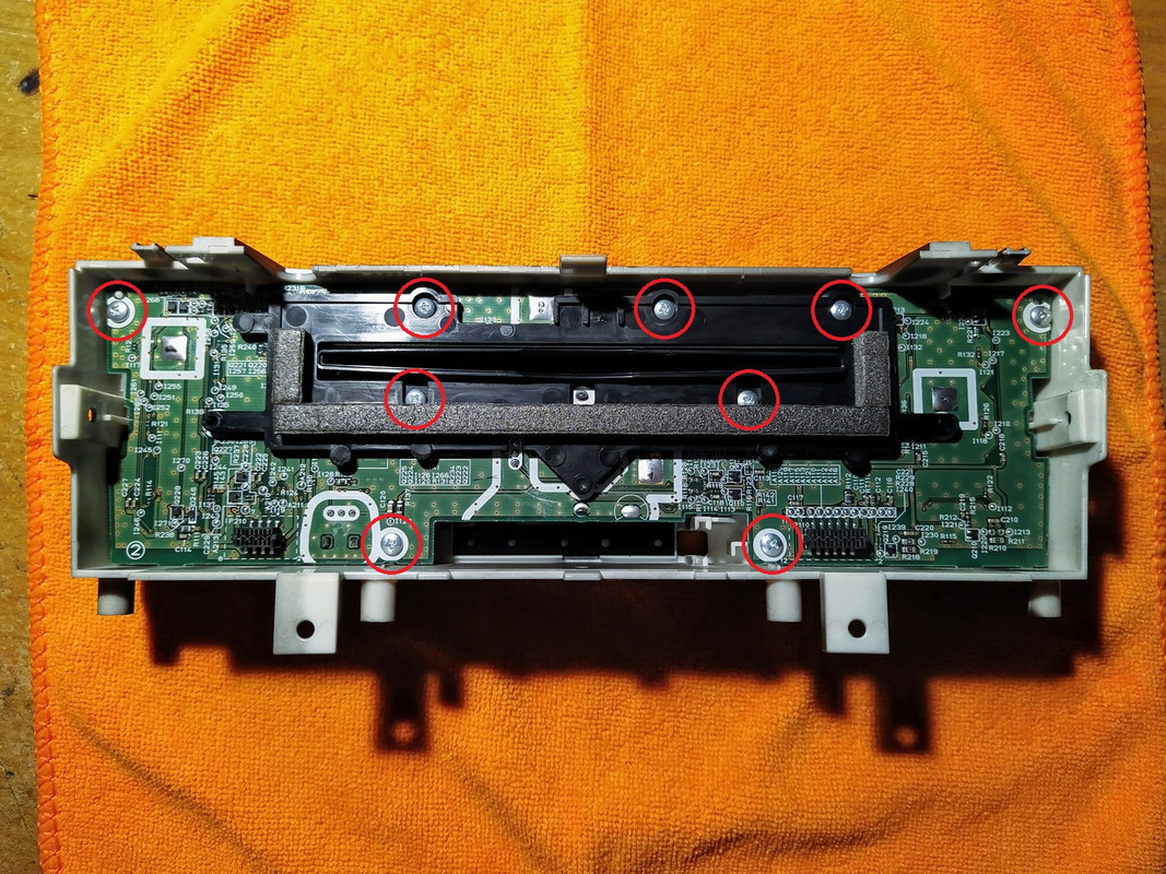

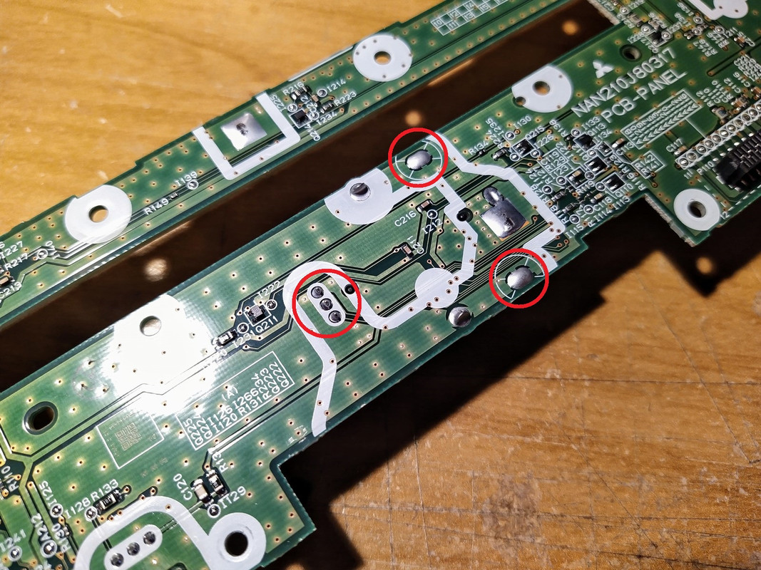

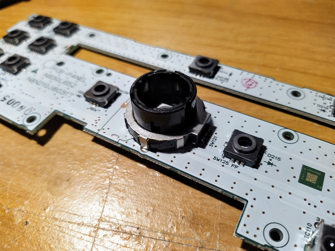

Step 5: Remove the circuit board from the face plate by removing the nine PH1 screws holding it on.

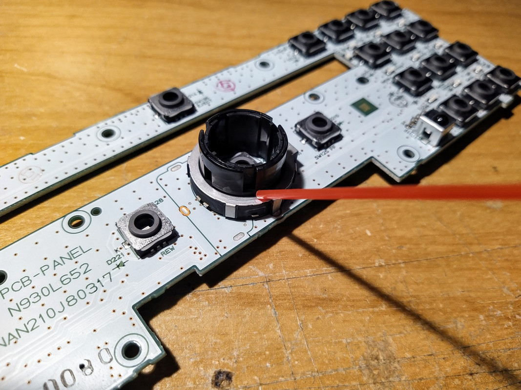

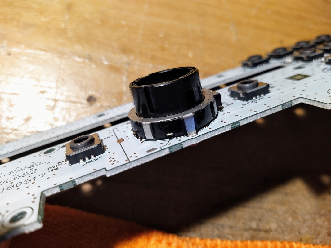

Step 6: Spray contact cleaner liberally into the dial in between the outer plastic drum and metal bracket. Occasionally spin the dial back and forth and completely around then spray again. Do this multiple times. Do this outside or over a towel to catch run off. Do this in a well ventilated area. The idea is to dissolve the grime and wash it OUT of the dial so do not be stingy with the contact cleaner.
NOTE: Opening the actual dial is tricky and not recommended. The metal bracket is pressed around the switch holding it together. But first the dial has to be desoldered from the circuit board. There are two points where the bracket is soldered and three points where the electrical leads of the dial are soldered. Once these are undone the switch will come off. The bracket will have to be pried away from the dial before the dial can be opened. This will most likely destroy the dial or make it difficult to put back together. Since this is a custom made component a replacement will not be easy, if not impossible, to come by.
