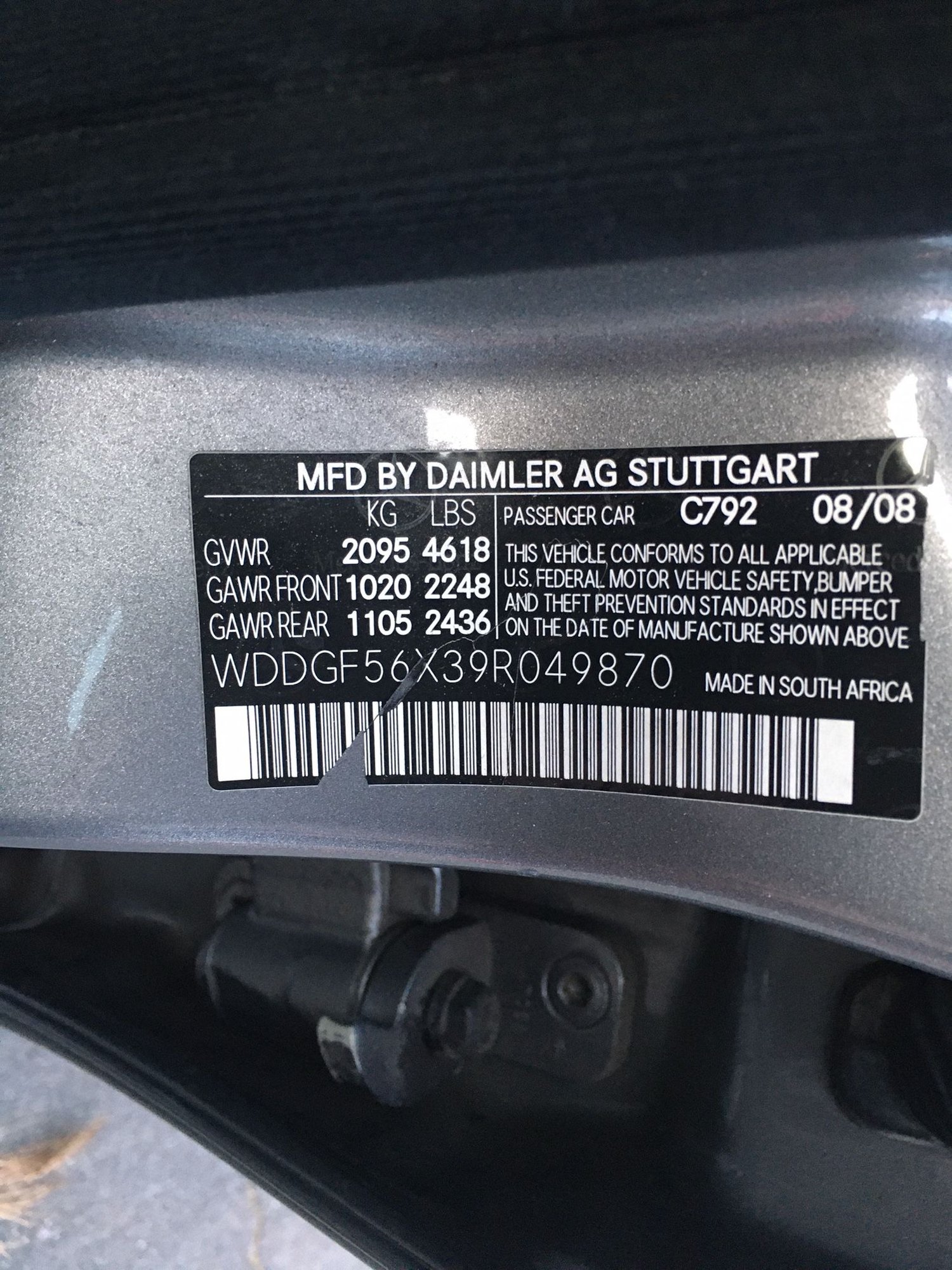

1. Here's the sticker from inside the door.
So this is wild. I go online and VINDECODERZ says 12.08.08 for Manufacture date.
https://www.vindecoderz.com/EN/check...GF56X39R049870
2. I went online to Bosch and used the VIN. Nothing came up as compatible. So I called.

You car is outside the range listed on the box that I have since it was made in August 2008 (08/08) while the range on the box starts with December 2008 (12/08). There must have been a change in the arms and blades in December 2008 and hence why your car is not in the Bosch's range.
