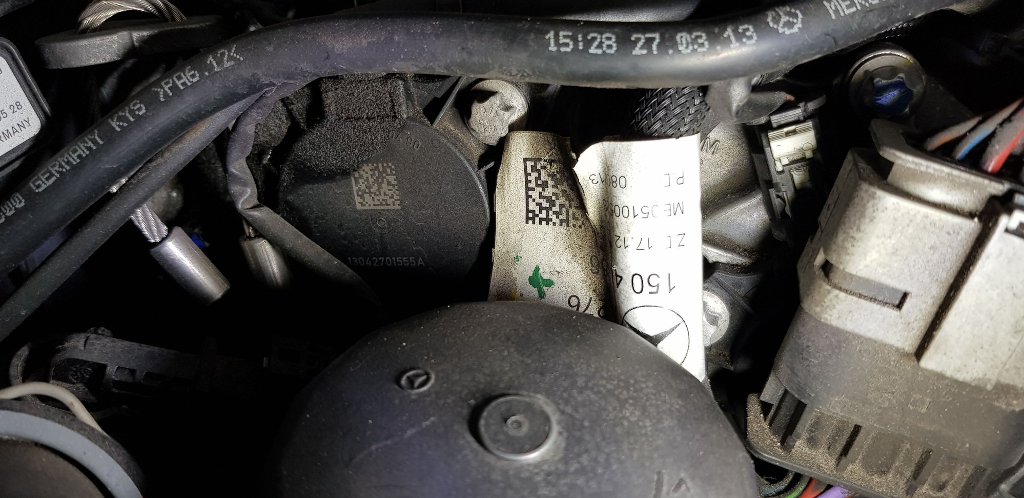

I popped the hood today and checked around for leaks. I'm not going to lie, I can't tell the various engine components apart, but I think I found the leak the dealer quoted for...
There was oil around the red highlighted component below (only on drivers side, passenger side had some around the cap but I think that was just spillage)
Closer photo: I think the leak is originating the part circled in red below and seeping down:
Even Closer Photo: I think this is where the oil is accumulating from the leak on the top part, or maybe this is another leak:
I didn't take any pictures of the passenger side component, but there didn't seem to be any leaks on that side apart from around the oil cap, which I am assuming is spillage.
It will be a while before I can take to an independent shop to get looked at - should I be worried about driving it in the meanwhile?
Also, can someone PLEASE educate me about what this leak is so I don't sound like a complete idiot when I'm talking to the indy shop? Any and all comments welcome.

looks like a cylinder head valve cover I think...

Or maybe it's the cylinder head gasket... I cannot tell.

Thanks for that - do both have to be resealed? From what I can tell (pictures above) the leak is only on one side... Also, is $1,100 too much for this job?

I quite sure it’s the valve cover leaking. Cylinder head would not give a leak up there. You do not need to do both sides. I’m sure you can go to a specialist and get it done for less. IMO I don’t think it’s too bad, when mine was leaking (drvr side) oil literally was slowly dripping down the front to the P/S pump onto the undercover. If it’s just some seepage don’t worry too much and look for a quality shop you’re comfortable with having fix it. Don’t rush, It looks like you have time, too many hacks out there that do poor work and break things.
