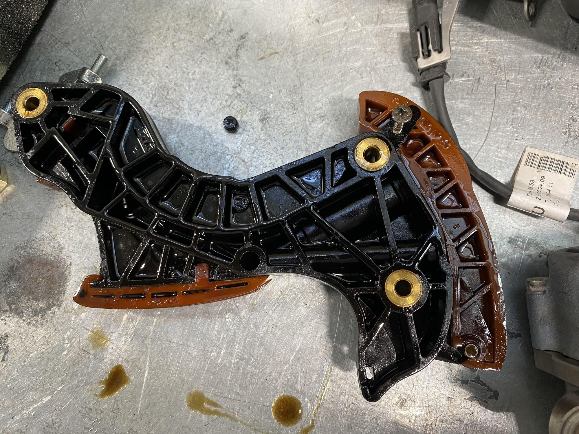

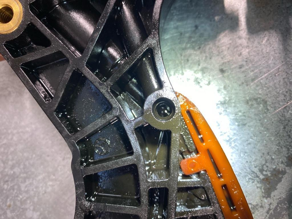

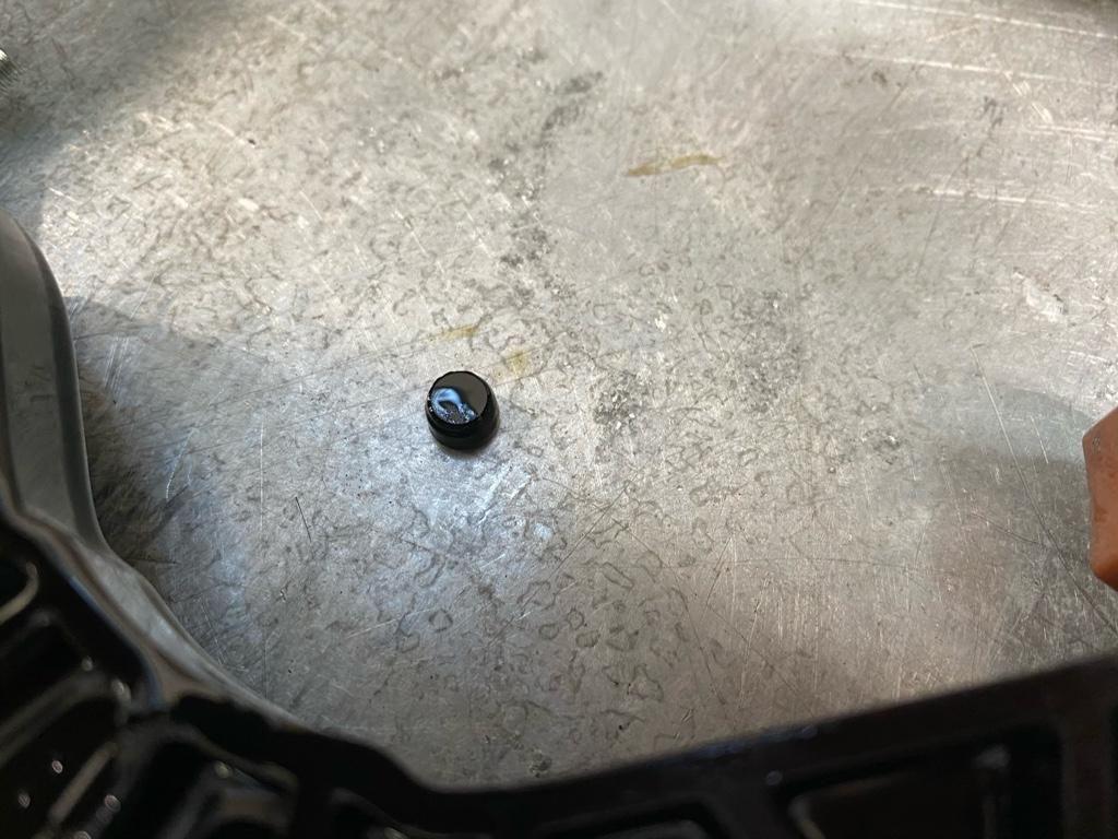

We had a 2013 Mercedes C250 with the M271 engine towed in to the shop with broken timing chain. After replacement of timing chain, both cam gears, tensioner and all the bent valves in the cylinder head, replaced the balance shaft tensioner also ( had the plug that was mentioned blown out as well).
After all that work upon test drive the engine was rattling like the the original posters video. After checking oil pressure the oil pressure was at or above Mercedes specification in every RPM range with the oil filter cap pressure tested adapter. After close inspection of the original oil filter cap that was on the vehicle I noticed the bottom part towards the middle above the 2 lower o-rings was broken see photo below of the cap. Because of the broken part the lower part of the oil filter cup where the 2 o rings sit never seal oil pressure inside the engine and cause a oil pressure loss. With any oil pressure loss the exhaust camshaft adjuster will make rattling noise and the loudest point is in the back of the engine at the brake vacuum pump. If any of you guys have this issue with rattling MAKE SURE TO CHECK YOUR OIL FILTER CAP VERY CLOSELY AND REPLACE IF ANY MOVEMENT AT THE BOTTOM OF THE FILTER CUP O-RINGS.
This is where it breaks and causing a loss of oil pressure
This is how it is supposed to look like when NOT broken

Thanks for the suggestion - howd your timing chain break?
Old Feb 7, 2024 | 12:03 PM
  #83
ManfredsAuto's Avatar
Joined: Feb 2024
GL320, G55AMG, C250
I do not know why the chain broke but I would suspect because of low oil pressure. The chain tensioners are oil fed and same as the cam adjusters. If they do not have enough oil then the chain will slap inside the engine and eventually break.

Hi everyone! I have a Mecedes E250 CGI M271 EVO with exactly the same symptoms as mentioned in this thread. This rattling sound occurs only when the engine is hot and not when it is cold. And exactly as mentioned above this rattling sound is happening when i let my foot of the gas and the car decelerates. Also if i start the car when engine is cold and i let the car stay idling for 20 minutes and then drive away it also rattling at low rpm.
A few weeks ago I was at the workshop and changed the chain, chain tensioner and camshaft gear adjusters but I still have the same symptoms. I have now booked a new appointment with my workshop to replace this tensioner that is connected to the lanchester.
I have some questions. The worskhop have never done this work before so i wonder if anyone can give me some advice so i can forward it to my workshop. What is the best/simplest way to do this repair? Do the worskhop have to remove the entire engine from the car to be able to do this repair?

There are two different methods for installing this tensioner. The first is to remove the entire engine, and the second is, as I mentioned in my previous messages, to support the engine from above. In order to remove the oil pan, the lower crossmember has to be taken down, which is why the engine must be suspended from above. Of course, since this process is a bit more troublesome and the mechanic’s working space is limited, removing the engine entirely is usually easier for them.
The important point here is the timing adjustment of the Lanchester. There are direction marks on the gears of the Lanchester, and I will add a photo of that. Also, when you remove the front engine cover, you may use a very small amount of liquid gasket when reassembling it. According to the standard assembly documentation, the front cover should be installed first and then the cylinder head. However, since we will not be removing the cylinder head, the front cover will be taken out by sliding it away. When reinstalling, a liquid gasket may be needed. I can also add a photo regarding this if you’d like, so it will be clearer what I mean.

Hi Chipset! Thank you very much for your help. Yes, I would love to get some more information about what i have to think about regarding the marks on the gears of the Lanchester and the timing adjustment.
Yes, it would be very helpful if you could send pictures of the marks on the Lanchester gears and also if you have any image of the front cover with the liquid gasket.
For me it is hard to understand why they even made these two plugs on the tensioner. Then also when one plug comes loose that it can be so sensitive that the oil pressure will be lower just because of that. Have you received any information about this when you have been in contact with Iwis?
