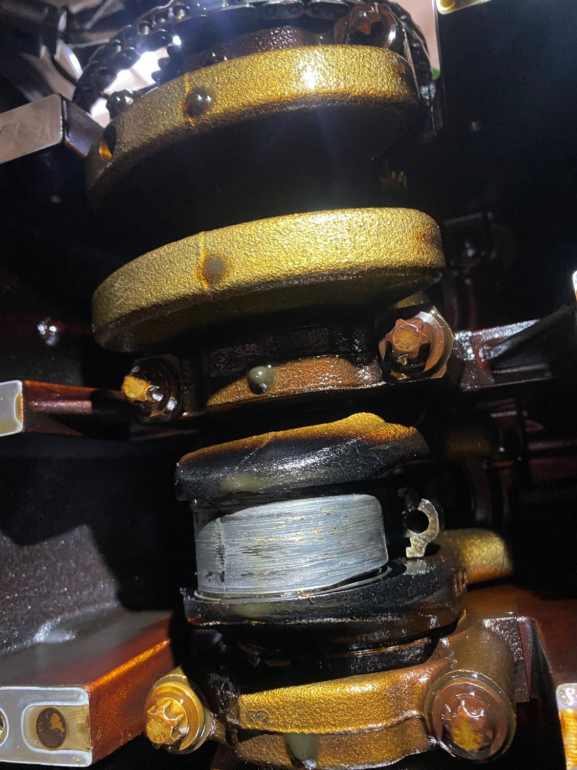

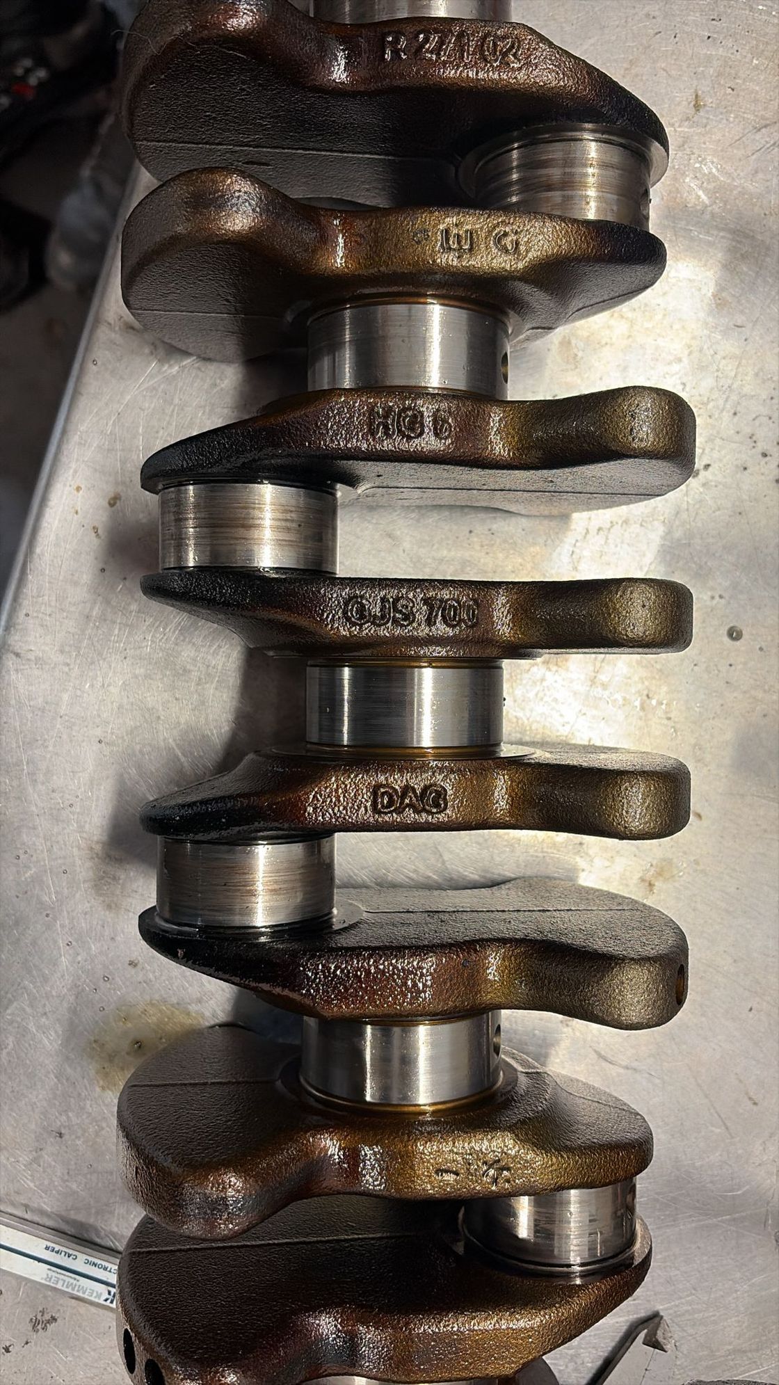

Hello, there is one guy on YouTube Bimmerhead who fixed it by changing the cranshaft bearings that is the reason of the low oil pressure.
the problem is caused by low oil pressure i think if the plug falls down after u replaced the tensioner it also happened when the car was new but the the crankshaft bearings were also new and everything ,so it did not cause problems but now since our cars have more miles U cant have both.

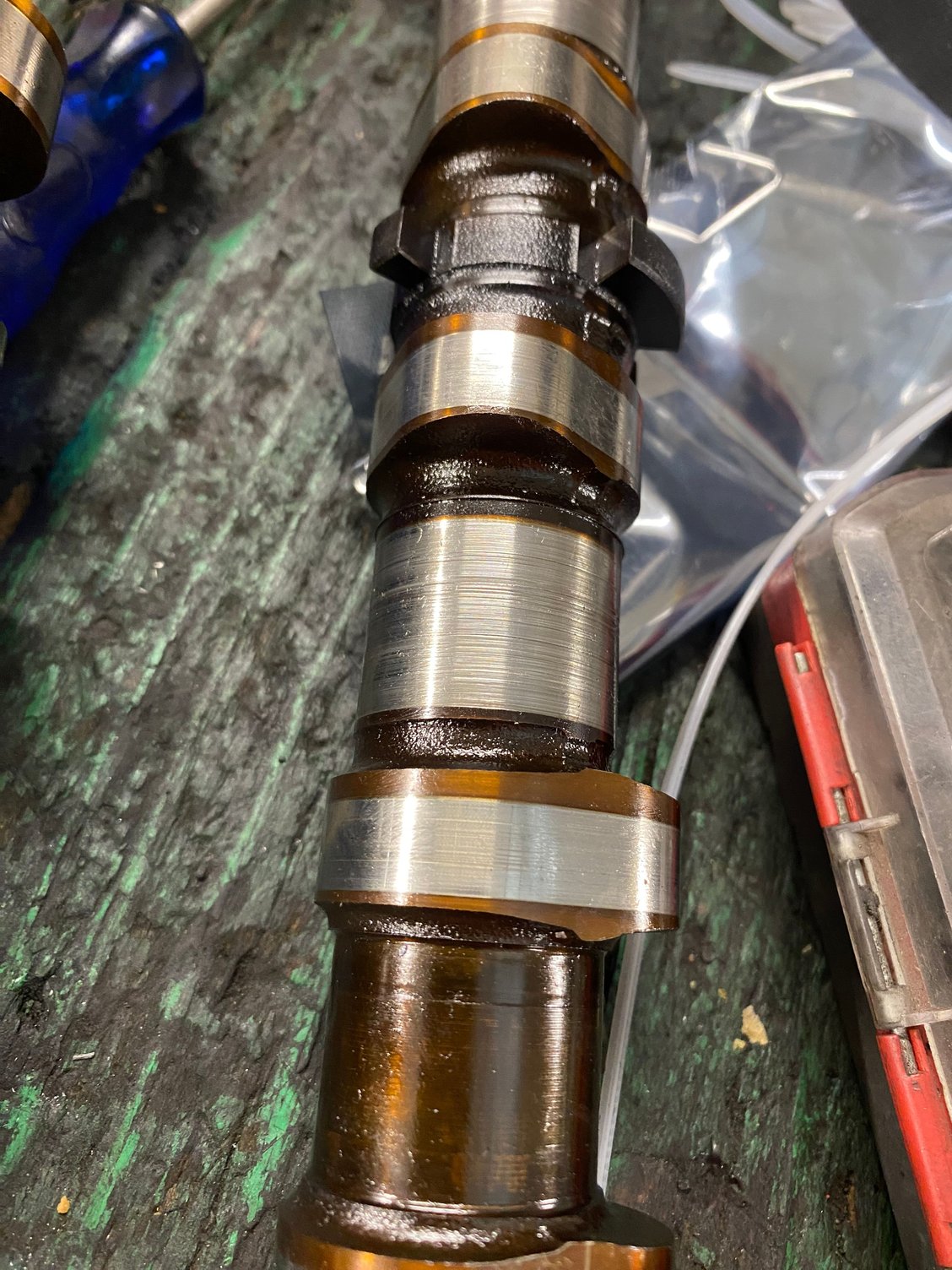

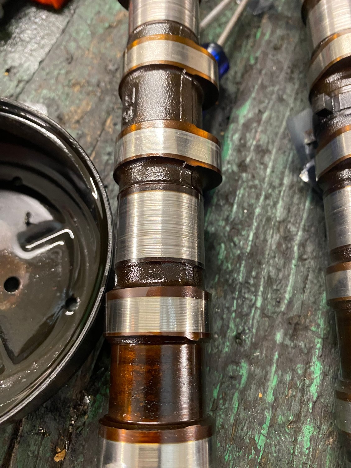

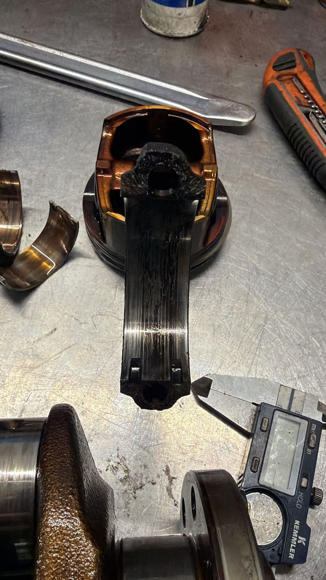

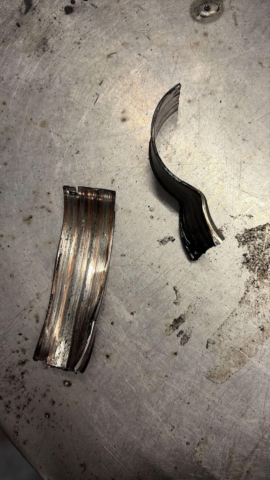

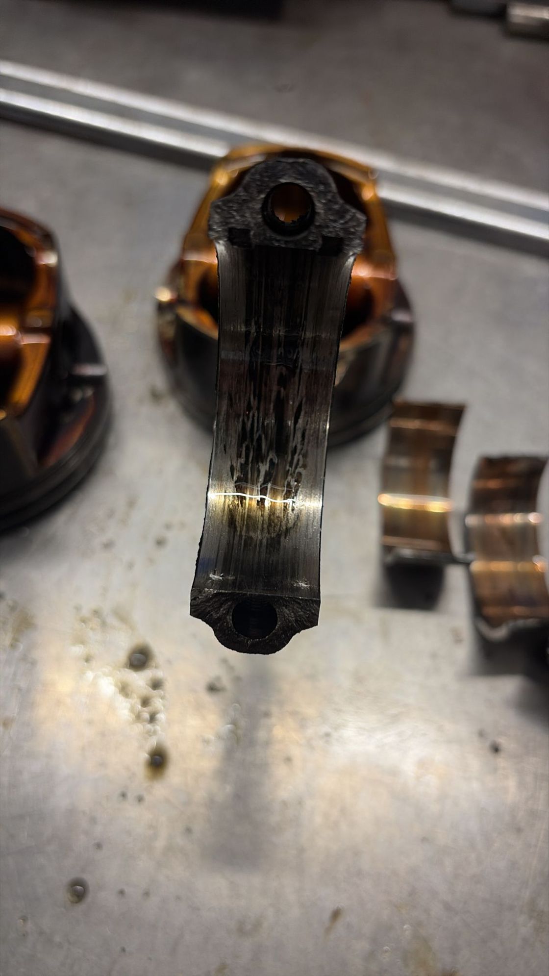

W212 1.8
Hello for all owner of w212 1.8 engine with that’s knock noise is from the crank bearing that conect the piston rod because of missing oil and high temperature is damage in that area
Also the camshaft are damage so the oil pressure is low
