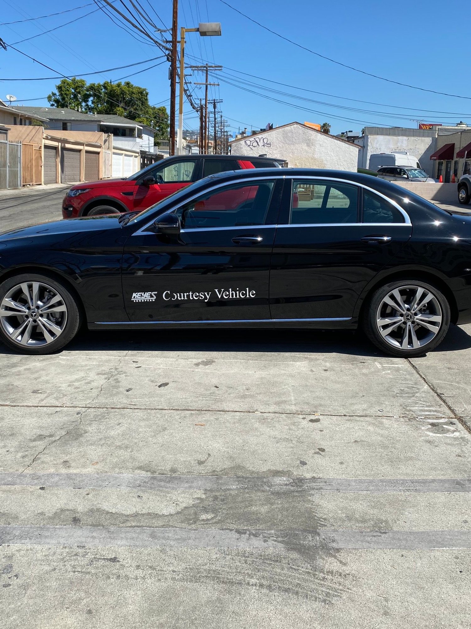

The mechanic found no leak; he said to come back if it's still using oil.
In the report, they transferred over recommendations from 2019.
Those have been addressed.
I have not been to the dealer in a while but it's still the same lousy experience.
The routine inspection is pretty laughable.
At least I got to drive the 2020 C300 loaner for a few days.

Quote:
Great question.Originally Posted by xsever
How would you compare it to your car in terms of driving (engine, transmission, feel...)?
TL;DR: The C300 is certainly a nicer car overall than mine but there are some trade offs. Keep in mind my car is 11 years old!
So you're talking over a decade of progress. The C300 felt a bit slower but transmission, suspension, feel etc. is certainly a better driving experience.
Would I buy it? Hmmmm. If I got an amazing deal on it, I probably would.
My preference would be a C43 2019 or C400 (specs wise but have to drive it).
First some stats for context. You probably know this but others may not...
2009 C350: Stock is 3.5 L V6, 268 HP with 258 lb-ft of torque.
I had it tuned by OE Tuning who claims 284 Horse with 273 lb ft of Torque.
17 Inch wheels but I'm changing them to 18 or 19 fairly soon. Torn on size but leaning 19.
Rear wheel drive. Naturally aspirated.
Mileage: 139,000.
2020 C300: 2.0 L four-cylinder engine. 255 horsepower and 273 lb-ft of torque. Turbo charged. 19 Inch wheels.
I drove with The AMG line package.
15-mm lower ride height to deliver more precise handling response (source MBUSA)
Not sure if it was 4-matic or rear wheel drive.
Mileage: 22,000 Miles
Off the line, the C300 still feels a bit slow due to the turbo lag and lack of HP. It did surprise me in the 20 to 25 MPH in terms of acceleration. MB has tuned the hell out of it!
Oddly the best mode is Comfort and not Sport or Sport Plus. Suspension was excellent and handling very good. The steering wheel felt a bit stiff. Then again I'm riding on 19" wheels.
Suspension: The C300 is certainly superior. I replaced mine with Bilstein B4 and I'm not satisfied. So maybe B6 or maybe H&R springs...
C300 Transmission: 9-tronic. Fast and smooth. C350 is the 7G I believe. The 2020 C300 felt like it had a better gear box.
The only complaints are the turbo lag and the lack of power.
Was I blown away? No but I was impressed with what they've done with a 2L engine. The suspension is a nice upgrade and surprisingly good.
Mileage: 139,000.
My car is back in the shop for a suspension rattle from the driver side. This time I have a C300 2020 with 18" wheels instead of 19" wheels.Originally Posted by Nicholi2007
Great question.TL;DR: The C300 is certainly a nicer car overall than mine but there are some trade offs. Keep in mind my car is 11 years old!
Mileage: 139,000.
The loaner is faster off the line than my C350 but not a big difference.
I’m not that surprised considering bigger wheels add weight and use more power.
I have to wonder what these cylinder blocks weigh?
The 18” don’t look terrible. Probably look better if you lower the car.
With 19" flow formed, Perhaps that might compensate.
