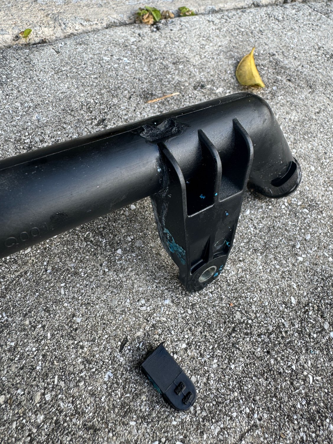

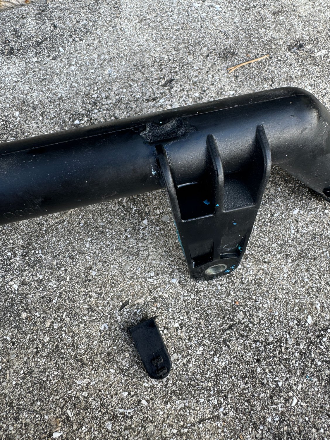

My Water / Coolant pipe broke in August of 2021 and I replaced it then with an Amazon replacement part. It has just now broken again. It looks like it broke where the two pipes connect together by plastic flanges. I think thats the same way it broke the last time. I don't see a reason as to why these pipes MUST be connected together through that plastic connector and I'm thinking it may actually be beneficial to cut off that flange so theres no pressure on it from connecting to the other pipe so that the flange doesn't break off again in the future...
here you can see the plastic flange that broke off and caused the leak in the pipe:

I had been thru the same experience. The Amazon pipe broke twice on me. I ended up getting one from the dealer and no issue so far, it's been almost year and half.
