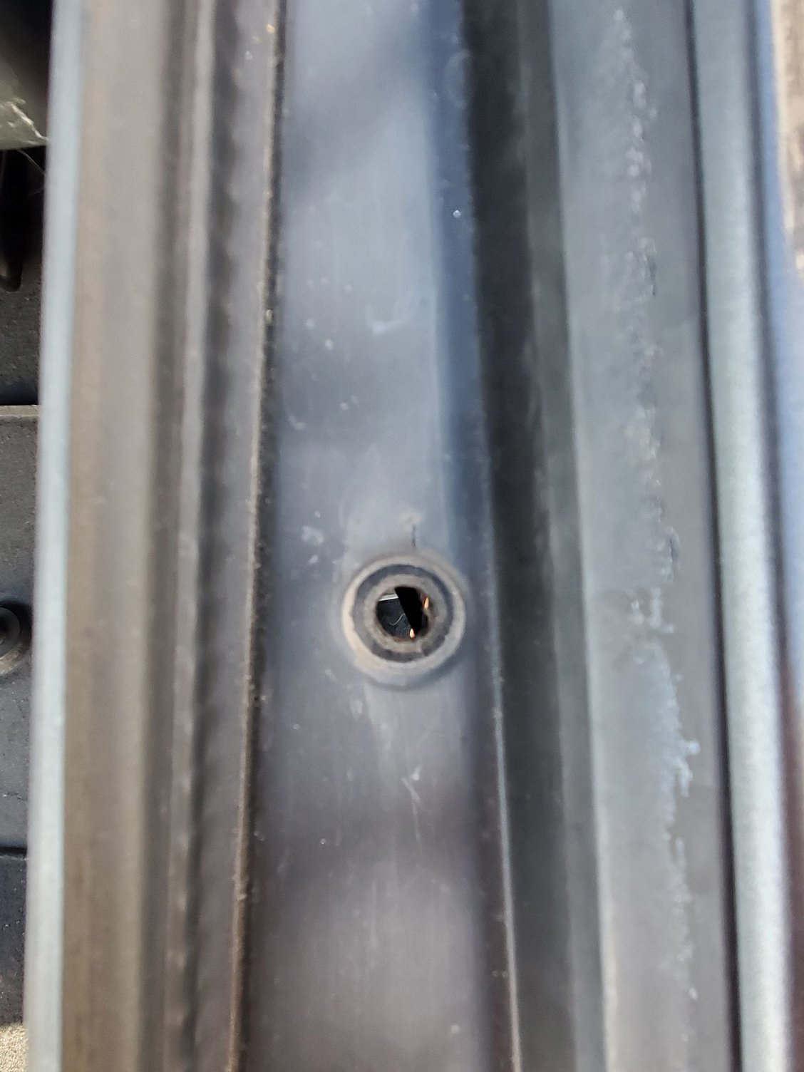

I also had a passenger side water leak in the trunk and believe I have located it. There are 4 rubber grommet/push pins that go through the plastic trim piece and the body of the car on each side of trunk. One is circled in this pic:
In this pic two are visible and circled and the arrow is pointing to the one in my car that dry rotted and is leaking water into the curved plastic piece below.
Its letting water drip in filling up the curved plastic piece and dumps into the trunk when opened. Dealer has these in stock and I will update with part number Wednesday when I pick them up.

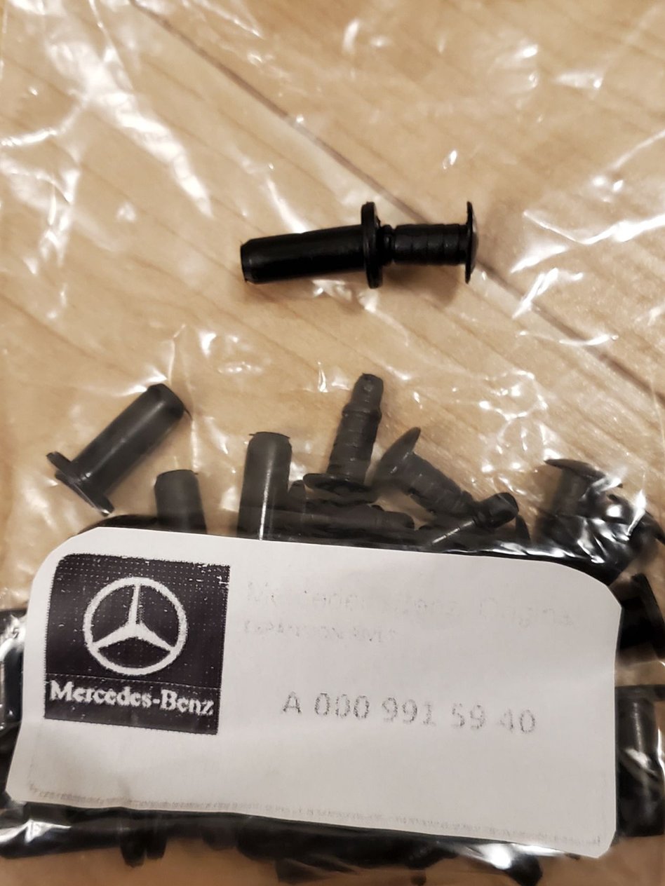

I believe the part is called
Rear Body Panel Trim Panel Clip - Mercedes-Benz (000-991-47-95)

My trunk was leaking from the trim fasteners show in the photo in Post # 10. They were rotted and falling apart. Bought and installed replacements Part# 0009915940 and solved the issue.

I opened my trunk yesterday and water came splashing down from the right side hinge inside. Guess i never replaced the trim fasteners on that side previously.
This right side is very easy to replace the fasteners. Can reach your hand up thru the little door and push the bottom of the fasteners upwards, then grab the heads and pull them out.
