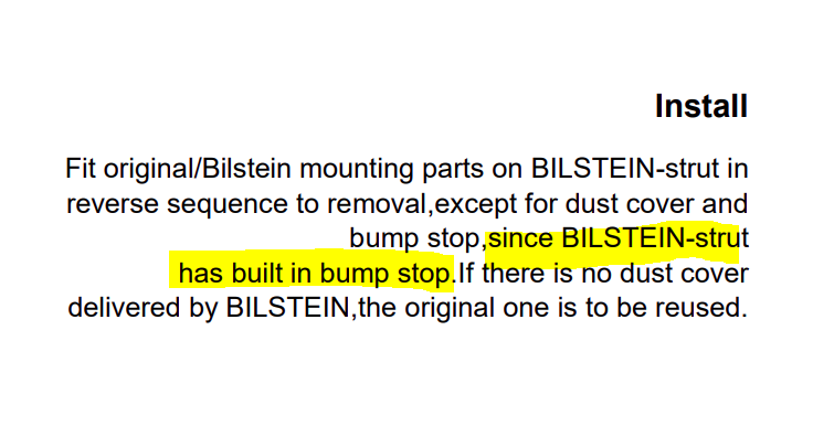

B4 Has Built-In Strut Bumps
Originally Posted by xsever
When the front struts were replaced, were the strut mounts replaced as well?
ADDITIONAL INFO:
1. The dust caps were never put back on.
2. The external bump stop was used which is INCORRECT for Bilstein B4!
I contacted Bilstein and they said NOT to use a strut bumpstop for the B4 as one is built in internally. I put them on. Man do I feel like a dumb ***.
I guess the prudent move would be to buy a new strut mount and bearing.
