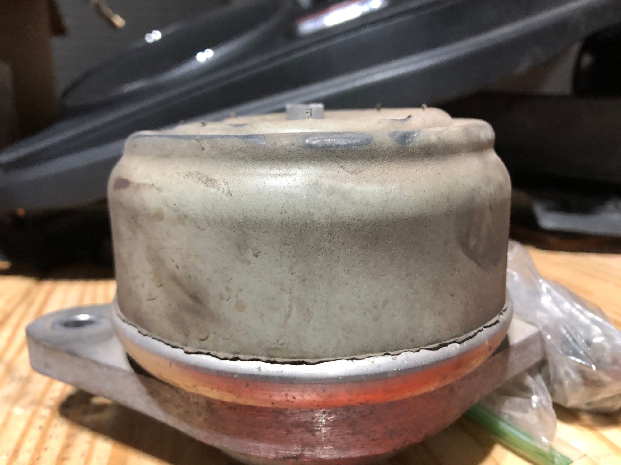

I actually just did the motor mounts, transmission mount, wheel bearing on driver side, axles replaced (torn boots) and the bearing on the shaft that goes through the oil pan to the driver wheel hub. (107k miles on vehicle)
My mounts were not leaking, there was not excessive movement from the engine when in drive, brakes applied and gas applied.
I had a harsh vibration when in reverse or drive stopped with brakes applied. It was basically quiet when driving. I also had a set of motor mounts out of another 4matic that were used and they were not leaking either despite having 193k miles but were bad also.
When I compared both of the used motor mounts with the new one it was so incredibly obvious that they had been compressed 1/4 or more than the new ones I got from fcp euro.
I dont think you can measure your mounts in the car unless you know how far away the heat shields are supposed to be from the frame rail or some other measurement, just guessing but maybe crank pulley from sub frame. My car probably had the issue for a while (I got it at 107k miles) since the vibration was so harsh so I would guess these cars mounts start to go around 80-90k depending on how you drive.
I had to unbolt (not remove) the alternator to get the pass side mount out, the heat shield on that side is one of the hardest parts about the job. I had to reach around the back of the exhaust manifold with a ratchet and extension and guide the etorx socket to the bolt. It was at the end of my reach and a real pain. Driver side I had to remove the axle and the shaft that goes through the oil pan to get the mount out once it was unbolted. The special tool for the 16mm bolt on the top of the motor mount is required and is also not the greatest design for the application but works ok, it would be better if it was shorter. Overall a real challenging repair but made a huge difference.
First pick is engine mount collapsed. Second is the rubber cover pulled up to represent what the new one looked like
For them to split and have excessive movement would have to be a complete failure which would result in hydraulic fluid leaking. I was surprised how good my mounts looked at 180k miles when I pulled them out. I did have slight vibrations here and there but nothing excessive, I would imagine that's how these mounts seem to fails and cause vibrations. Hopefully, the new mounts will get as much mileage since it's not a fun job, I was just lucky I had to take the engine out anyways which made it an easy "while you're in there" job.

If you think your mounts are bad, they are, change them. Super common failure. Don't even bother trying to measure them, they are collapsed enough to see, they are bad.
