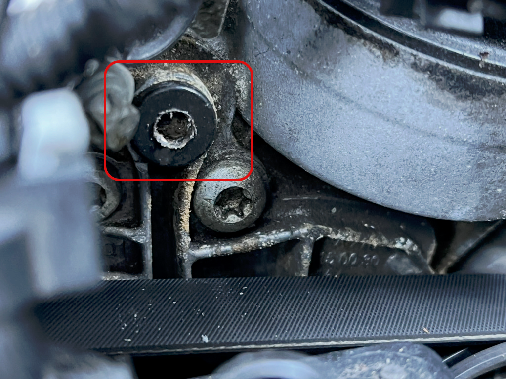

Maybe this was asked before, it is possible I missed the info as I started skimming the posts after a while... I read in the posts that there is no oil pressure sensor - makes sense that I was not able to find a way to check it with my Launch tablet, even after checking menu after menu. How does one check the oil pressure on the M276?

look near the base of the oil filter, you'll find a screw on plug where you can thread an oil pressure gauge.
You can go fancy and use a pressure transducer to record pressure vs. Rpm.
Regulated Max is ~60Psi.

Here you go! Check the attachment.

Be careful not to strip the plug. It is now going to be a pain to remove!
