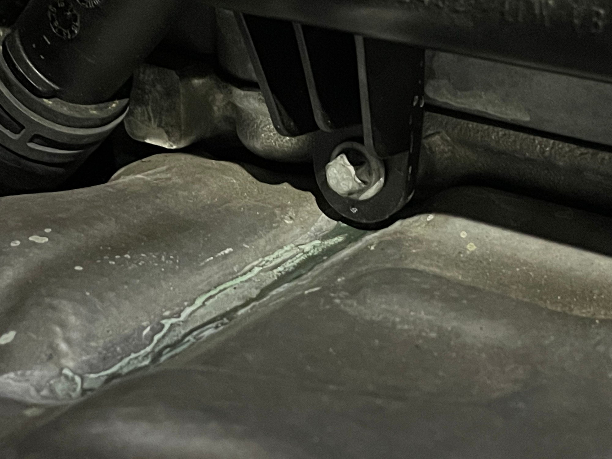

There is a small leak of what I suspect to be coolant coming from behind this bolt somewhere it only leaks when engine is on. The bolt is for one of the coolant hoses as pictured. Could my plastic hose have a crack? Any ideas?

I think you have correctly diagnosed the issue and it’s a known problem. Fairly inexpensive part and simple fix.
Oh awesome! Thanks for the confirmation.

Could anybody tell me what the part I need is called?

This is the part number for a 2013 C250 271-200-26-52 The parts diagram calls it a water pipe.
much appreciated, thanks guys!

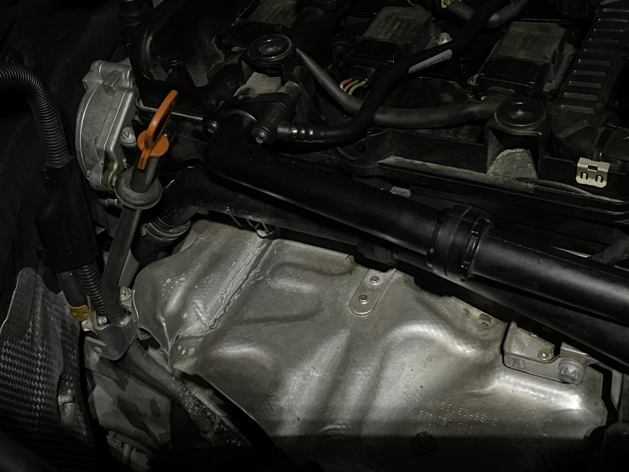

Look here, I changed the pipe with one from amazon.
It's not that of a difficult DIY but one of the clamp I had to cut off and used a generic one from home depot.
I ordered mine a few months ago from my local dealer’s online parts center (½ the price of the walk up parts counter). It came with the rubber extension, so no need for the new hose clamp.
Either way it’s a beginner level repair that takes less than an hour.
Follow the DIY by meazzi1.
