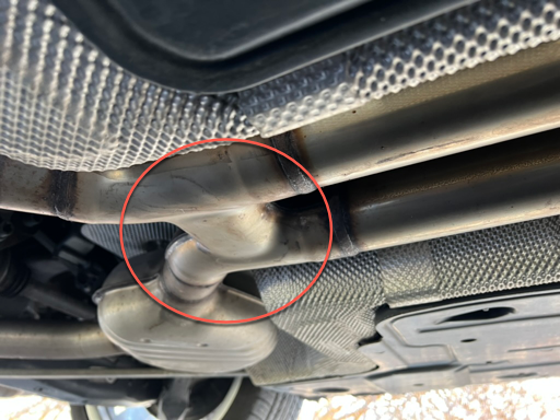

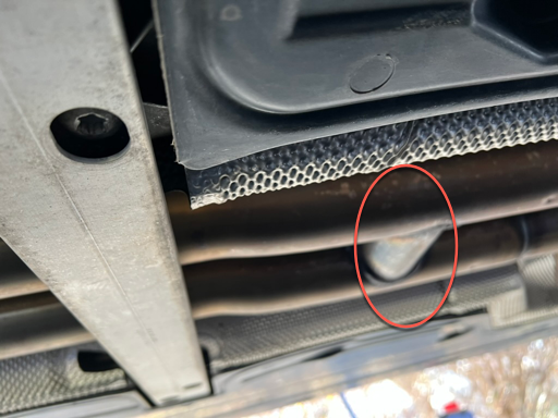

Pipe diameter has a LOT to do with the sound. I haven't measured, but I think the pipes on my SL400 are at least 2½", maybe larger. Also, the stock exhaust has two crossovers with one toward the front and one toward the back. I've never checked on my W204 C350 but will look the next time I get a chance.
On cold start, the SL sounds like a racing boat idling in the water.
Front crossover
Front crossover
Rear crossover
Rear crossover
I have gone the route of a 3" turbo back on my Audi TT. With an aftermarket muffler, it sounded raspy and would drone on the highway. I tried everything to eliminate the drone. Finally, I put the factory muffler back on to quiet things down a bit. Not as quiet with the factory pipes, but much better than before. The guy at the parts store, who seemed to know what he was talking about, said my problem with the droning was due to the 3" pipes all the way back.
Front crossover
Front crossover
Rear crossover
Rear crossover
Mine started droning as soon as I removed the resonators which makes sense. When I welded the Vibrant resonators in, it got better. W204 C350 only has 1 baffled x-pipe in the whole exhaust. No other crossover or H-pipe like you showed on the SL.
