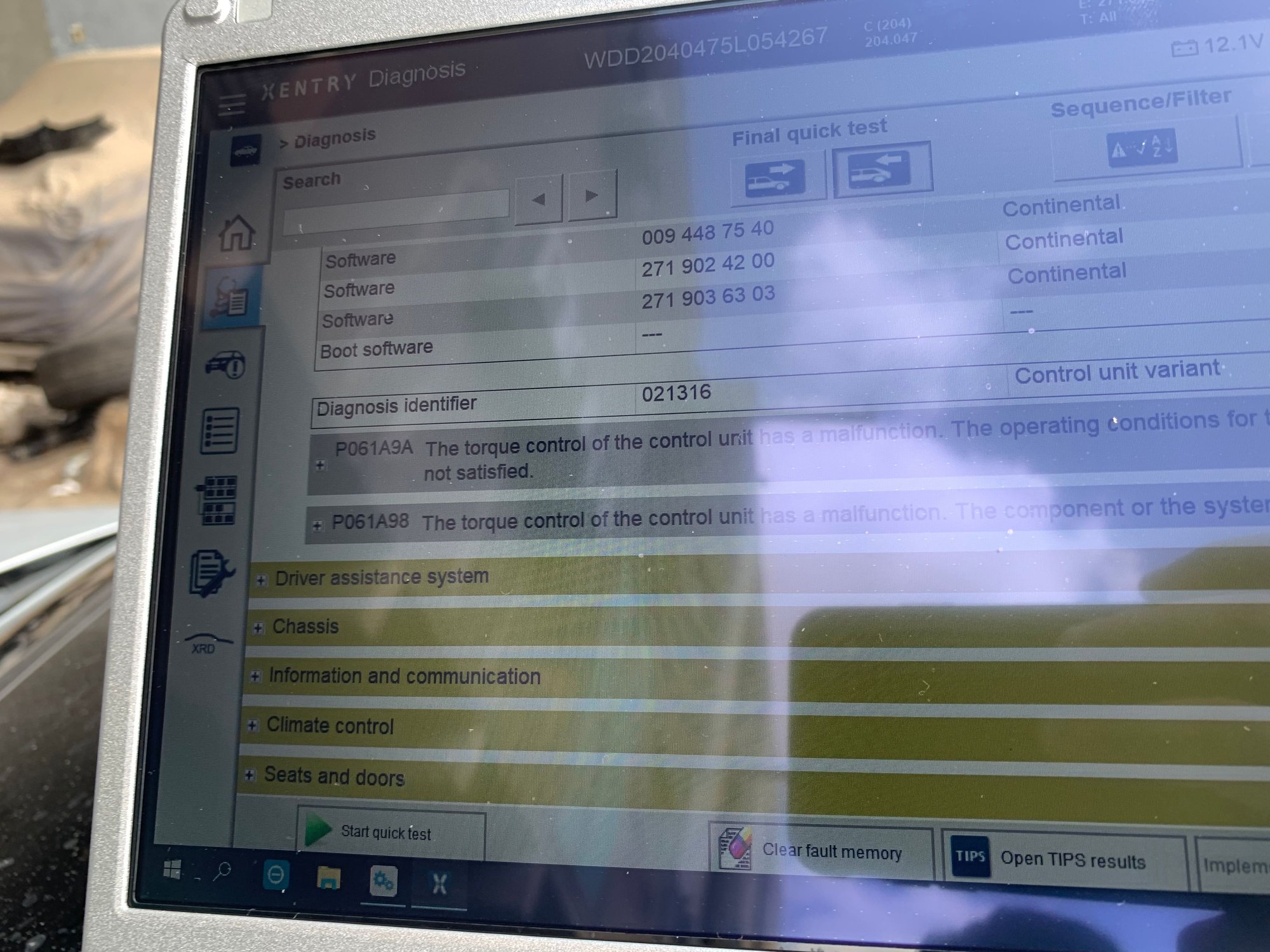

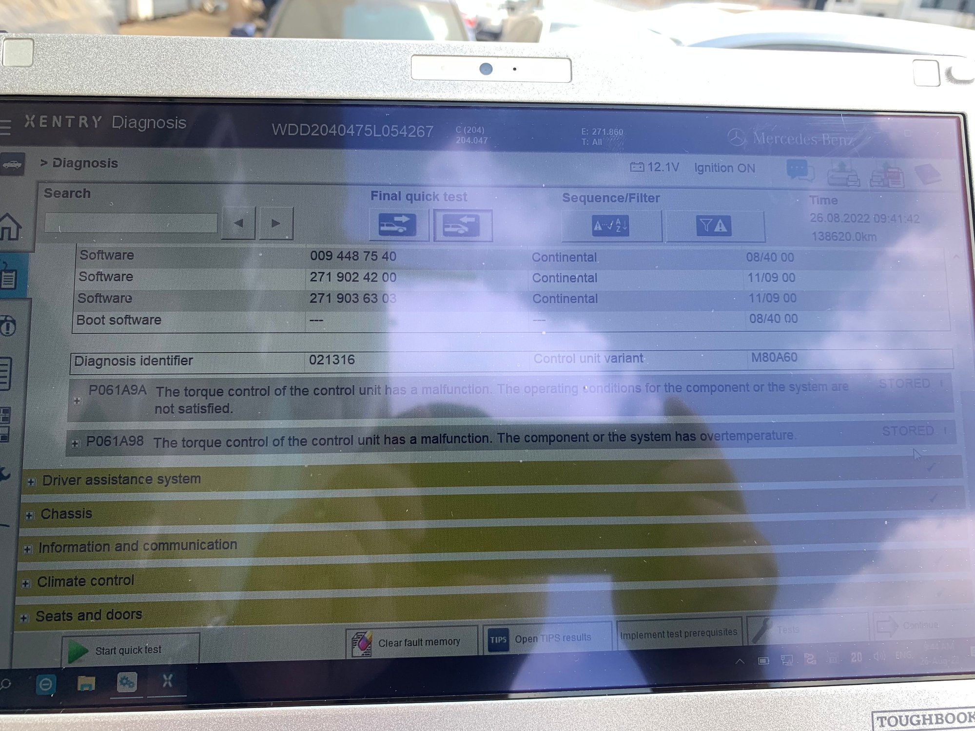

here we we go same fault with xentry. The second one from the thermostat. Its original mercedes

Lucky you 👍
these faults are STORED...
non active...
Simply reset faults and have a nice day then scan again in couple days.
