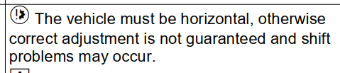

Attached are instructions for adjusting the shift rod. It seems like a simple enough procedure. It may be that it just needs a slight adjustment.

Interesting warning!

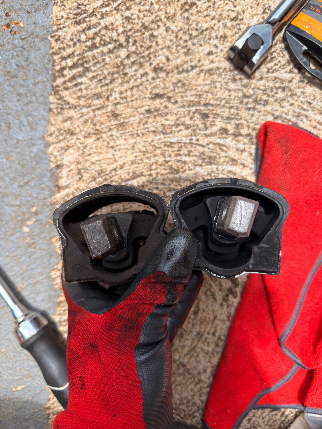

Here is a picture of the tranny mount I just replaced on my SL. It has about 54,000 miles on it. I'm not sure it needed to be replaced, but I did so anyway. The is no load on it and it does not seem worn -- no cracks in the rubber, etc. But in an unloaded view, there is space above and below the rubber. I replaced it without removing the cross member.
https://cimg7.ibsrv.net/gimg/www.mbw...13a46a0129.png
The ragged stuff is just residual rubber.

Originally Posted by JettaRed
Woah that is interesting.
Yeah, I don't know why being level is necessary.
Precise.

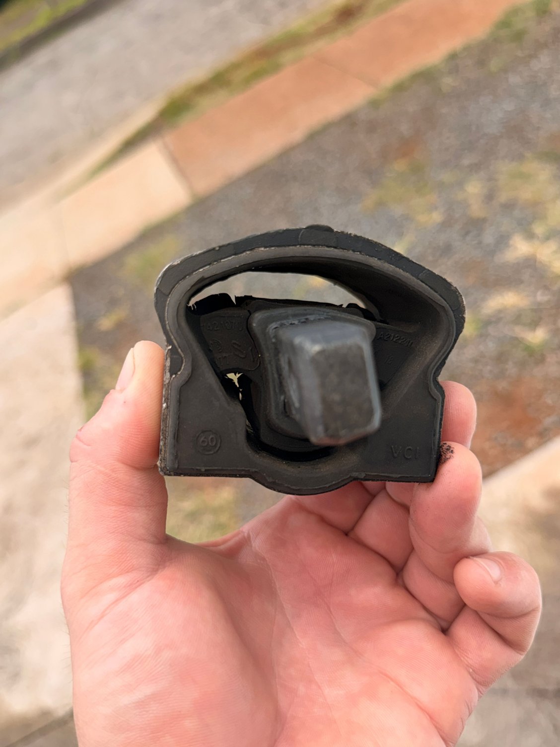

Thank you so much, my dear friend! I bought my car at an auction a year ago, and it had this awful humming noise, loud operation, and vibrations starting from 2,000 RPM. Based on the sound, you’d think I had a 6-liter engine under the hood! The car was also super sluggish during acceleration. After sitting for a few days, it would run a bit better, but then the issues would come right back.
I replaced the idler pulleys, the tensioner, the vacuum pump, and the transmission fluid. Eventually, I thought it was the timing chain, so I replaced that too. Finally, I stumbled upon your post, bought a $40 motor mount, and swapped it out. My ears literally popped from how quiet it suddenly got in the cabin! Now the car drives like a rocket. Thank you again, my dear friend
