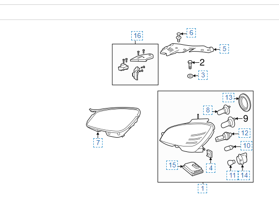

Hello all, new around here so if this has already been answered my apologies! My front left headlight is having some issues. I am not sure if this is an LED that would require an entirely new housing or if its just a simple bulb fix(circled in photo 1 and out in photo 2). I checked MBparts and found this
(photo 3) can anyone tell me what bulb it is that needs to be swapped or let me know if I need a new full unit. Thanks in advance! here is my VIN incase there are compatibility concerns WDDGF56X68R035248 Thanks in advance!

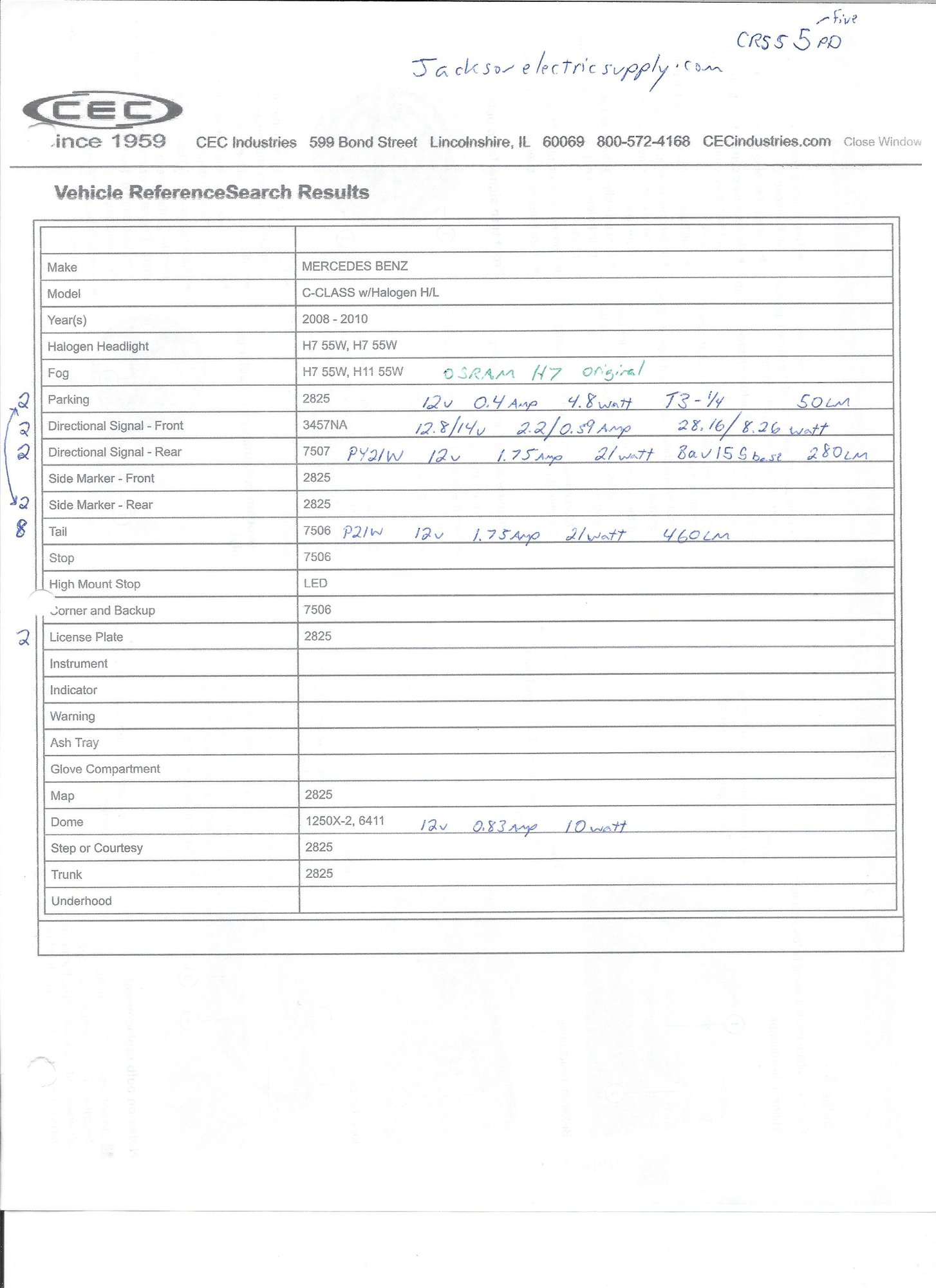

It looks like I have the same headlights as you. The Mercedes brand bulbs for those are expensive so i just used regular type bulbs. The original Mercedes are blue, so if you use just regular bulbs they are a little brighter. I replaced with 2825LL (Long Life). They are fairly easy to replace, just look in the back and you will see the covers to access the bulbs. Theres 2 bulbs in each headlight.
Heres the sheet I used to figure out the exact bulbs to replace.
FCP has them fairly cheap i guess.

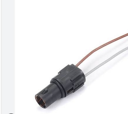

I think the harness looks similar to this. has notches that need to be rotated to pull it out. Then just pull the bulb from the harness, replace, then good luck reinstalling it. Take your time and use a good set of needle nose.
