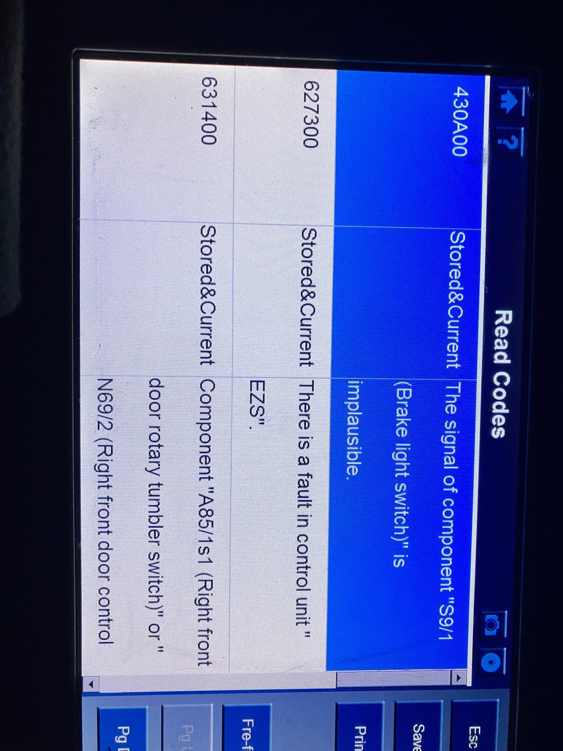

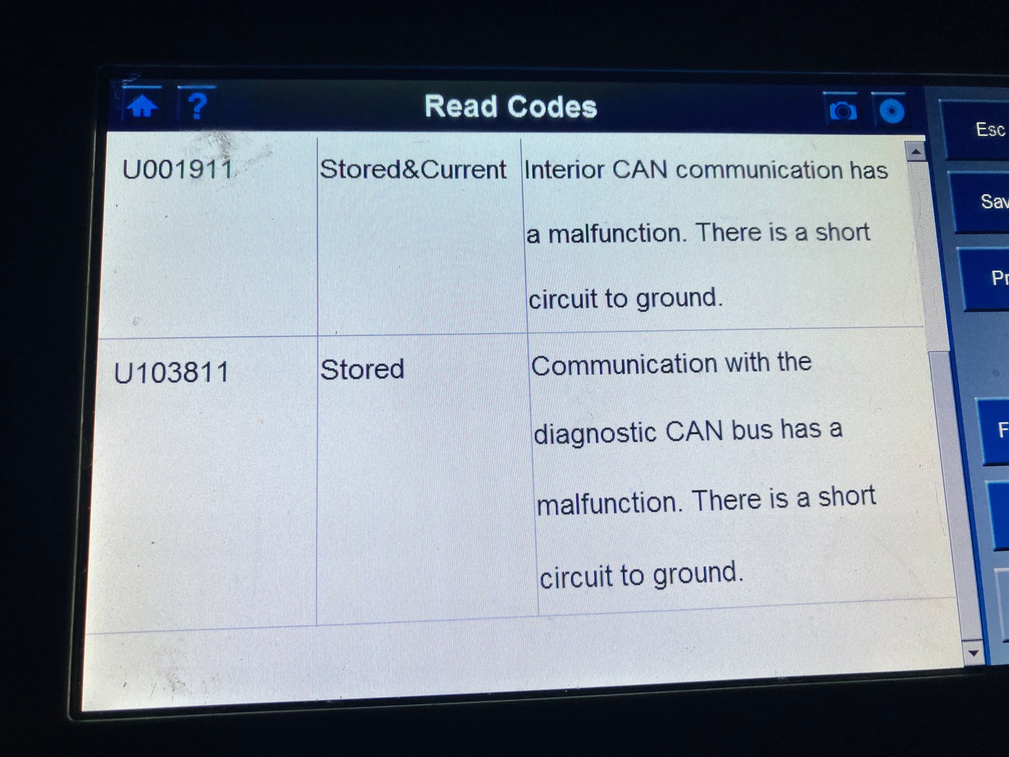

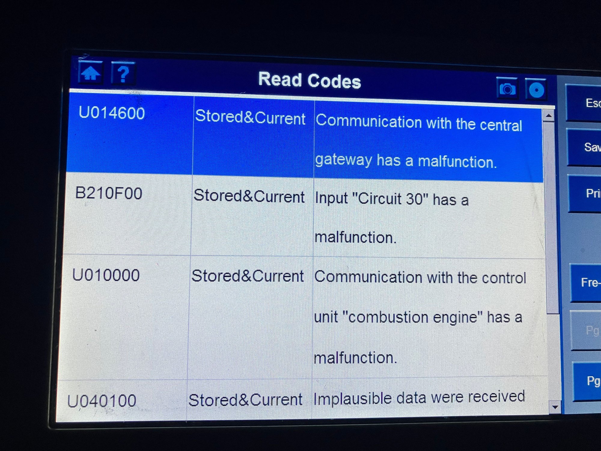

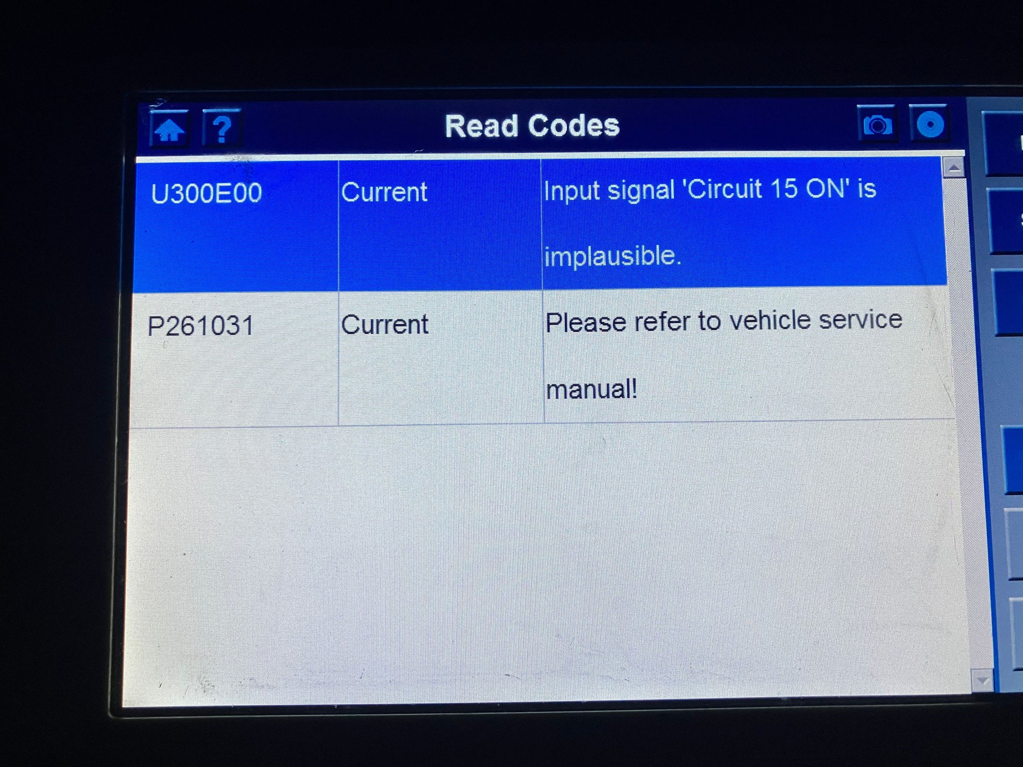

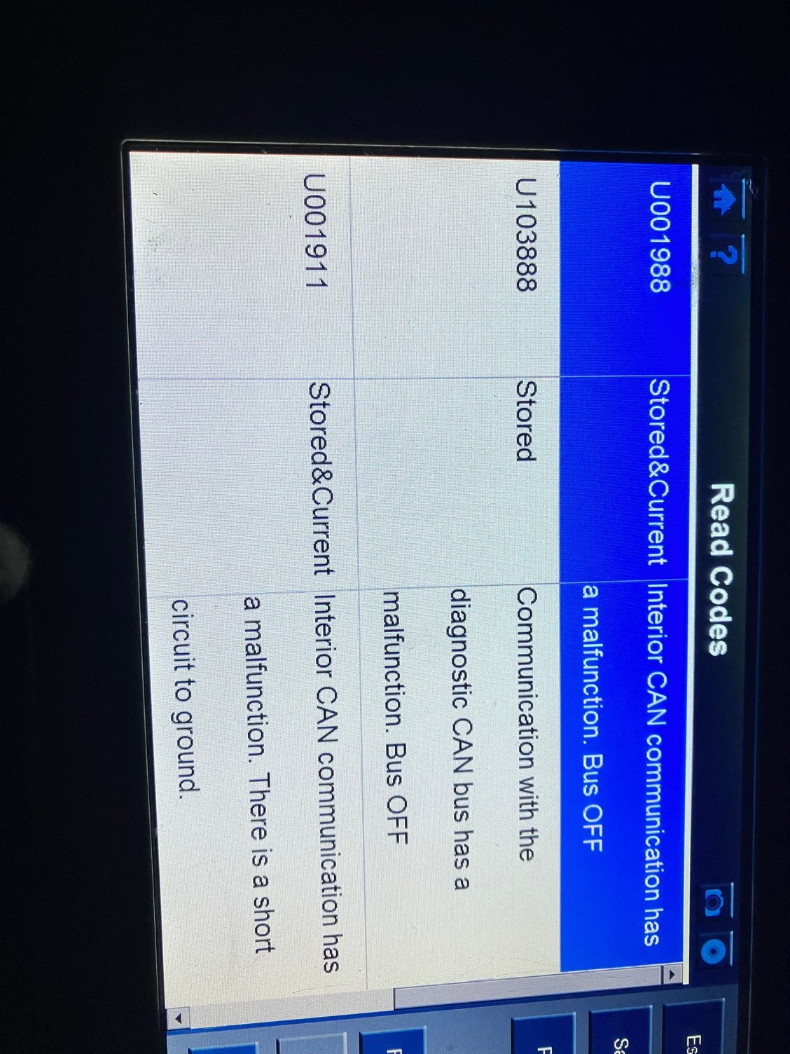

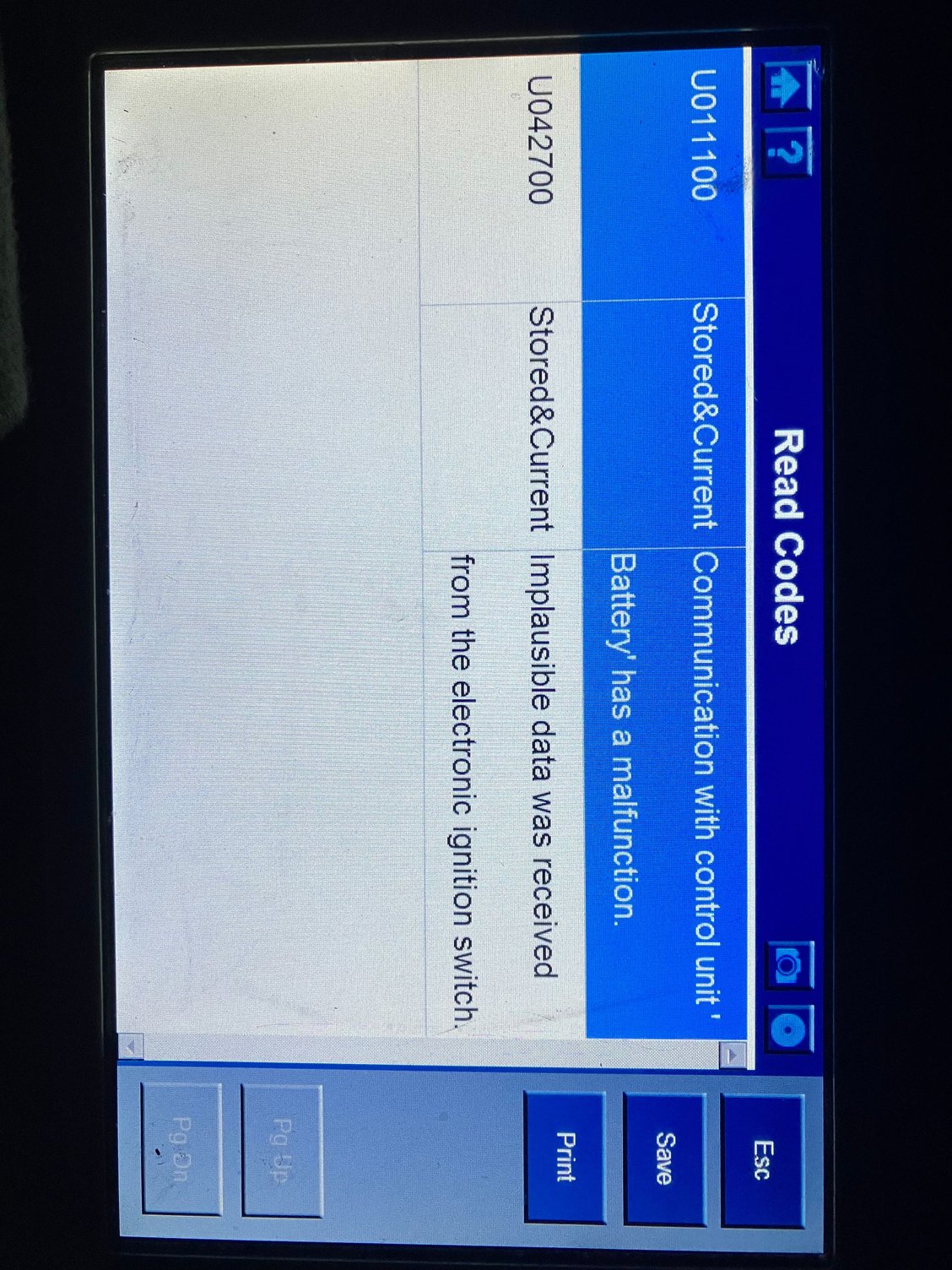

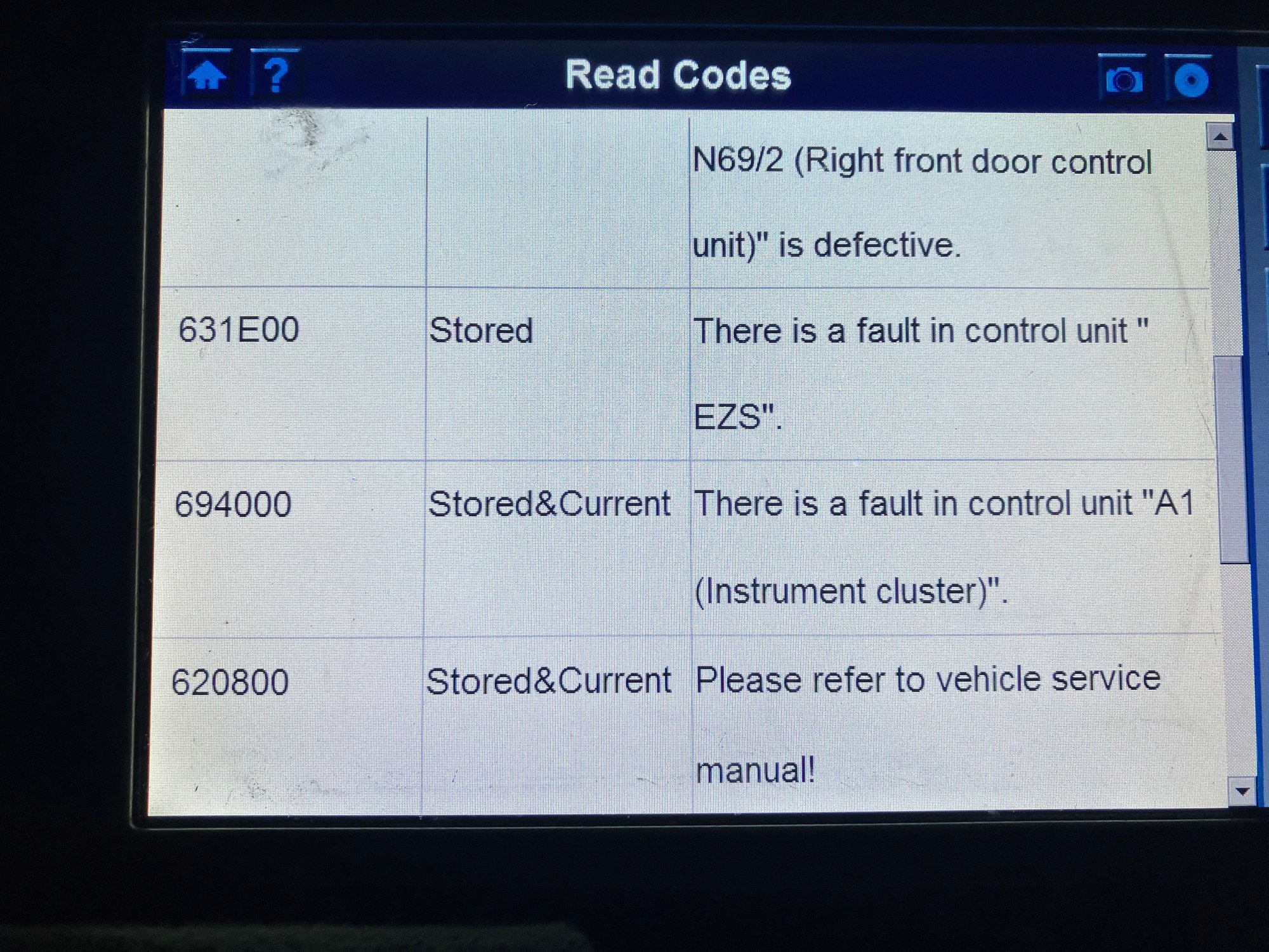

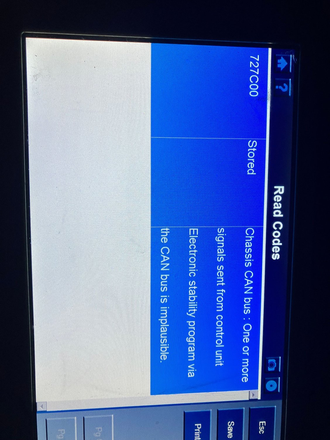

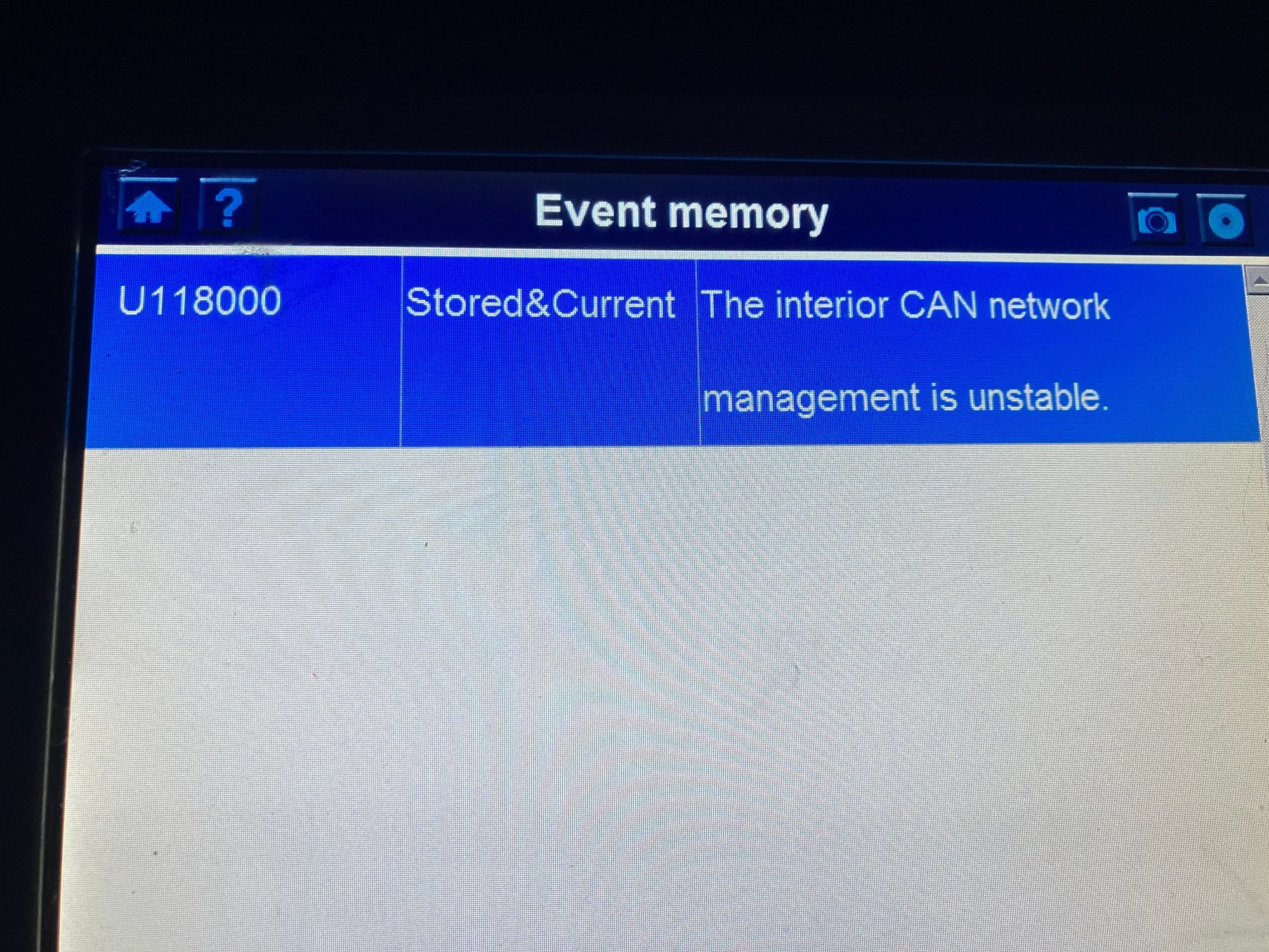

Codes that I'm getting are:
A25464-electric steering lock
U300E00-circuit 15 on is implausible
627300-fault in EZS
430A00-signal of s9/1 brake light switch implausible
U118000-interior can unstable
U001988 int can comm malfunction bus off
U001911- int can comm short in ground
U014600 comm cgw malfunction
P261031 ECM/PCM engine off timing
I noticed that the steering wheel lock goes out on our vehicles, but would the power to my windows etc be dead as well? Thank you

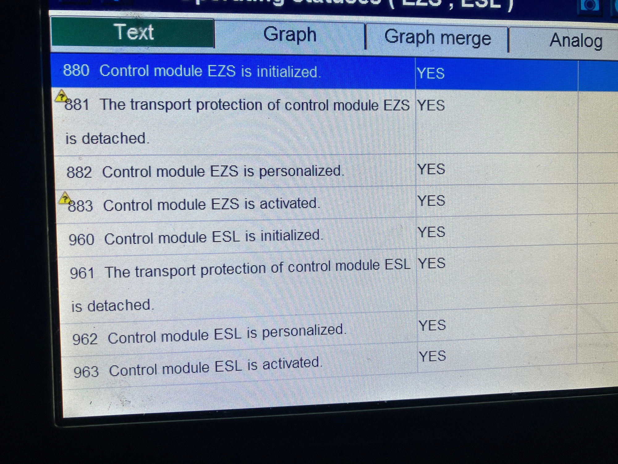

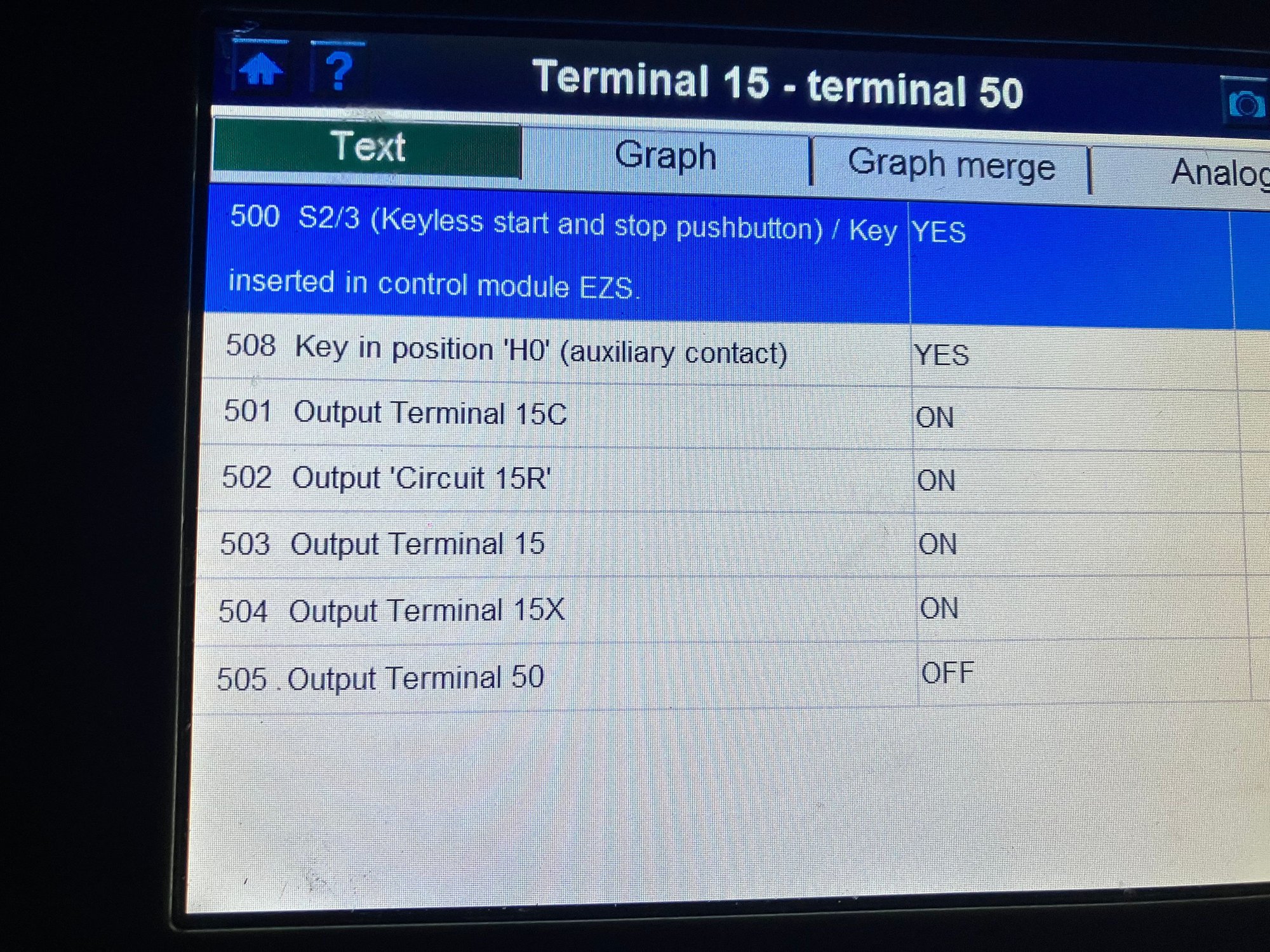

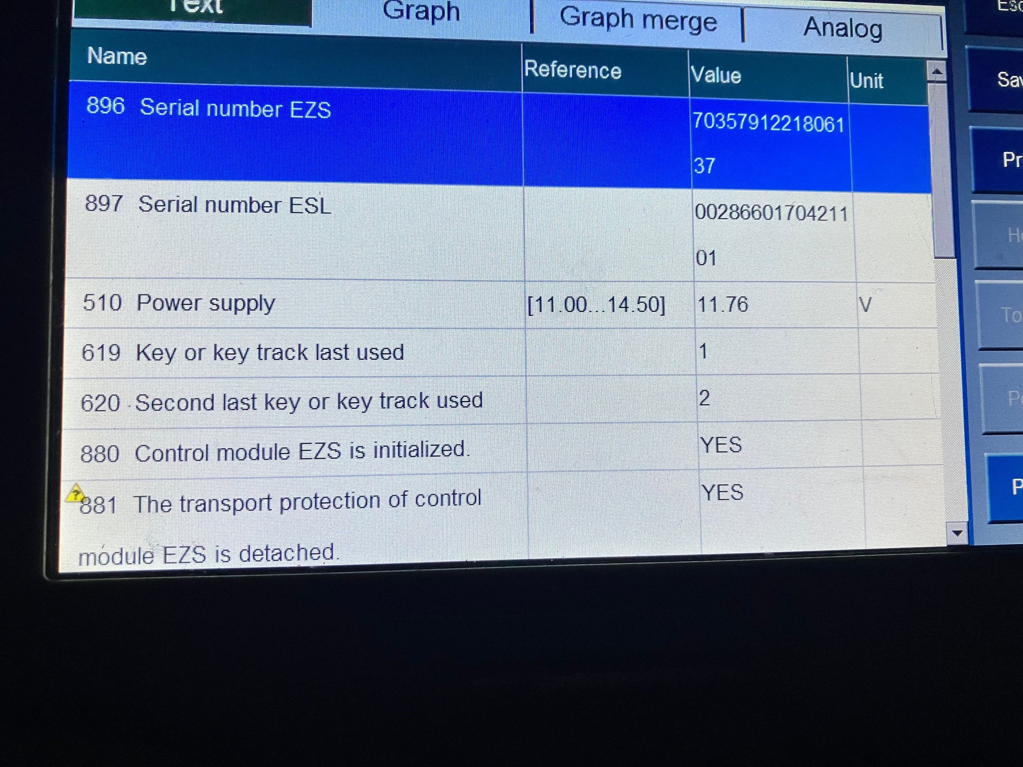

* update *

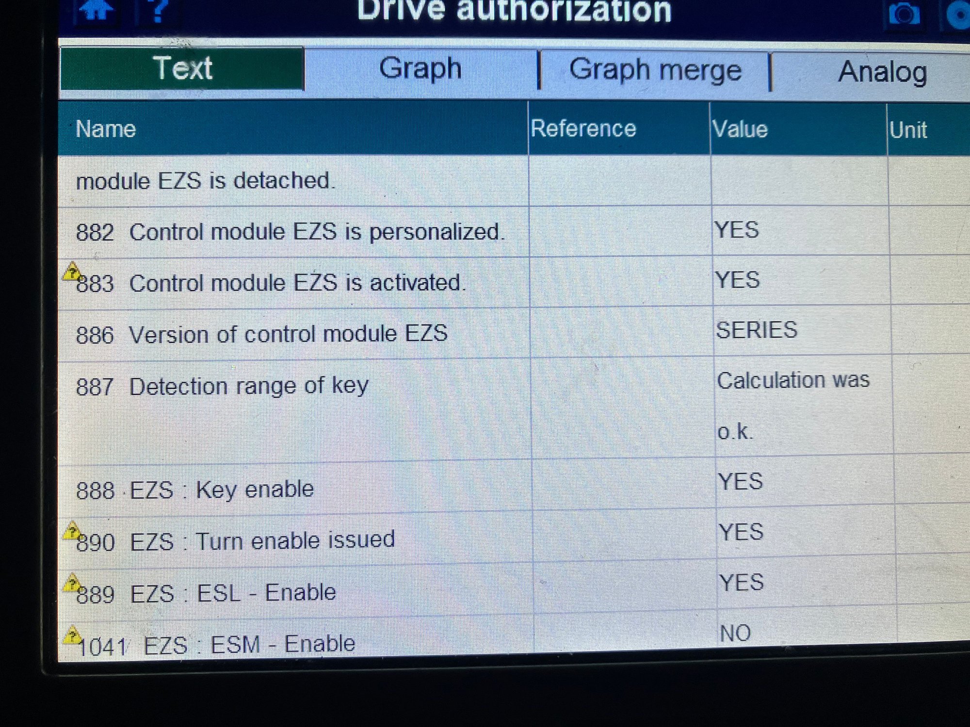

I was viewing the live data and it seems that the electronic steering lock is functions as it should. This is what I'm seeing, can someone please verify that these values are correct?
Circuit 15 off
Circuit 15C on
Circuit 15r off
Circuit 15x off
Circuit. 50 off
When I insert the key 15c is in on,
key turned 1x 15r is on
2x 15x & 15 on
3x 50 on 15x off
I believe that is the correct values for a good electronic steering lock, or am I wrong?
Also, I can't get my windows up, even when connecting a jump box to the car.
What is the power source for the windows?

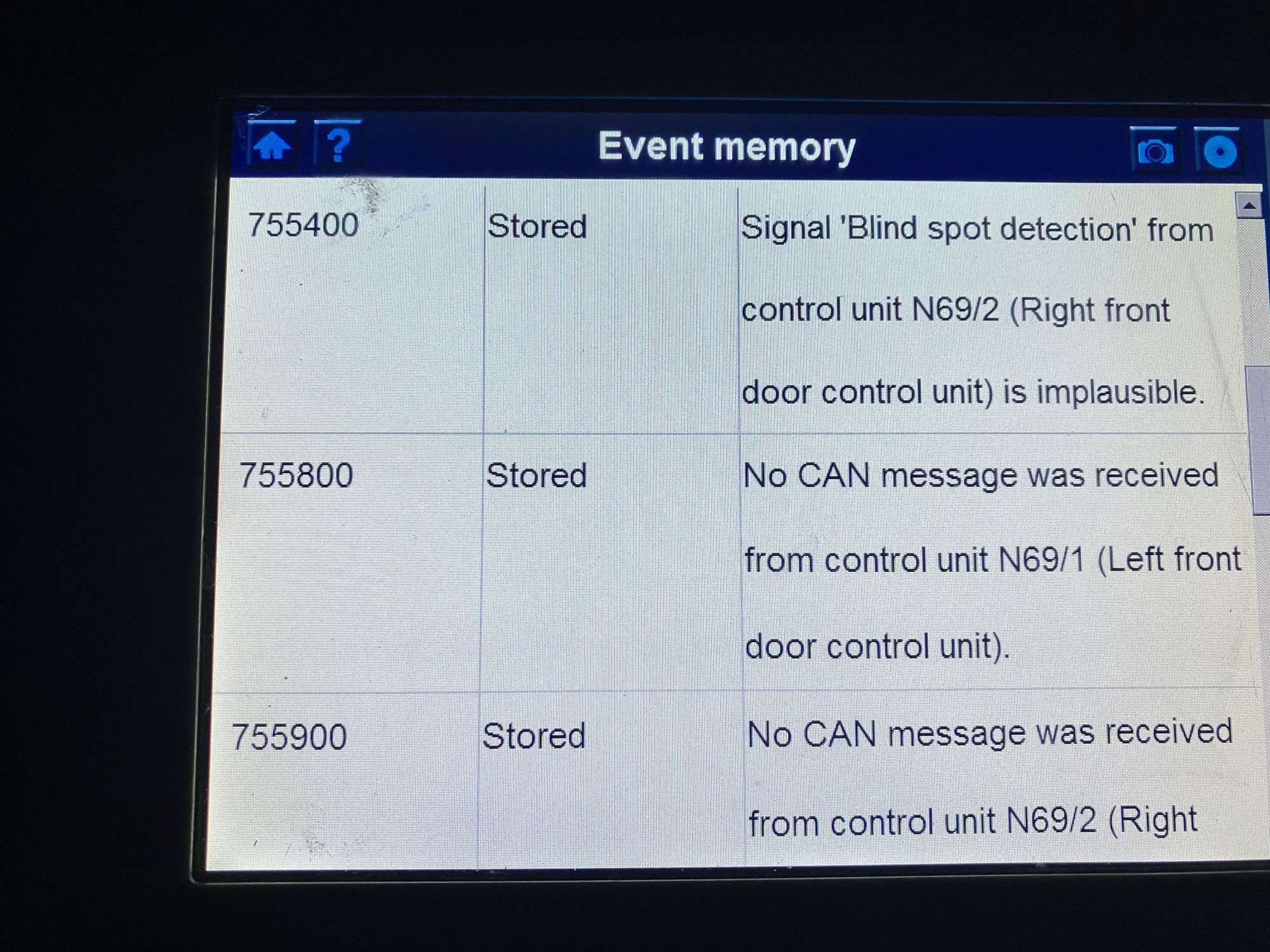

'99 and '05 E55 AMG
Start with the lower numbered codes. CANBus failure. Supposed to be redundant in case one line fails open or shorted. Unusual to lose both high and low but I have experienced a short on a Can-Hi that overrode the CAN-Lo line.
Put a multimeter on the lines and see if one or both are showing voltage values close to zero. I don't have on me the value for each Hi and Lo line in your car. In my case, e.g., on my W210 Lo sleep is 4.9 volts, Hi sleep is 0.2 volts. My Hi line was 0.01 volts with 95-ohm short to chassis. Would not allow the CAN-Lo line to drop low to 4.2 volts and the Can-Hi could not go high therefore no data transmitted.
then you start disconnecting sub-systems until the sleep voltages return to normal. Your problem will be in the disconnected subsystem. Your failure to communicate with the Central Gateway (CGW) is a huge warning sign to me. Possible CGW failure or just a shorted/open connector? Don't know.
Edit: windows are controlled by Door Control Modules which require CANBus communication to function. Internal CANBus failure, no communication to DCM to control window function.

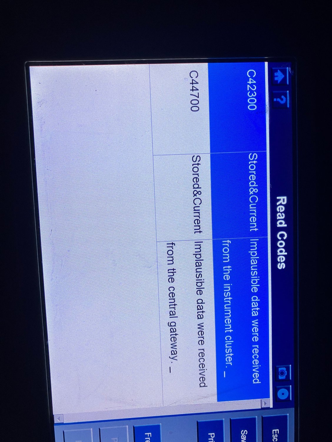

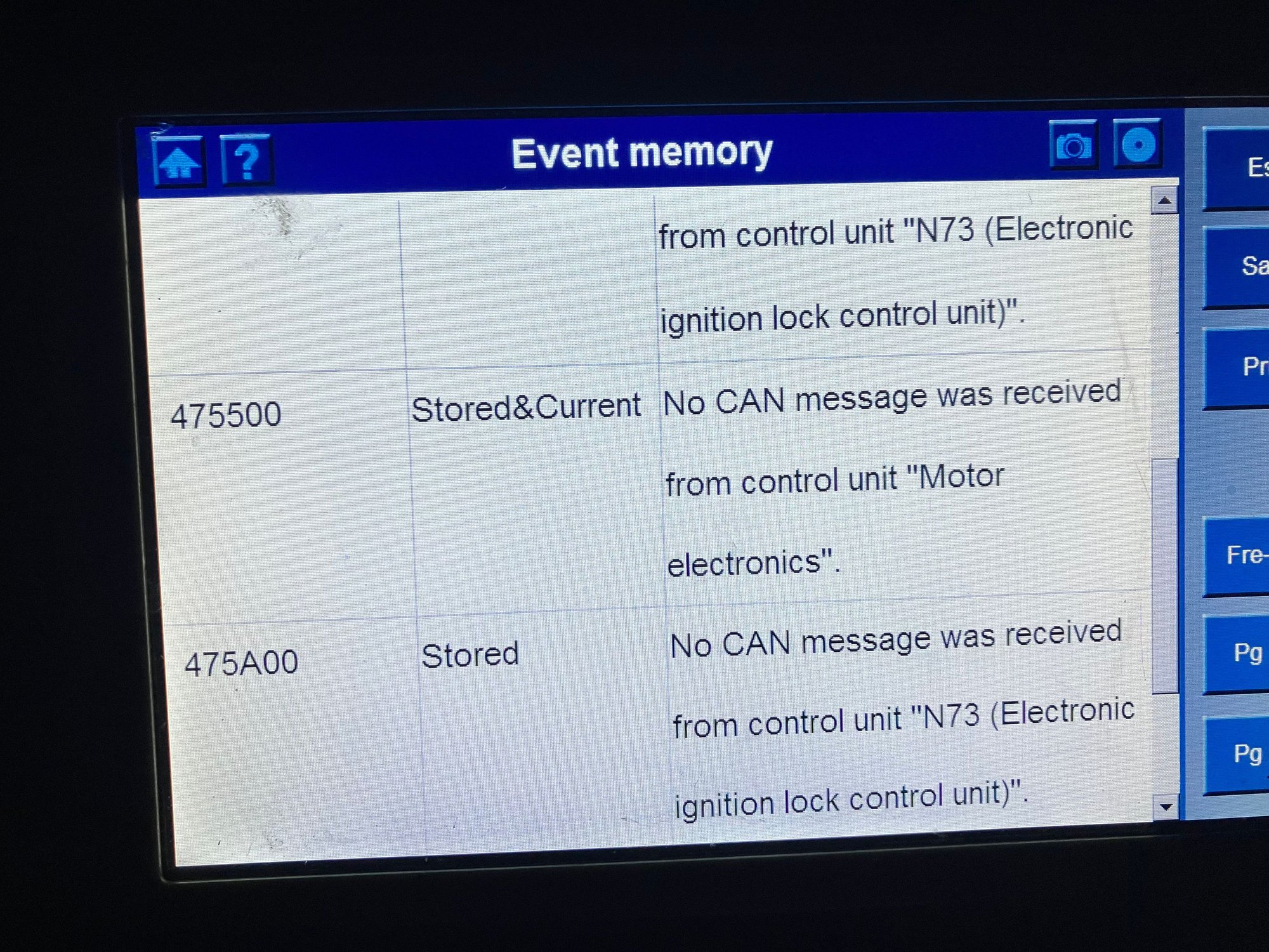

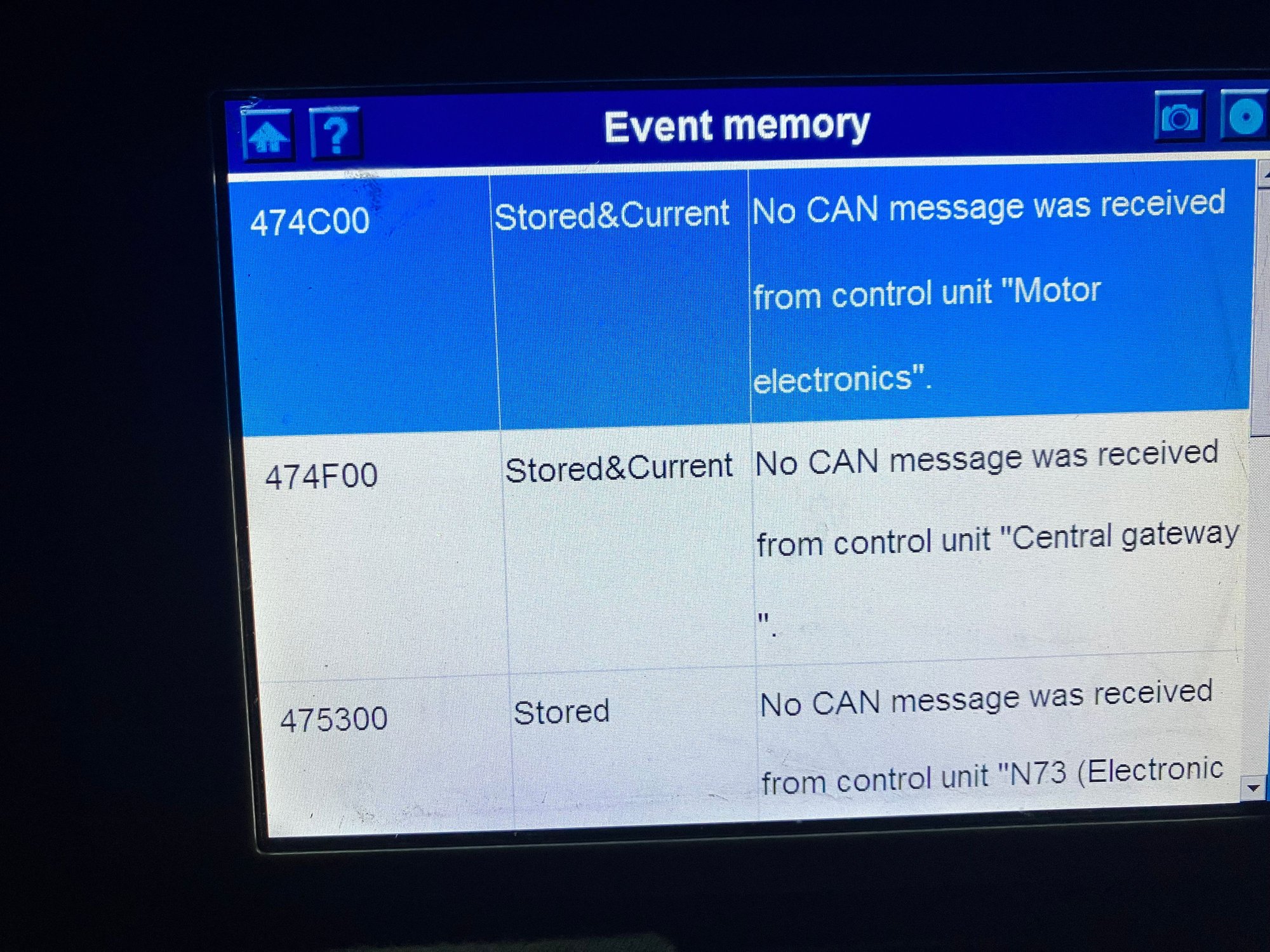

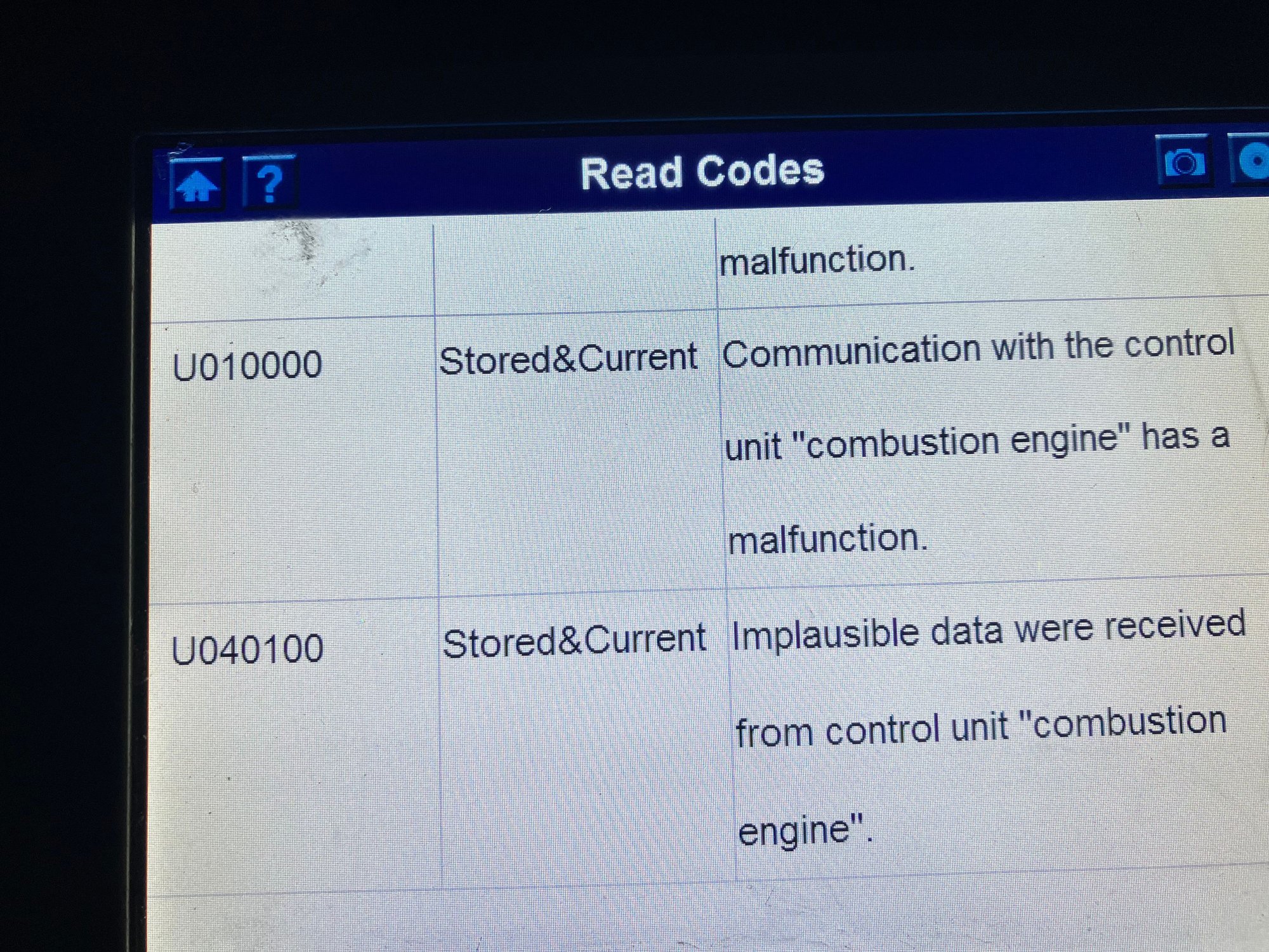

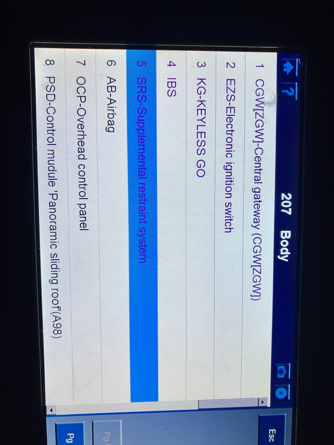

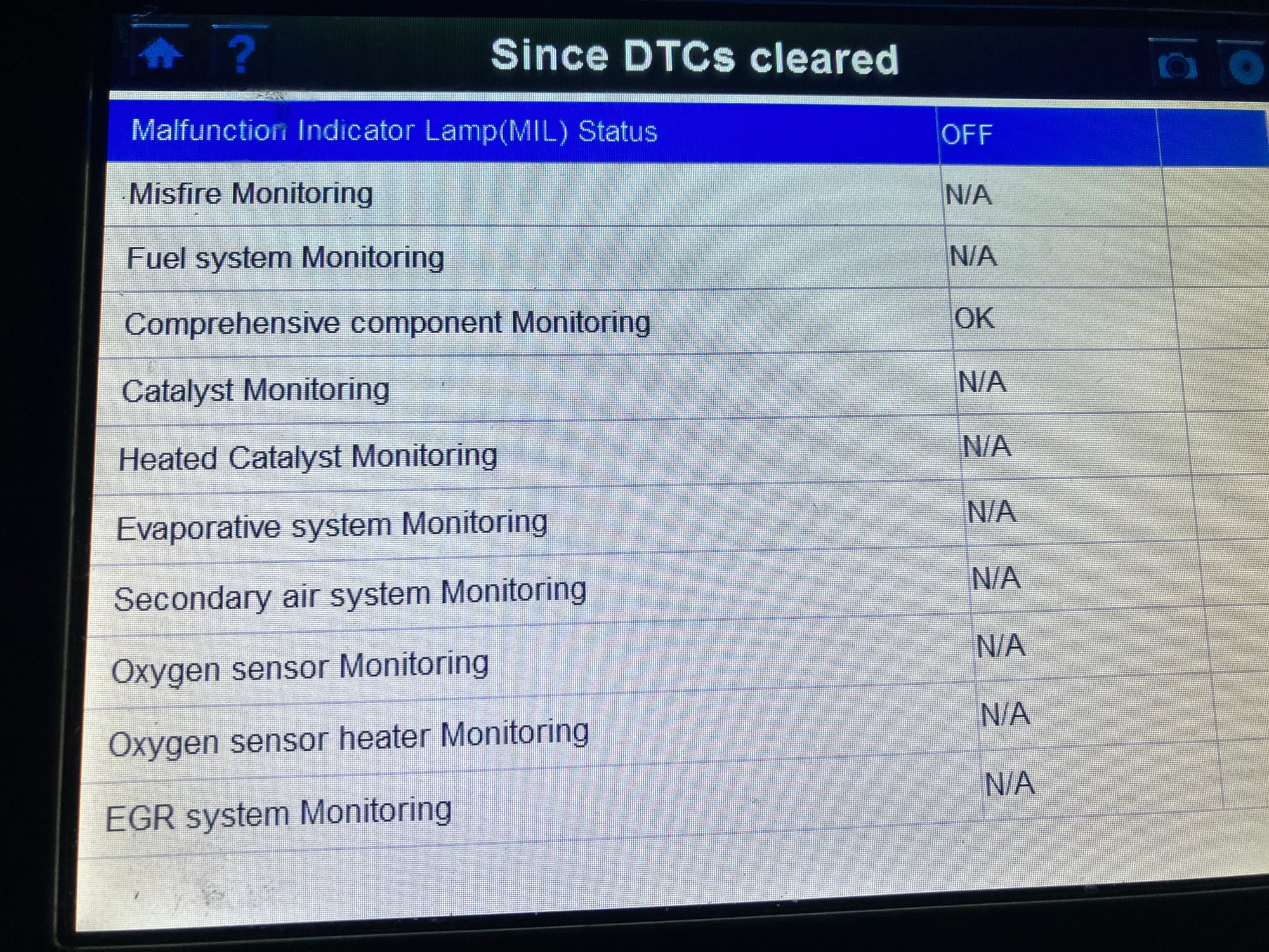

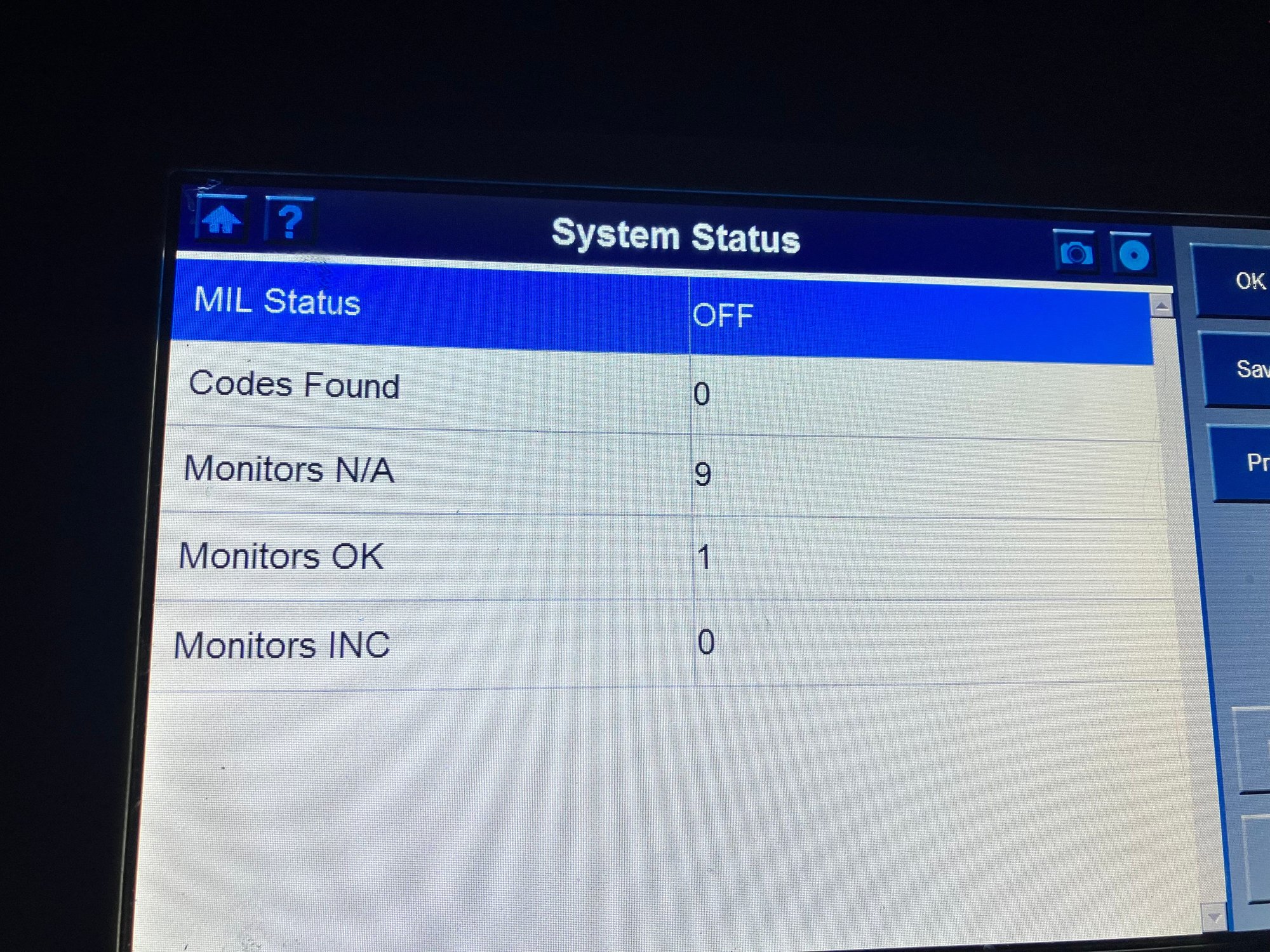

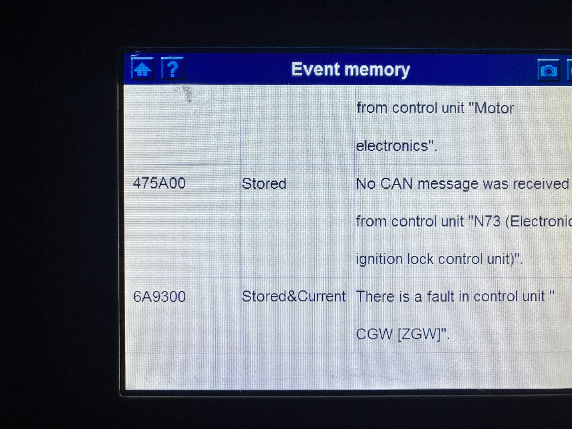

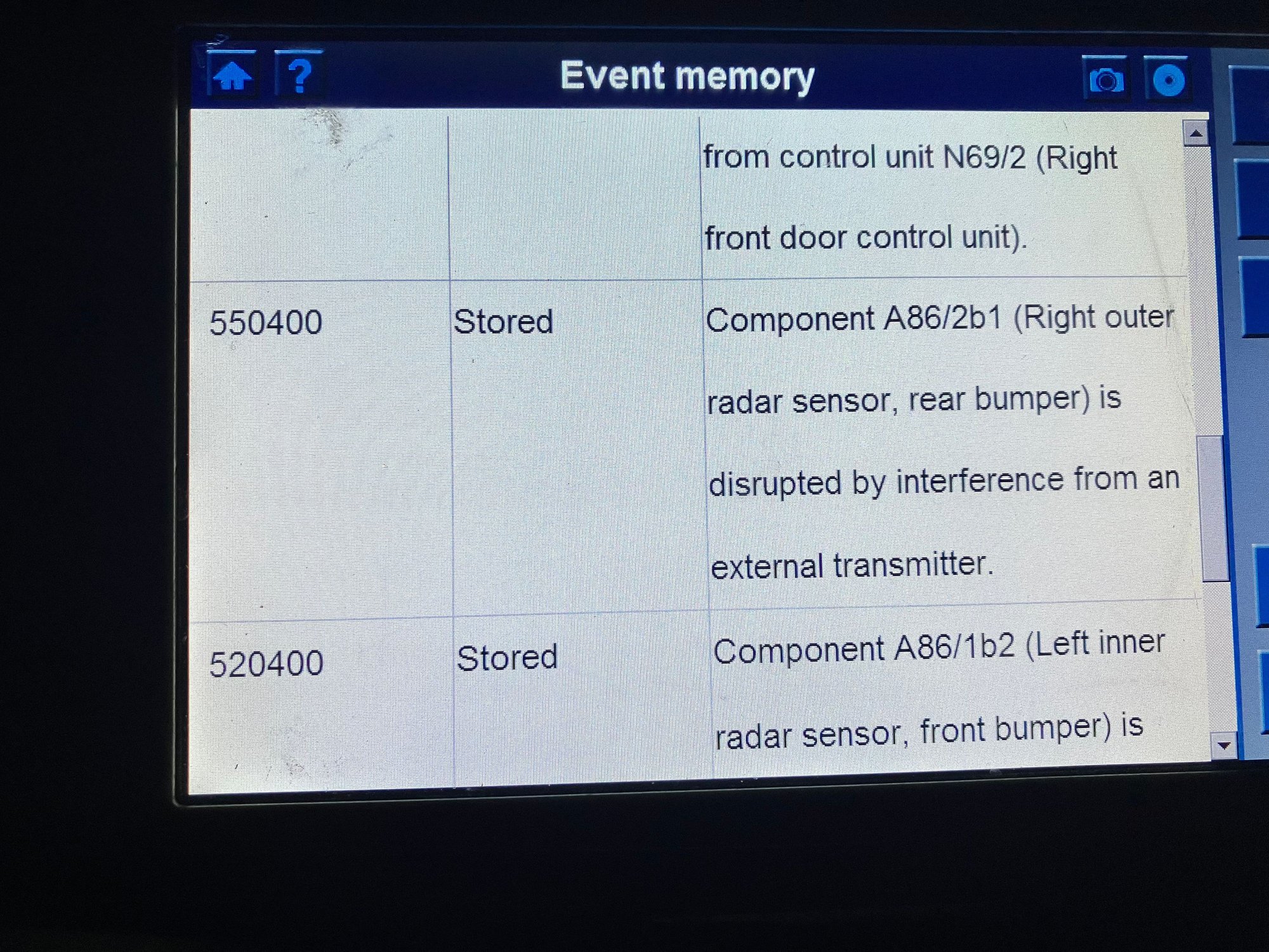

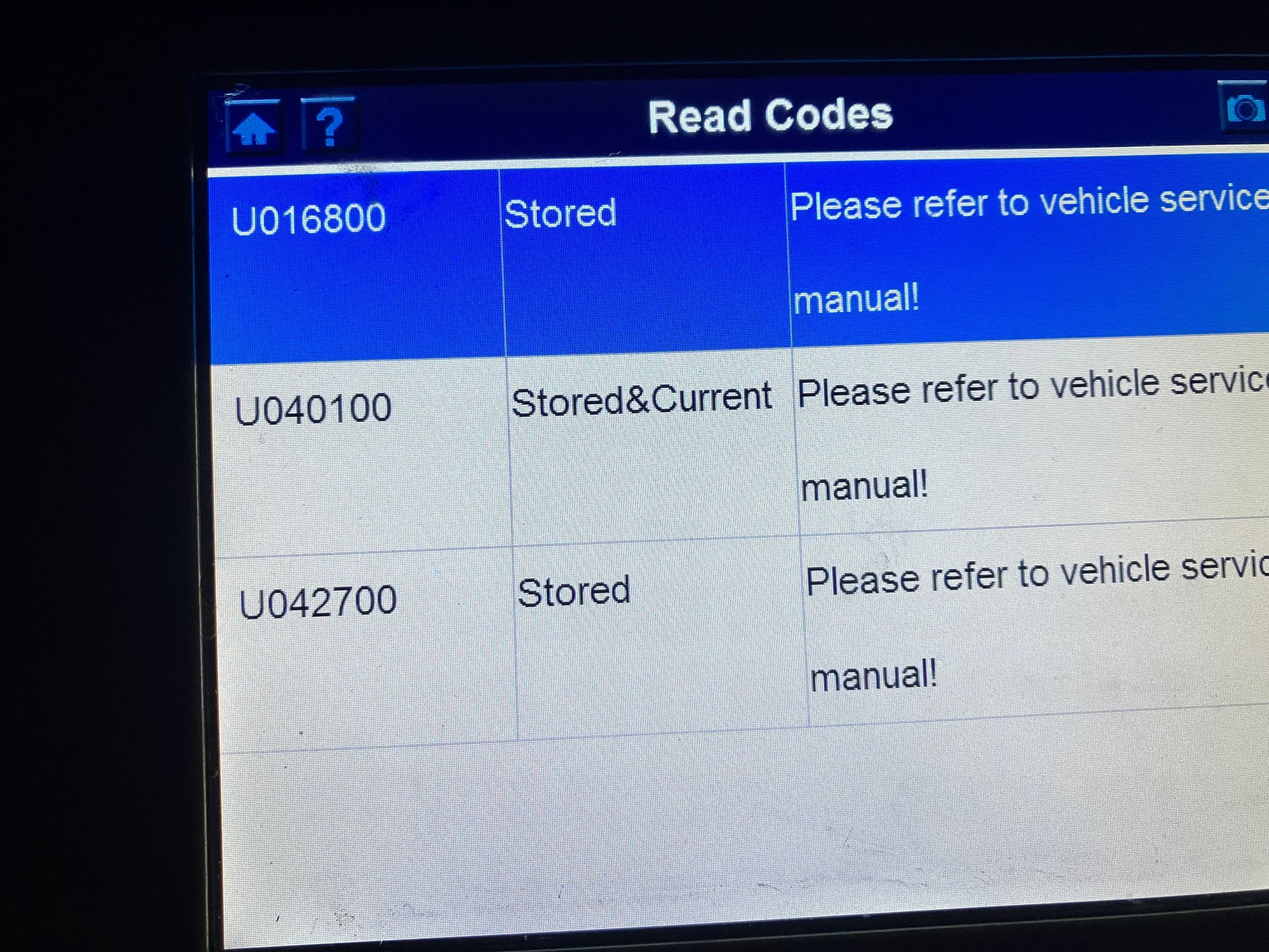

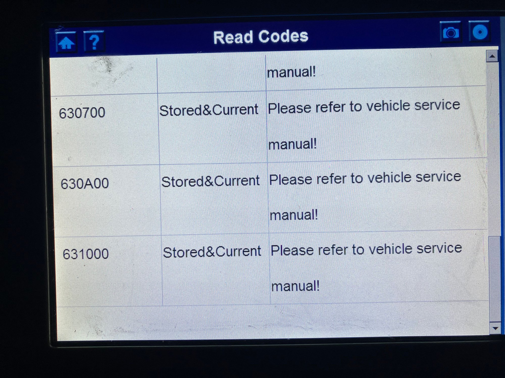

I've been super busy so I haven't had too much time to dig in just yet but I did reconnect my scanner today to brainstorm.
First, I noticed that all my monitors are n/a which I suppose makes sense due to the lack of communication with the modules. Also, I have a more detailed list of what my scanner is unable to communicate with.BODY
Keyless go
IBS
Airbag
Overhead control
Driver side sam
Rear sam
Trailer recognition
Xenon l&r
Battery mgt
Power electronics
Backup cam
CHASSIS
Chassis gateway
INFO
Sam
DRIVE
Trans
Parktronic
I'm going to remove the seats today to inspect under the floor. Does anyone have a detailed diagram of the different CAN locations, and/or any advice to better assist me? My knowledge is limited but my willingness to dig in and learn is huge, so any and all suggestions will be very much appreciated.
I'll be back.
Thank you
