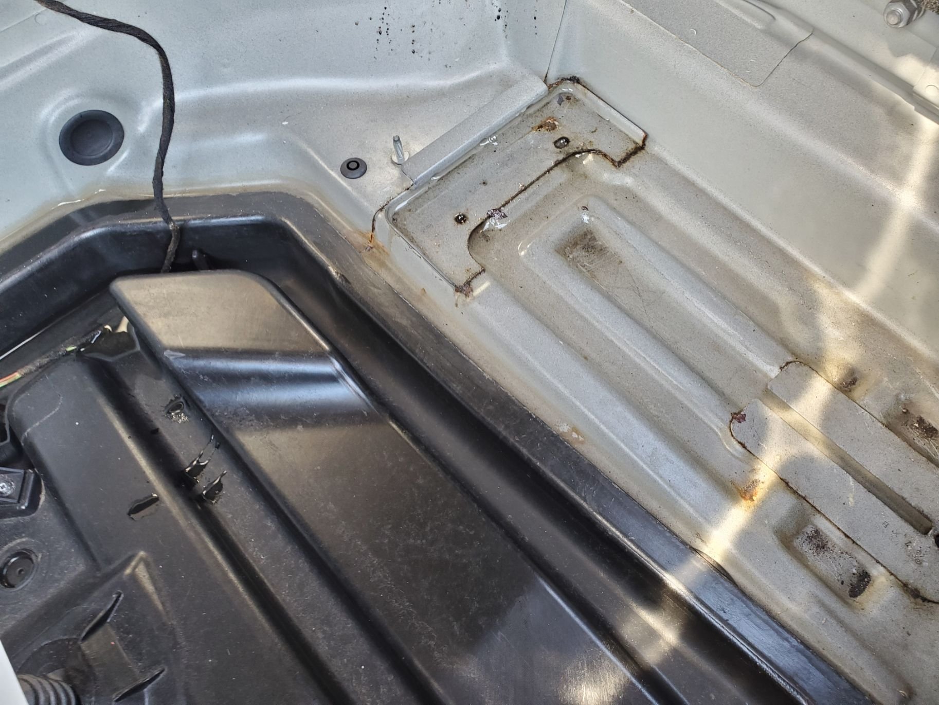

Red arrow shows a pin where water is seen coming out on the underside. Blue arrow shows the opening im talking about.
Im seeing water and debris coming out from around the pin. Also looks wet all around the areas marked in red.
Used a pipe cleaner to feel around back there. Pulled out alot of dirt and debris that was behind there.

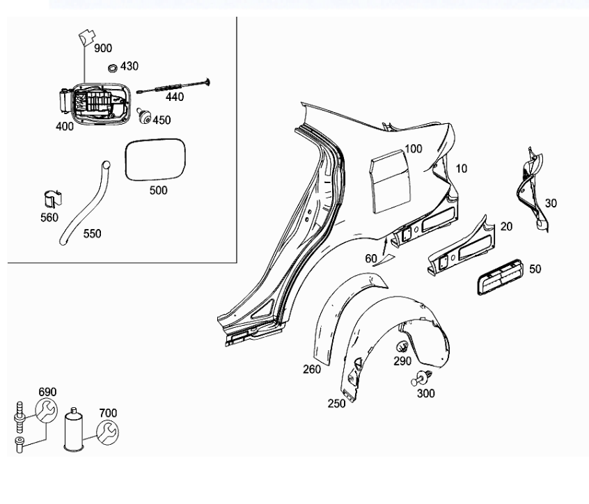

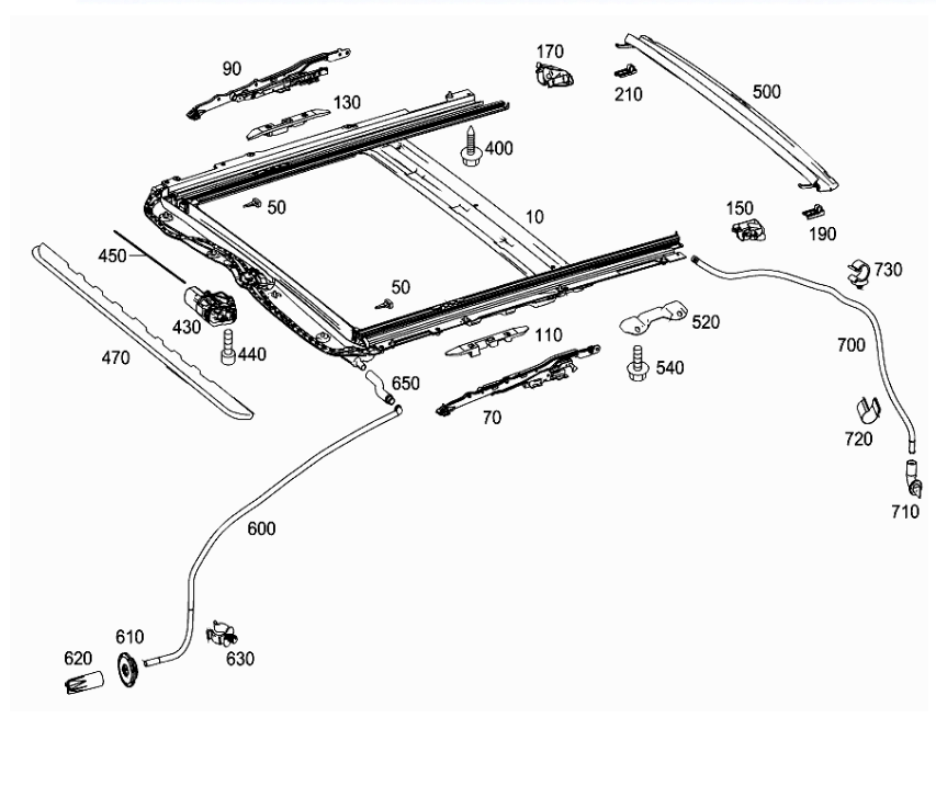

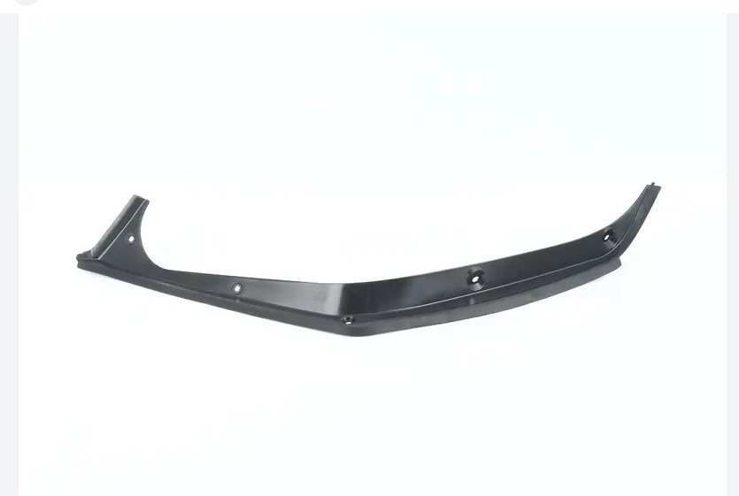

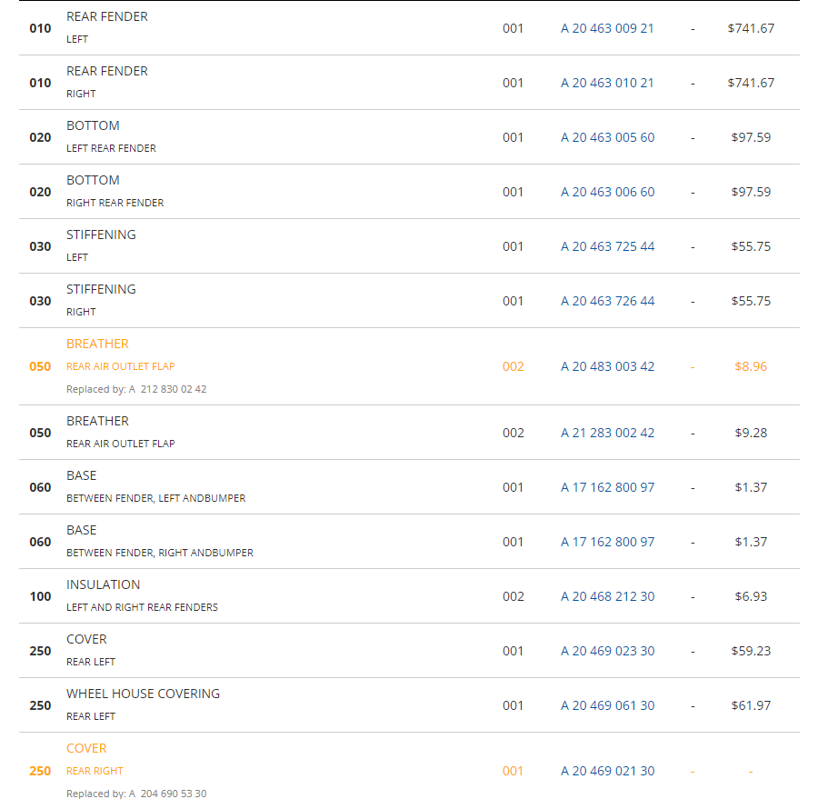

I looked up the parts diagram. Wanted to see how the trim fits. Trim is # 90.
Heres the trim piece.

Guess my next step is removing that trim piece and see whats underneath. Seems like an odd design. Last night I poured some water at that area and sure enough it disappeared behind that opening. I had a hand full of towels held up to the underside of that area and they got soaked.

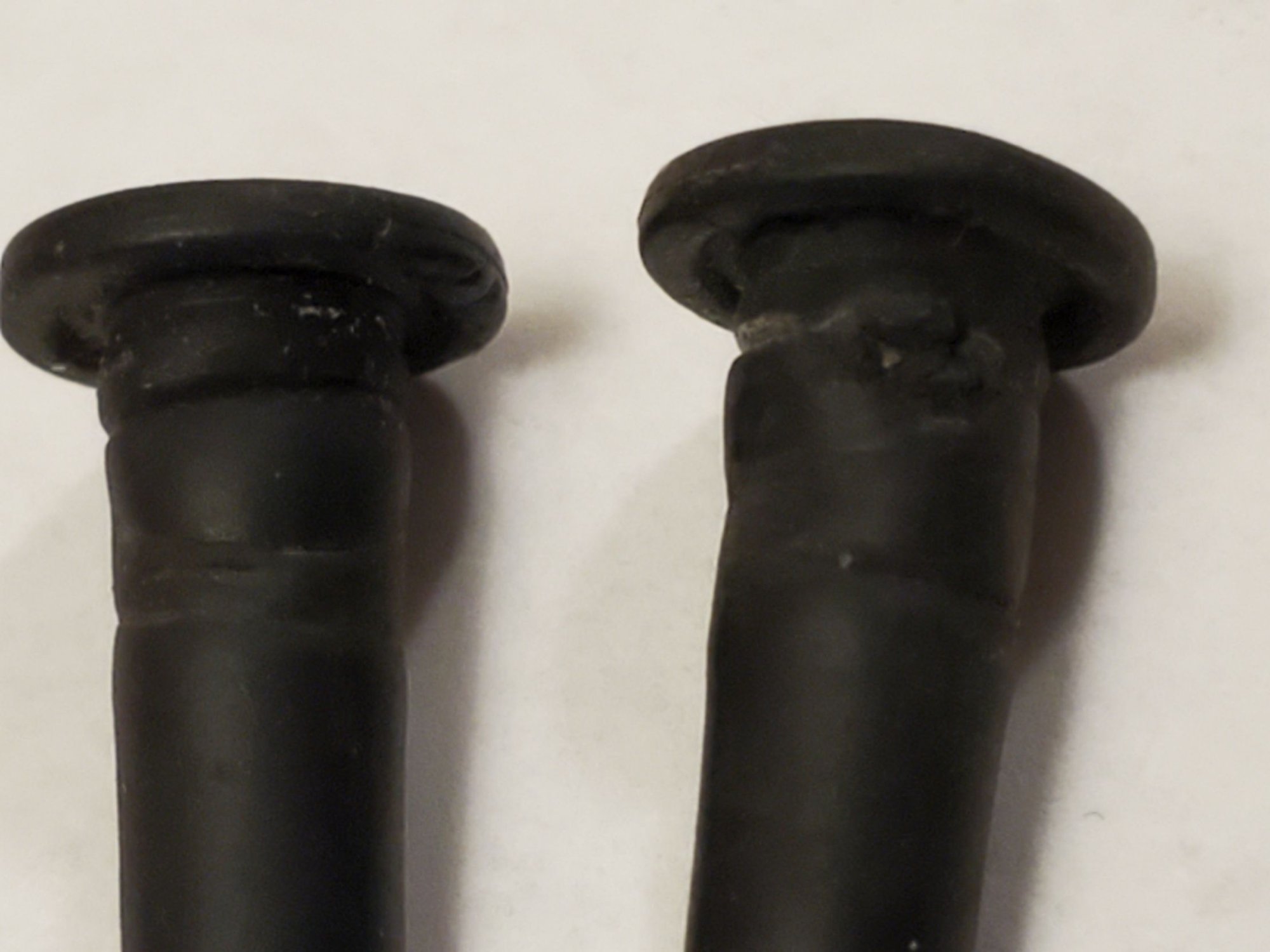

Started to remove the pins but noticed they were disintegrating, the round washer-type section was just falling apart. I think they might even be rubber type sleeves that are meant to seal the holes, but theres nothing left they fell apart? Plus its raining pretty hard and water was going down the open holes so stopped for now.
Im thinking at least ill remove the trim and clean everything up then throw some sealant in the holes when I put the pins back. Ill look for replacement pins while I'm at it.

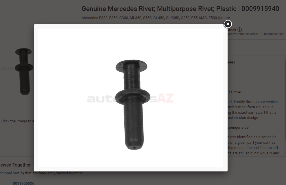

That was easy. Quick search of the part numbers and it does look like its two pieces. A rubber bottom that fits in the hole first then the plastic part that fits down in and must expand the rubber to seal the holes. Found them inexpensive on ebay.

The Mercedes brand pins are over $3 a piece so went with aftermarket. Need 10 pins to replace both sides. I got 20 in case they are used somewhere else. I went with this listing because they are one state away so figured id receive them quick.

I never saw these type of pins before or knew they existed. They do make sense if trying to seal a hole. Least expensive Genuine Mercedes brand pins I found is on eEuroparts, least expensive aftermarket was Alieexpress. Seeing that much water getting in my trunk has me paranoid something may happen so I want to try and fix it asap.

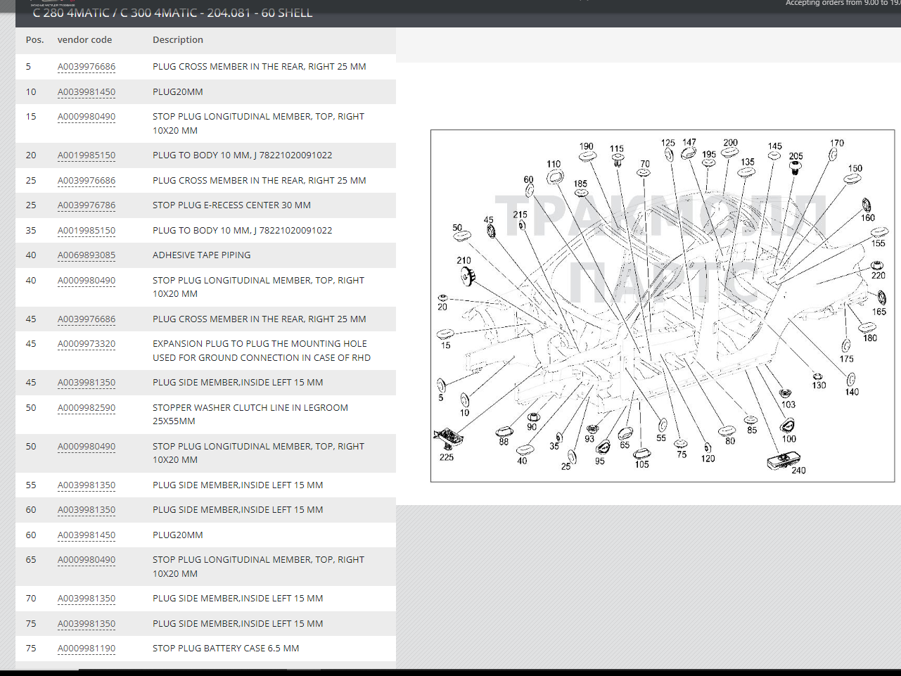

Looking around online it seems this issue with the leaky pins has already been documented, its good to see im not the only one and hopefully new pins should solve the issue.

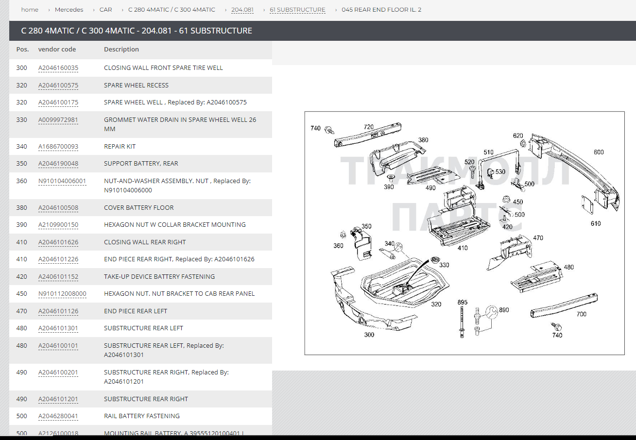

Looks like that is the grommet at that hole, meant to be open for some reason. Part 330.

I was under the car earlier and happen to notice that grommet. Guess its designed so water wont splash up. I never noticed that its just the spare tire tub showing on the underside, no other paneling installed.

Im thinking these pins fail by the trim cutting into them over time. The sleeves I was able to pull out had indents all around them and some were cut open.
Had alot of rain yesterday into today and when I checked the trunk it seemed dry so far. Install was pretty easy, flat head screw driver to pry up the heads of the old pins enough to grab them with a pair of pliers and yank them out. The new sleeves fit in the holes nicely, had to bang some of the insert pieces down with the end of my screw driver they were so tight.

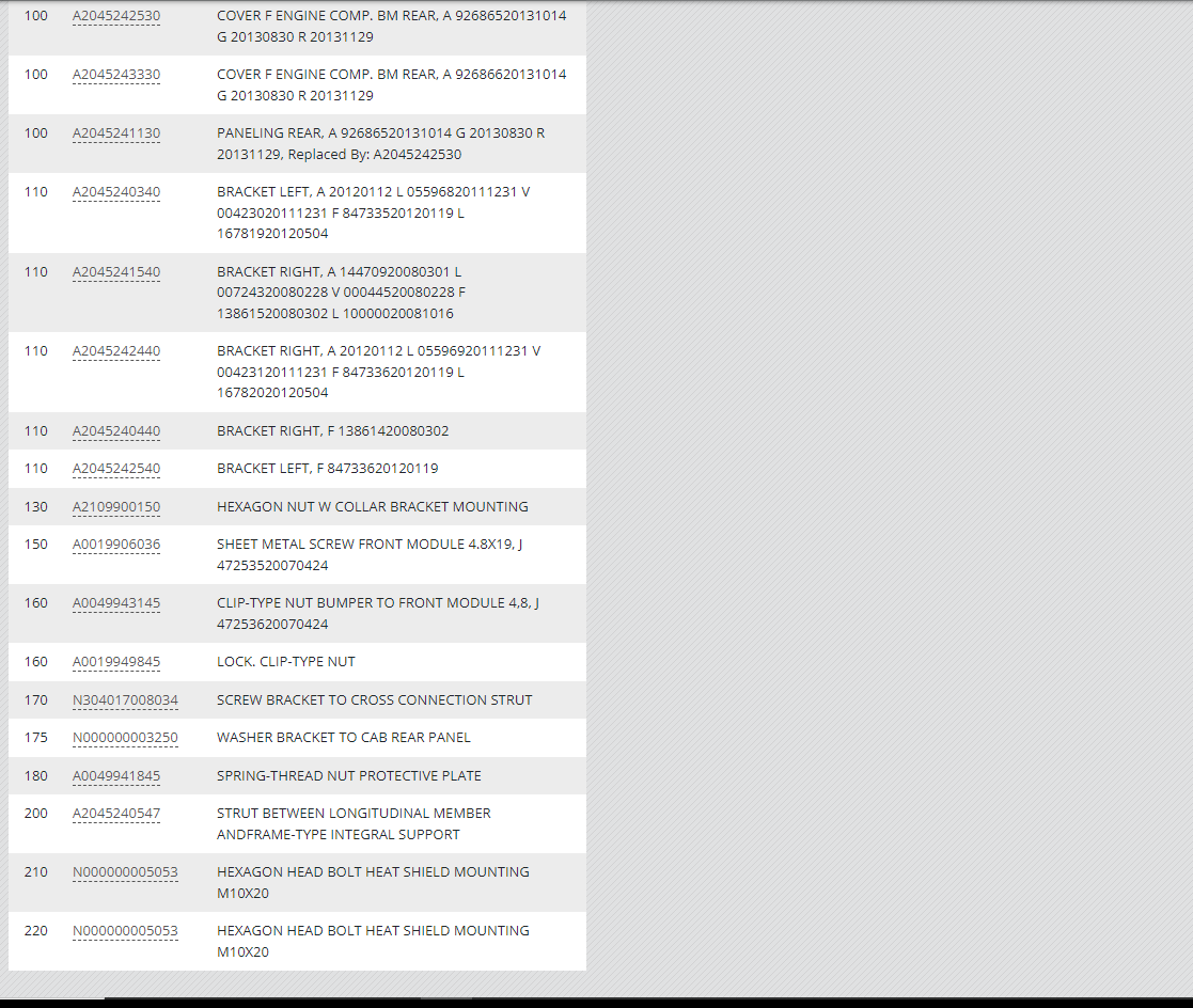

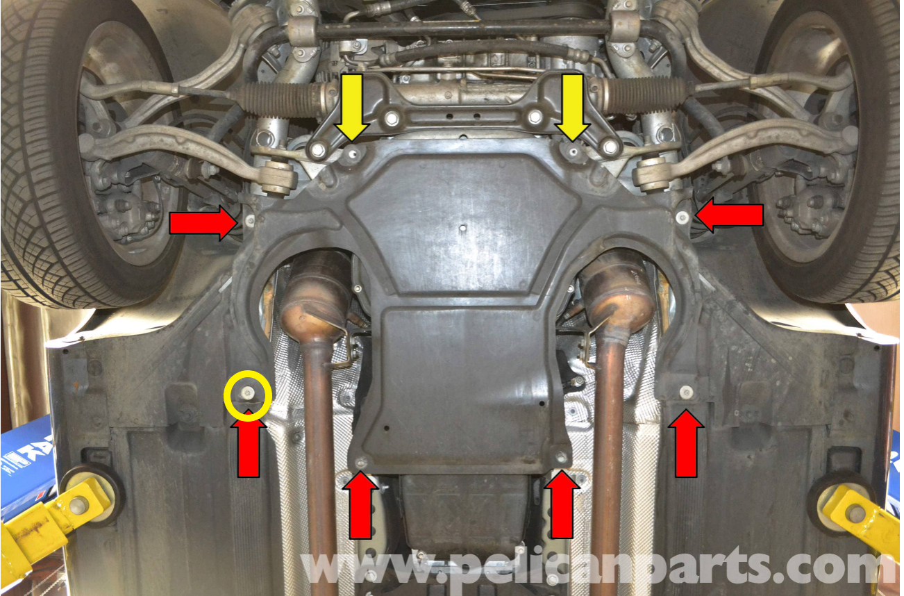

I also just received some screws for the undertray. Lately ive been hearing some type of banging on the front drivers side when going over bumps, I thought it may be the sway bar link worn again. Turns out a screw is missing in the under tray. Without the screw this section really flops around.
- Sheet metal screw 4.8X19 Part# 0019906036 Uses 8mm socket to install.
- Clip Part# 0049943145
Its the screw marked with the yellow circle.
Part 150 and 160.
I ordered aftermarket. I have read that these black painted screws may rust over time but they were much cheaper than the Mercedes screws. I think the Mercedes screws are around $3 each.

Parts diagram shows it as a breather. I'm guessing it could be to vent gas out from batteries that are mounted in the trunk, or maybe to let pressure out when you close the trunk lid, or just to let pressure out in general from using the hvac?
Inspect it. i believe it should work to let air out, not in.

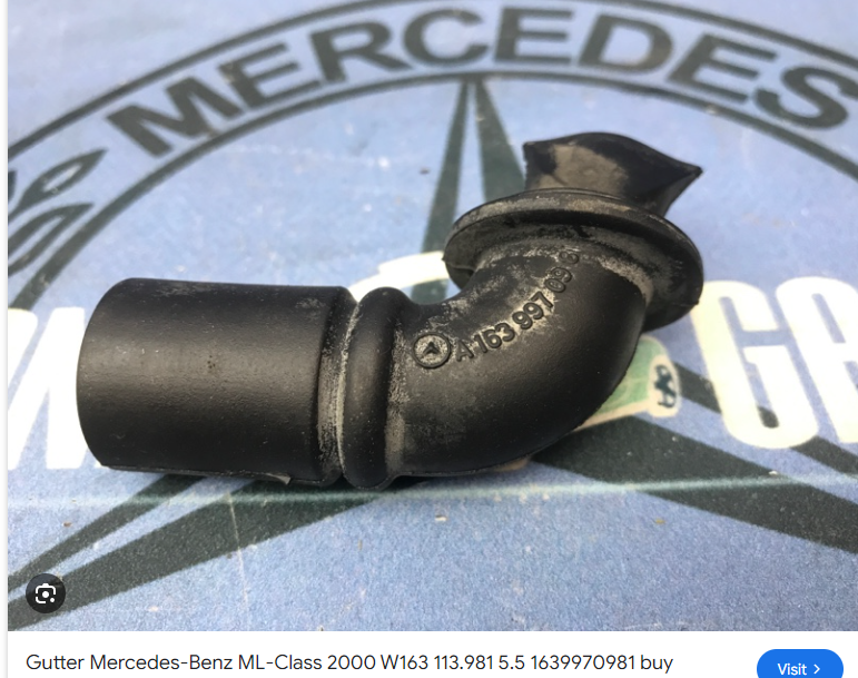

where 710 is where my leak is pooling up in that part behind the fabric I took that connected off 710 cleaned it and put it back in I’ve cleaned the breather I live in Oregon it’s rain season and I check and dry it out every morning the house is connected good to 710 I put it in I did notice 710s hole is like a slit not a round opening not sure if that could be it? I might have to take the trim off the electronic box there I think the sub is getting wet and the stereo is going in and out and sometime screeches now I’m stumped I poured a cup of water where the hose drains and it runs out the bottom bumper to the ground I can post some pictures when I get off work

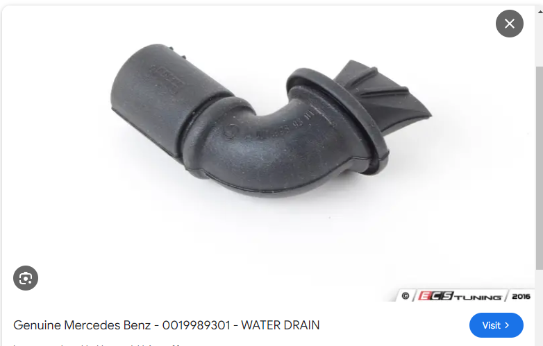

are you able to take a picture of the part 710 how’s the end look that the water drains out of mine is a slit and I don’t think it’s able to get out and does your back window have a seal on the sides mine doesn’t
Reply 0
Nov 19, 2024 | 04:24 PM
There is no seal around the rear window, just two thin ones at the top on each side. The edge of the glass is visible.
There are two part numbers for the 710 drains, an old and then an updated version though they look basically the same. There is a closed slit at the bottom.
Test each drain by pouring water down them slowly, see if they drain of if the back up. If they arent clogged and they are draining maybe there is an issue with the sunroof seal, not closing all they way or gaps?
Heres a link to the parts diagrams. Just click on your submodel: https://nemigaparts.com/cat_spares/epc/mercedes/1/204/
