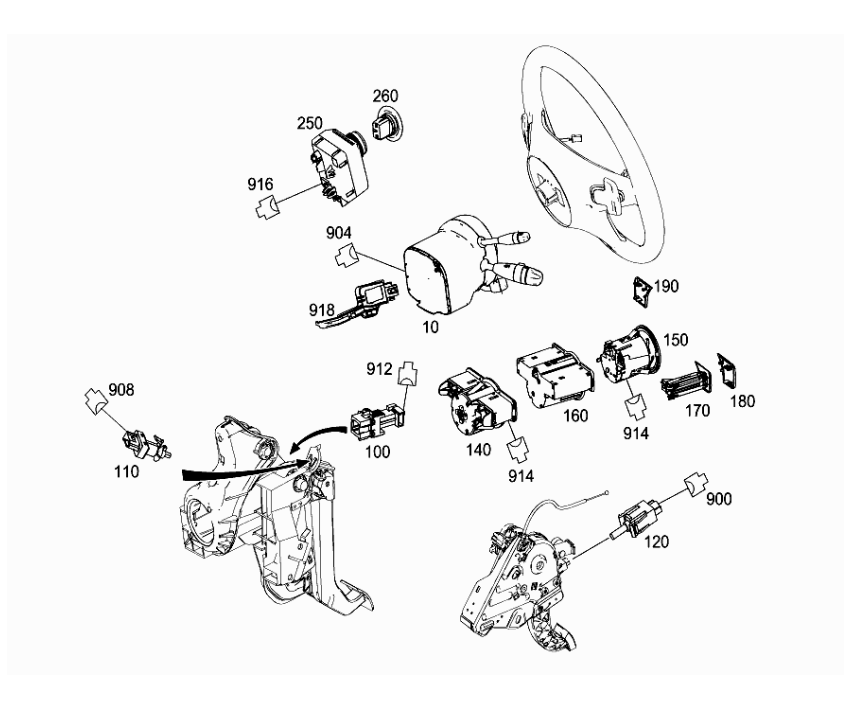

If its the brake lights coming on/off it may be a faulty brake light switch. Part# 100 in the diagram. Try cleaning the connection maybe.

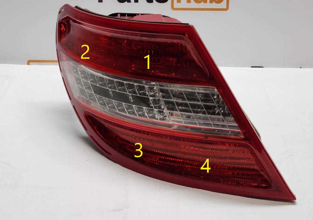

Which bulbs are lighting up when this happens? I marked up a photo of a drivers side tail light.

Ok. I have continued to monitor the car for the past week. Yes, the third brake light does work properly ( as do all the other lights that I can see). When the lights turn on, it is all 4 bulbs on both the driver and passenger side of the vehicle. It is only the rear tail lights that I have seen turn on, not the front.

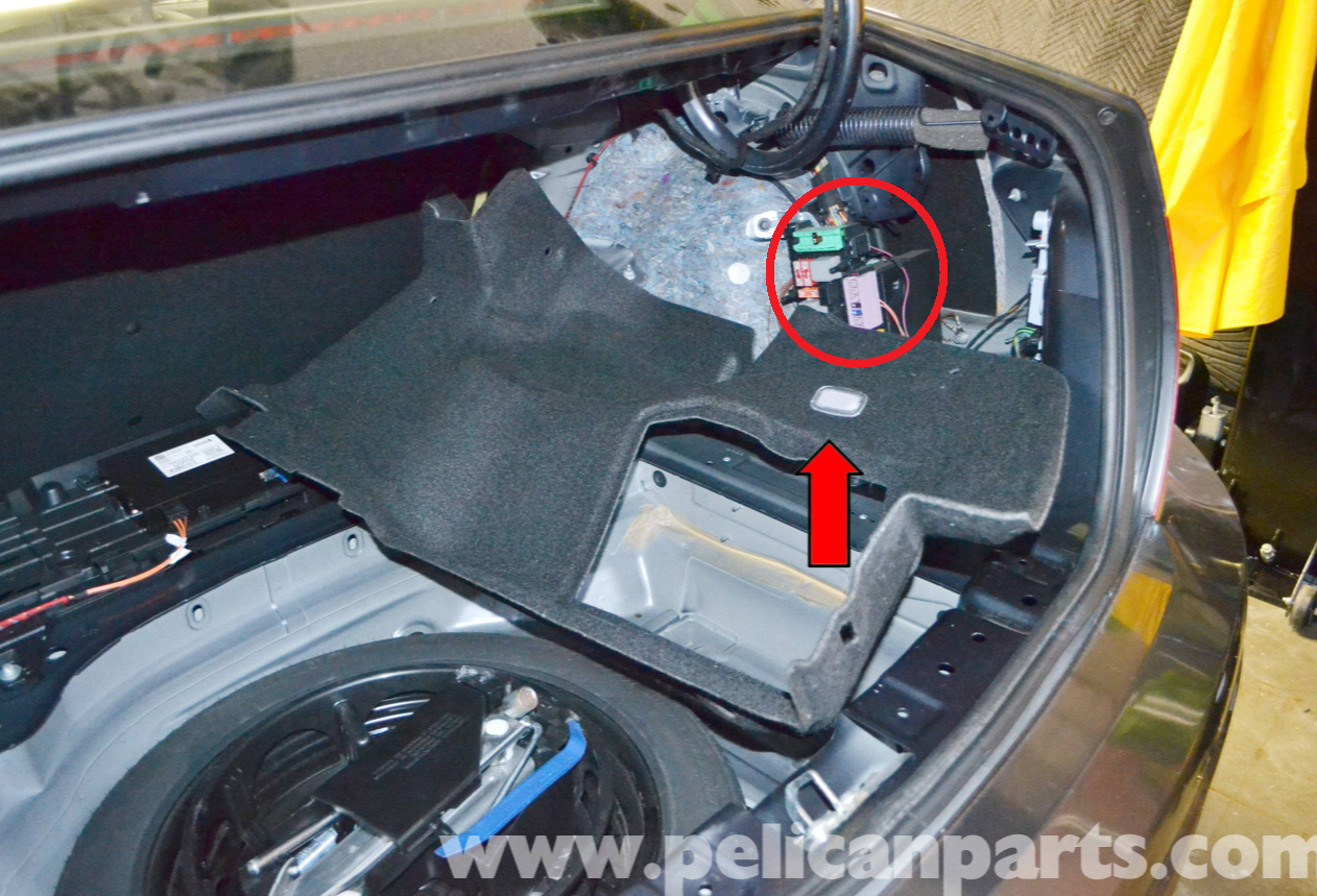

Im thinking either faulty light switch, or maybe an issue at the rear sam like water damage. Inspect the rear sam for any signs of water getting on it. The trunk trim has an issue with water leaking in at the fasteners and will leak right on the sam. I replaced all the fasteners in mine due to water getting in the trunk. Pull up the floor in the trunk and see if theres any water collecting on the floor below the spare tire.

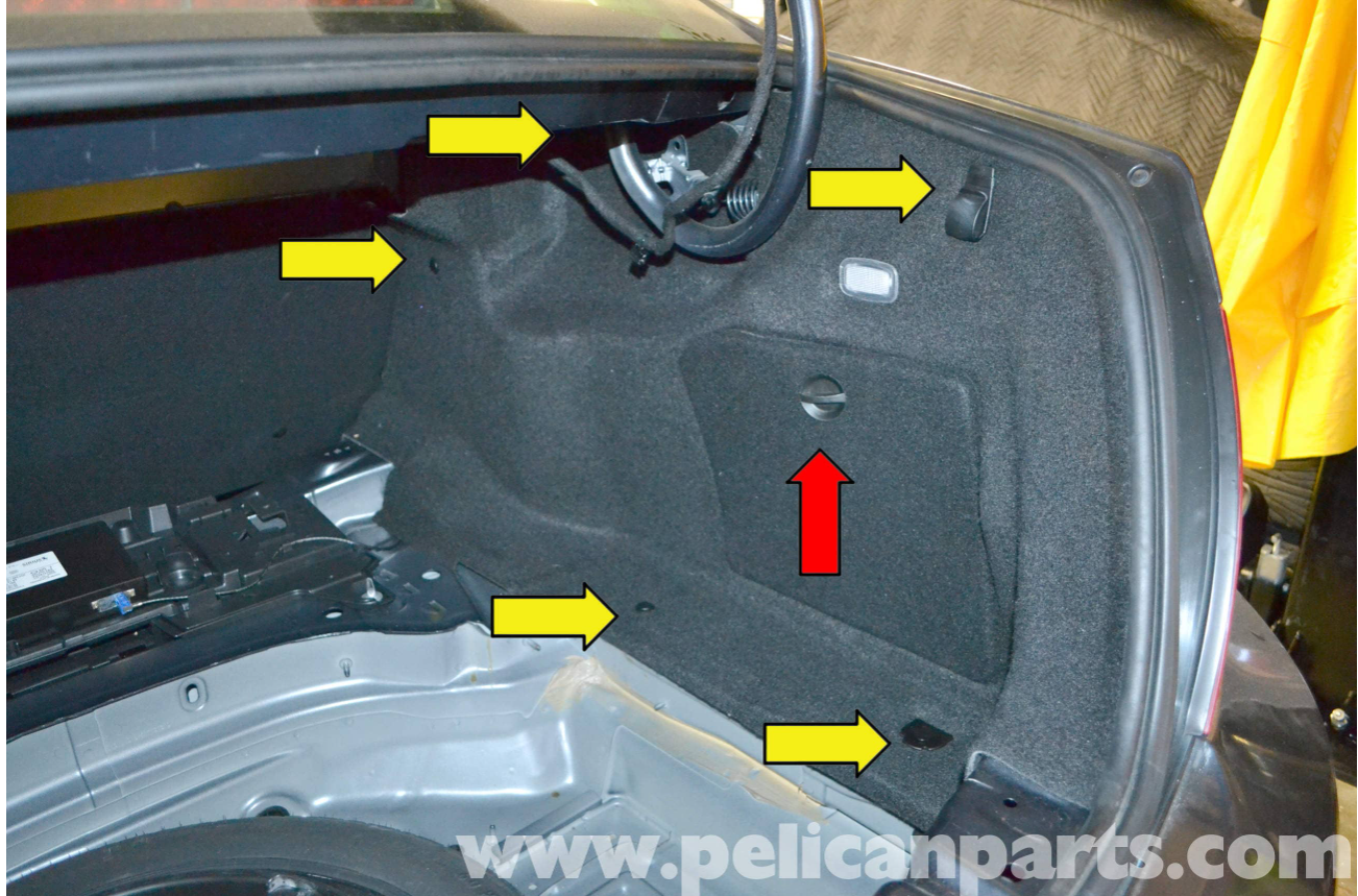

Rear sam is in the trunk behind the little door on the right side. Dont have to remove the entire panel to get to it, I just posted the photo to show it. Open the door and look all around with a flashlight for signs of water. In my searching for cause of tail light issues I came across a few where water leaking on the sam and caused some issues. The rubber on the trunk trim fasteners wear resulting in water getting thru, the sam is right below one of these fasteners. Can also check to see if water is getting in the trunk by removing the trunk floor and looking under the spare tire to see if there is any water collecting. My trunk trim was leaking and water was pooling under the spare tire. I replaced all the trim fasteners with new ones i picked up on eBay and so far it seemed to stop the leaks.

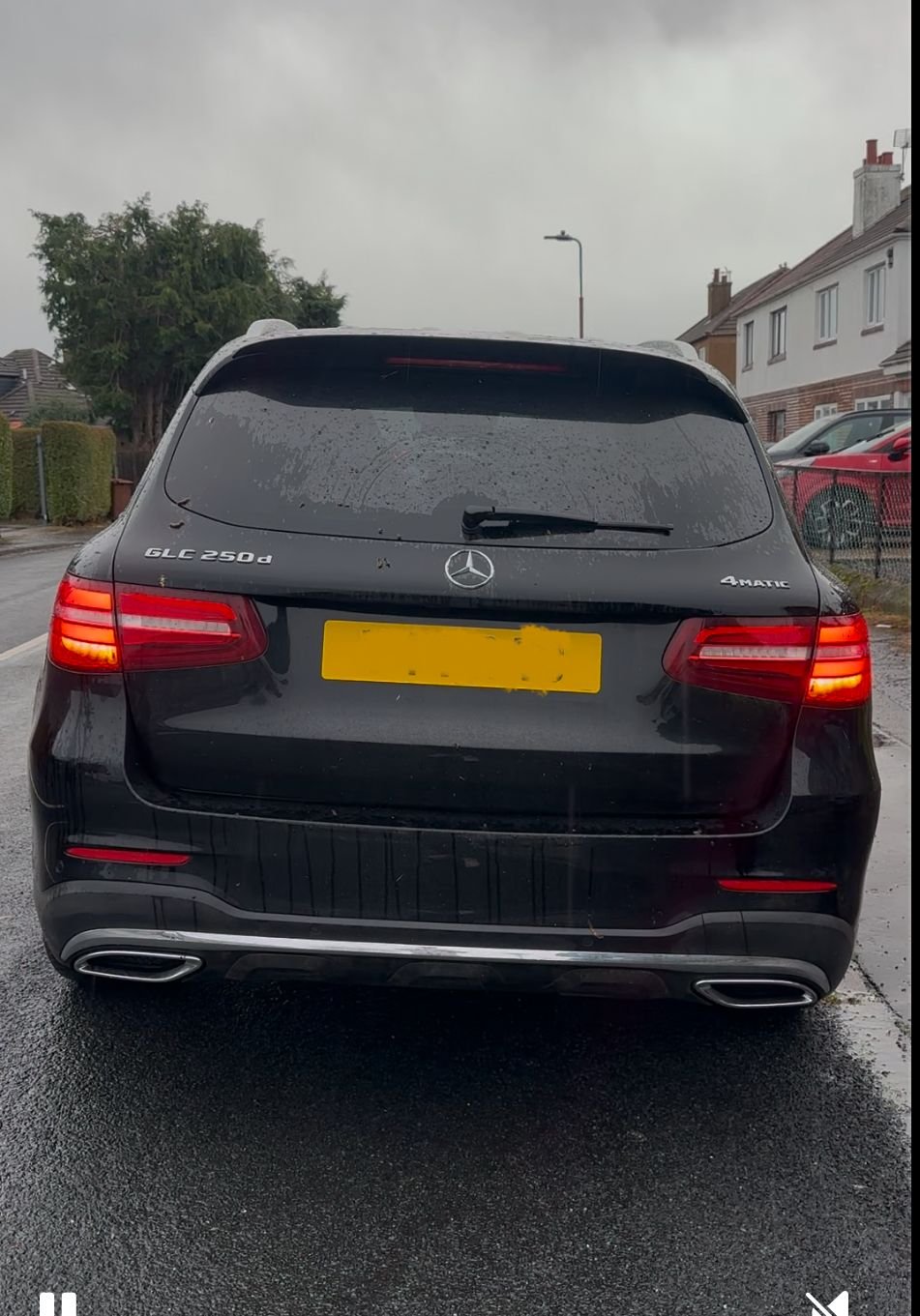

My car has done something very similar. Bottom of the passenger side rear lamp is ON while the front foglamp is on. It has happen with the headlamp switch on AUTO or on OFF.
If the switch is in park lamps, lamps are ON in the same manner.
