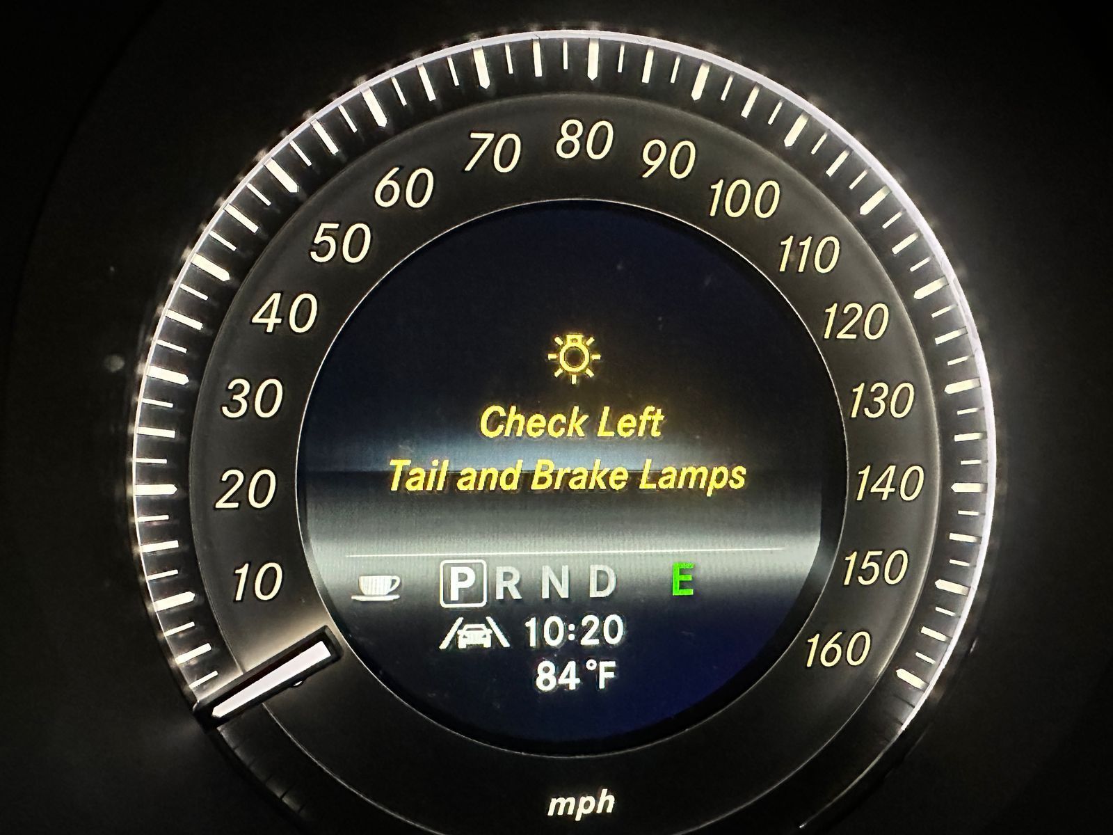

Are the lights LED's? There are 3 layers on the tailights the bottom the middle and the top which level is the tail and brake light? Can I replace without removing the entire tailight?
Are the lights LED's? There are 3 layers on the taillights the bottom the middle and the top which level is the tail and brake light? Can I replace without removing the entire taillight?
