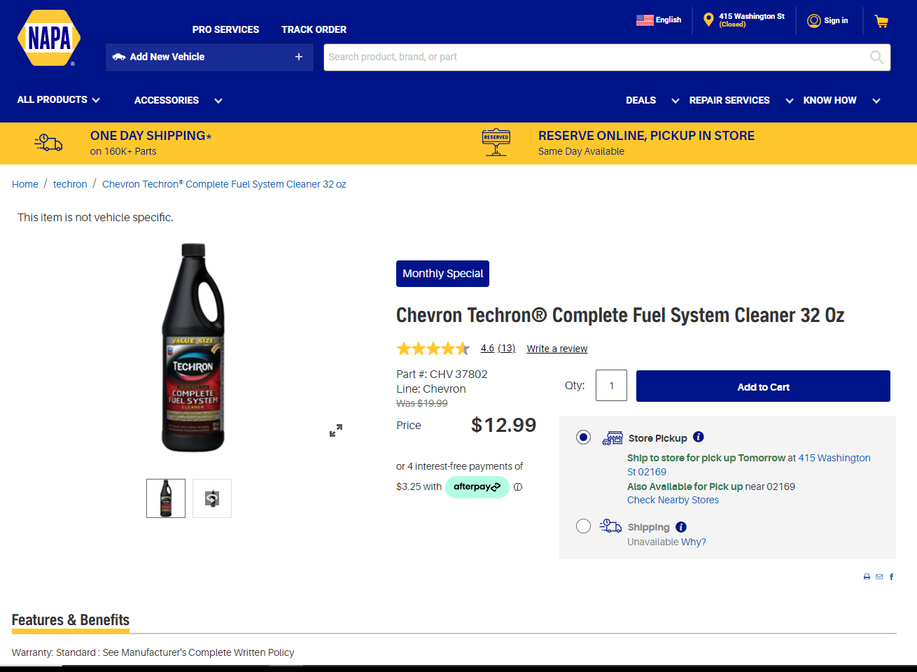

I have always used 87 in my previous cars and pretty sure that's what they recommended anyways. My Mercedes is the first car I noticed it says 91 or higher so I did alot of searching around for if its really needed, while I forget most of things I read i made the choice to only use 91 or higher. Around my area its mostly 87, 89 or 93 so I get 93. I dont really pay attention to gas prices and will get gas at any large gas station, except there is a Sunoco in the area i stopped at and they were charging around $1 more which I thought was nuts. I refuse to go there anymore. Theres also a small quick mart down the road i got gas at a few times and it seemed my car ran bad after filling up so I wont go there anymore either.
I like using Techron once in awhile. Been using it for years along with Seafoam. Ill use Seafoam in all my small engine gas containers and I think it does really keep the gas fresh, never had a gas related problem in any of my small engines. Techron ill add if I feel the car is running a little rough at stop lights, its not running horrible but more like a slightly noticeable rough idle. Seems I add the techron and the roughness goes away and I forget all about it. I pick up the big bottle on sale at Napa.
Gas wise, MB likes TopTier Gas certifed, costco is also an option if it is near you and would like to save, I personally go with shell, anyways, here are the gas stations certified by TopTier Gas: https://www.toptiergas.com/fuel-stations/

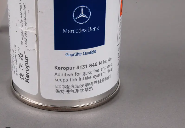

Interesting. I looked through the Operators Manual under Fuel Requirements and it only mentions using Premium unleaded gasoline. Under Gasoline additives it mentions MB "recommends only the use if quality gasoline containing additives that prevent the build-up of carbon deposits". The words Top Tier arent found.

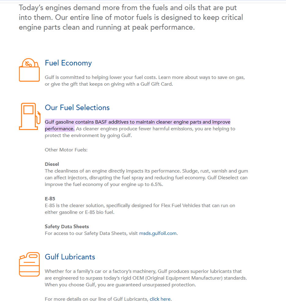

I had to check to see where i typically fill up, I knew it is a Cumberland Farms but just noticed it is Gulf Gas. That gas station is not shown on the Top Tier map though the Mobil I sometimes stop at is. I looked to see if Gulf is labeled as Top Tier and do not believe so. But on the Gulf webpage it mentions using BASF additives.

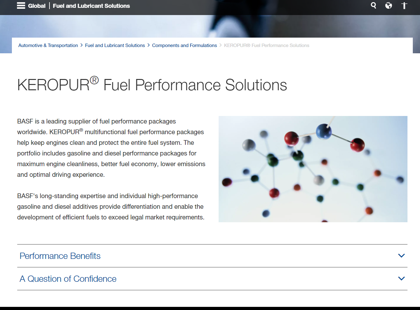

I look up BASF gas additives and see they make Keropur. No idea how to find out exactly what the additives are in Gulf gas though.
Old May 19, 2024 | 11:04 AM
  #43
W205C43PFL's Avatar
Posts: 33,395
Likes: 6,624
https://static.nhtsa.gov/odi/tsbs/20...38113-9999.pdf
The article states it is mentioned in the operator's manual, I wonder why it wasn't mentioned in yours, maybe they changed it at some point.
