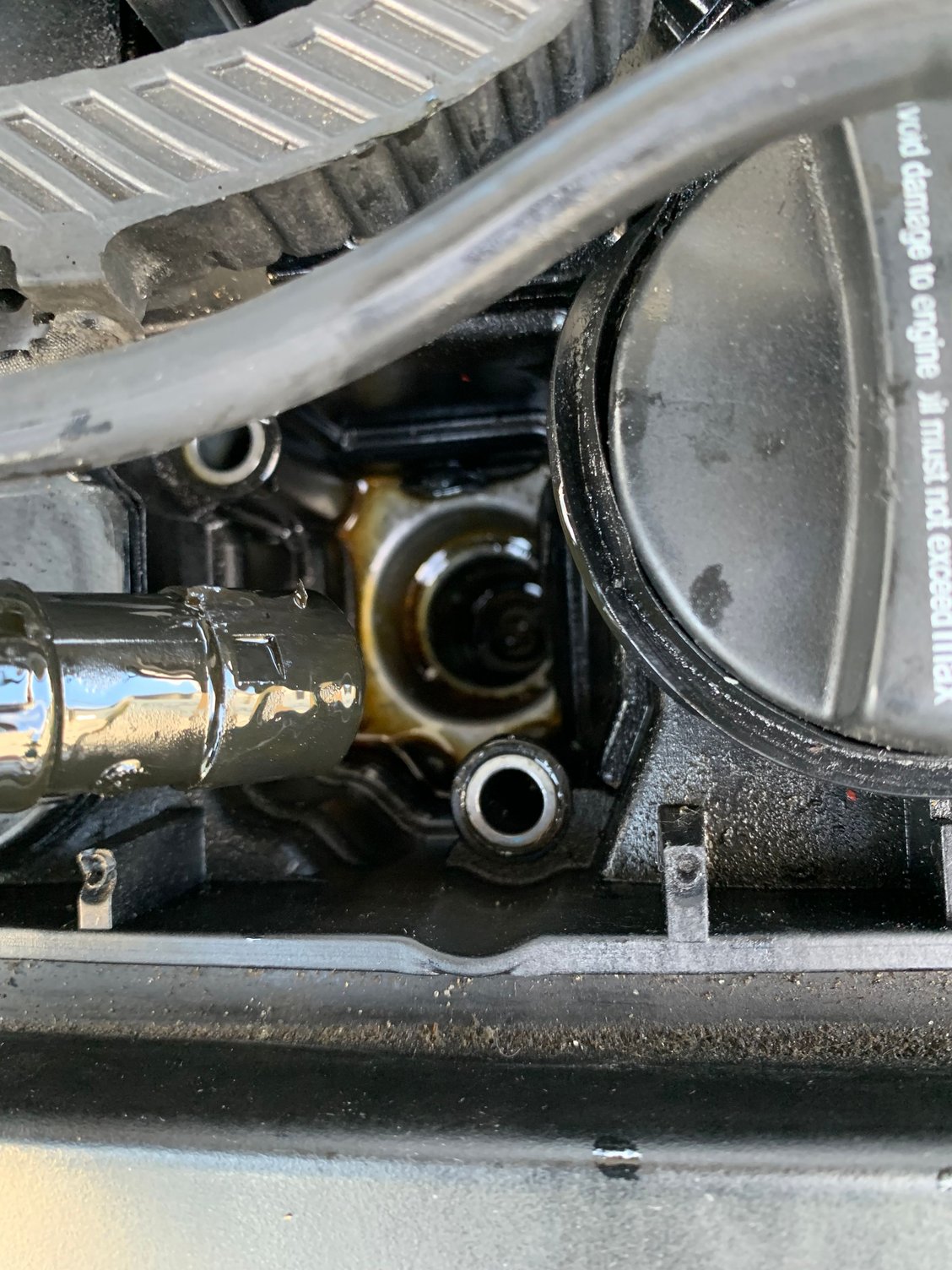

aside from that I realised that the there was oil in the ecu + connectors, not a lot but it was you could see shiney oil residue. I cleaned it with some electrical cleaner but need to go over again because I didn’t want to bend the pins and these still some in the gaps.
checked the camshaft sensors and yep they were oily and a couple drips came out on release, magnets are oily, and a few of the other connectors are oily. Not leaking bad but glazed. I noticed around the back of the engine is covered in oil, any idea what this is? I’m hearing it can be a rear seal?.

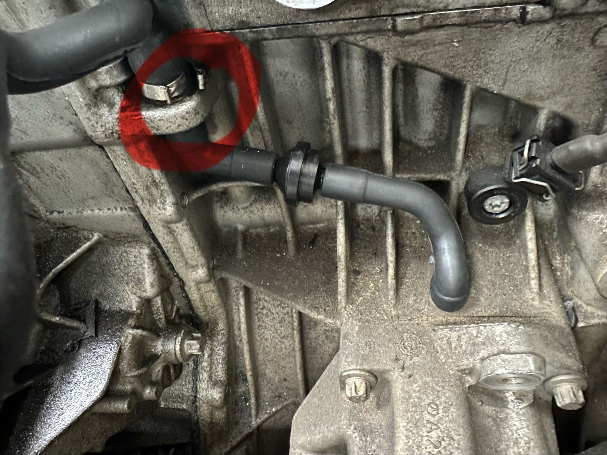

I changed breather hoses and valve got the clip (in red circle) to clip back on with some angled needle nose pliers.

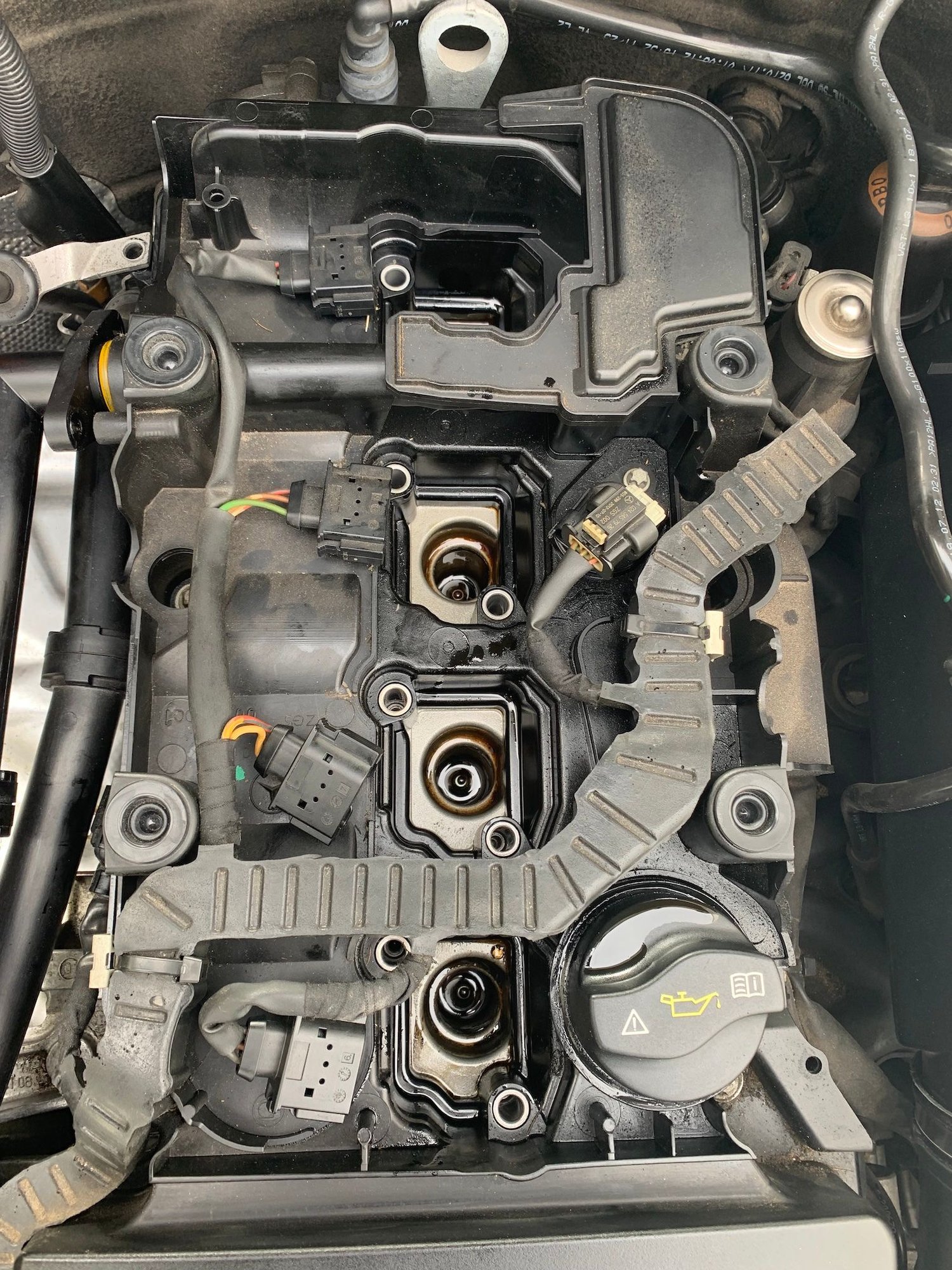

It’s when I changed the rocker cover gasket that I saw a lot of oil in cylinder one and a bit in cylinder 2 and the gasket for cylinder 1 was definitely not doing the job.
I used a fluid extractor to get nearly all of the oil I could reach around the plug. I had to take the spark plug out to get the rest clean and I noticed there were bits of gasket around,
I managed to get them all out except on the last cylinder a piece of the rubber gasket (roughly the size of a fingernail clipping) dropped in the hole.
I looked online and most ppl said it should burn off of blow out the exhaust, some said remove the head and go get it out. Any advice?
The rocker cover itself has a little bent part of the plastic at the back where the majority of the leak seems to have taken place. Thinking a replacement might be needed but for now I’m going to see if the new gasket and some gasket maker should lock it in.
Overall at this point think the oil leaking from valve cover and through magnets, and in cylinder is the root. Which Caused oil to get everywhere and contaminate the o2 sensor. Once I’m sure the oil is out of the wires harness and all leaks are sorted I will change the o2 sensor - I’m hoping it’s all good after that. If not I’m thinking possibly injectors. Will change plugs and boots and then give it a run to get the data from mb scan tool. Thanks for the advice!

Oil in the spark plug holes is a typical issue with the M271 engine. My engine was similar to your pictures. New gaskets fixed the problem. Usually, the oil doesn't enter the combustion chambers since the spark plugs are in the way, but I suppose oil could seep around the threads. I had no ignition or running issues, and the spark plugs were bone dry when removed. ​​​​

Blow compressed air into the cylinder to try and blow the gasket piece out. Or try and suck it out with a shop vac, can even use a piece of hose that fits in the hole and duct tape it to the nozzle of the shop vac.
1 cylinder spark plug was soaked and 2nd had a little oil. But the rocker/valve cover gasket was done for so that explains it.
