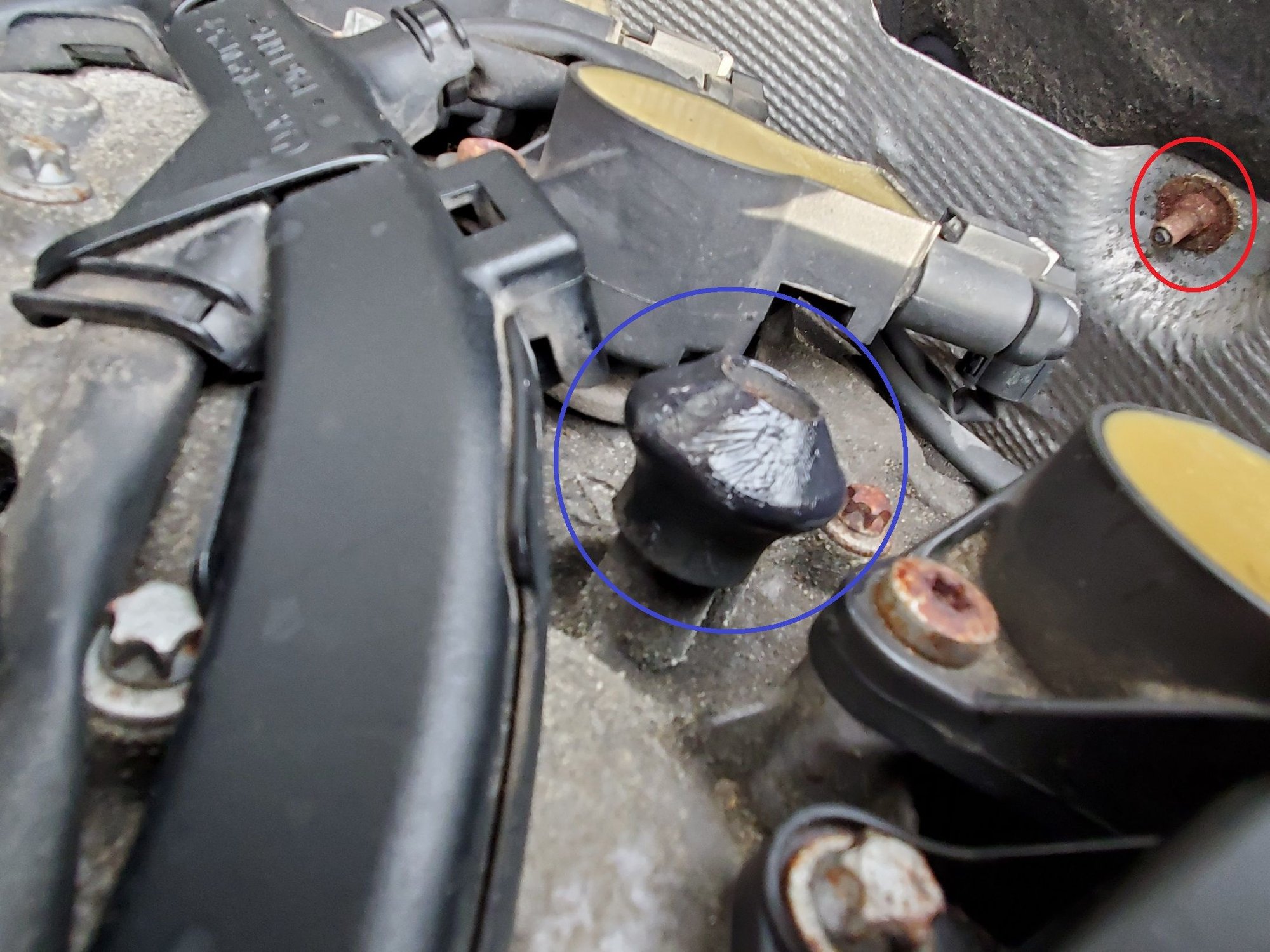

Just when I start feeling better I find another horrible sign of what that hack shop did. I was cleaning the metal shields, guess they are called 'screening plates, and noticed one of the bolt holes is torn all around, looking closer I can tell they must have used a screwdriver on it to hammer it off without removing the bolt holding it on. Its fresh since I can see clean metal at the marks so it wasnt done previously at some point. Now i'm worried whatever it was bolted to may be damaged, is it bolted to the front diff probably?
They must have unbolted the first two bolts which I was able to see when under the car, they couldnt get to the last bolt so they hammered it off.

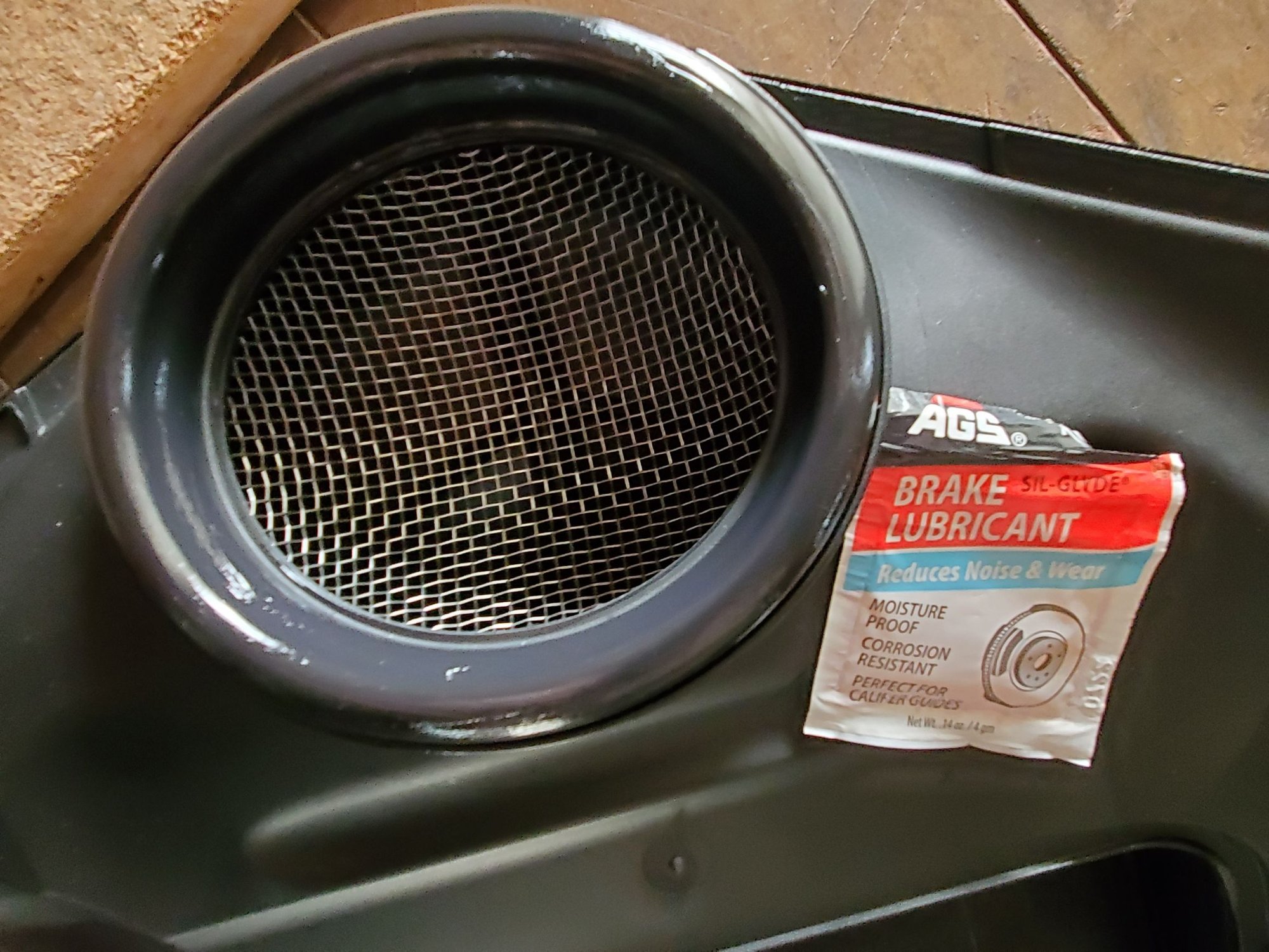

Least I got the air box squared away. With the missing clip like i was saying earlier the air box wasnt lining up with the maf, id have to reach down and pull up on the maf to get it to seat. Installed the clip and its installing perfectly again. I put a little bit of Sil-Glyde on the mounts and around the seal so it slides in nicely.
