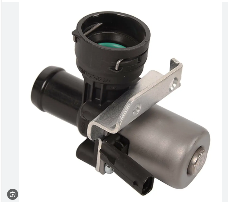

I dont have that engine but was looking around to see how that joint is sealed, looks like there is an o-ring inside the valve. Wonder if that o-ring is worn and is what is making it leak. May be able to find a replacement, though nothing is shown in the parts diagram to order one. The plastic pipe doesnt look like there is any type of o-ring/seal on it.
I would try disconecting that pipe and inspect the o-ring. May be able to get away with cleaning it and putting it back together. Maybe the connection just backed away a little, reseating it may fix the leak. One of my floor jacks was leaking jack oil from the plunger, I took it apart and was going to install a new o-ring I bought but it was the wrong size, so put everything back together and now its not even leaking, maybe reseating everything fixed it, at least for now.
Can see the o-ring in green in a photo of the valve I found online:

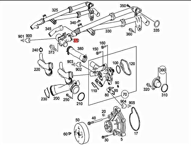

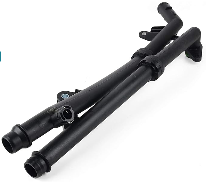

Dry off and clean the area around the part you replaced. Look for hairline cracks in the plastic pipes, especially the seams (second picture in TimC300's post #3). Check with the engine running and full heat inside the car. The coolant system is pressurized when the engine is running and leaks are easier to locate. Sprinkle a little baking soda or baby powder under the parts you suspect are leaking and the coolant will cause the powder to clump.
