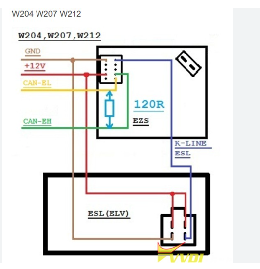

It appears my ESL has died in the unlocked position. I was able to get it out of the car. Pulled it apart and installed a new motor (thinking motor was shot). Re-connected ESL to the Harness and still not working - no clicking, no buzzing, no motion on the lock. I have tried searching for pin out for the connector so I can check for power at the ESL. Does anyone know what the pin configuration is for the ESL plug?
I am OK with getting an emulator, but want to verify power to the ESL first.

When I search "Mercedes W204 ESL wiring diagram" this came up:

Thank you everyone. The diagram and other info was very helpful. I have decided to go the emulator route. Pulled ignition and key, and overnight shipped to vendor. I will post update when unit comes back.
