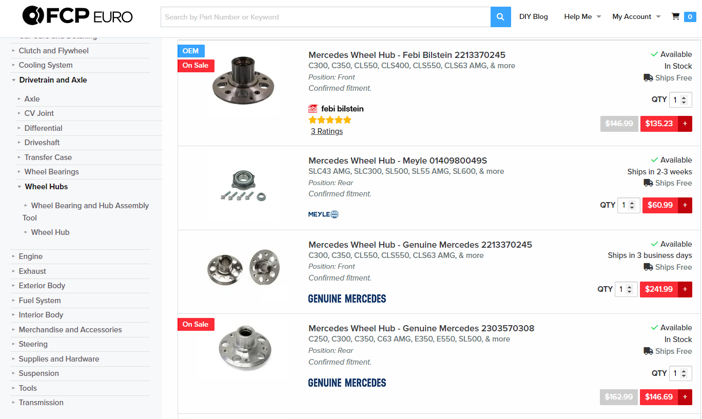

FCP https://www.fcpeuro.com/Mercedes~Ben...&b=5&d=1043&v= is good.
Sometimes FCP doesnt have the part I want or my local MB parts dept is cheaper.

Without know your vin i cant check for the specific parts.

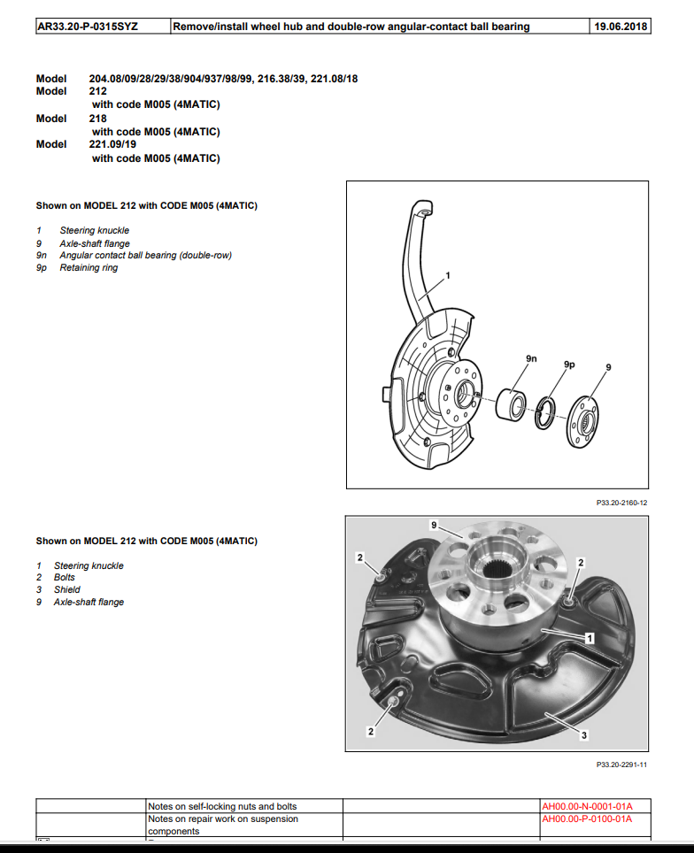

That bearing kit you posted looks like its for a RWD model. The front wheel bearings for a 4matic are sealed, like the one below listed for my 2010 4matic:
Old Aug 22, 2024 | 03:09 PM
TimC300's Avatar
Joined: Aug 2023
Posts: 3,689
Likes: 1,110
From: MA Coast
heres the parts diagram for my 2010 4matic sport. 204.081
my VIN WDDGF8BB5BR178761
I believe the bearings might be wrong now that I look at it lol . It should look similar to yours . I believe these are the ones

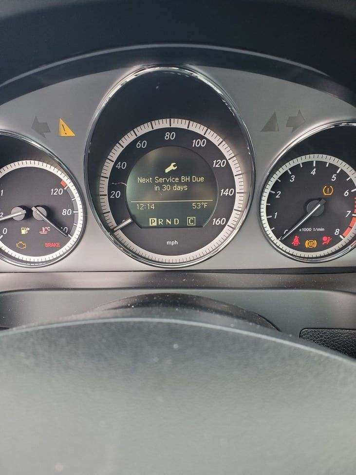

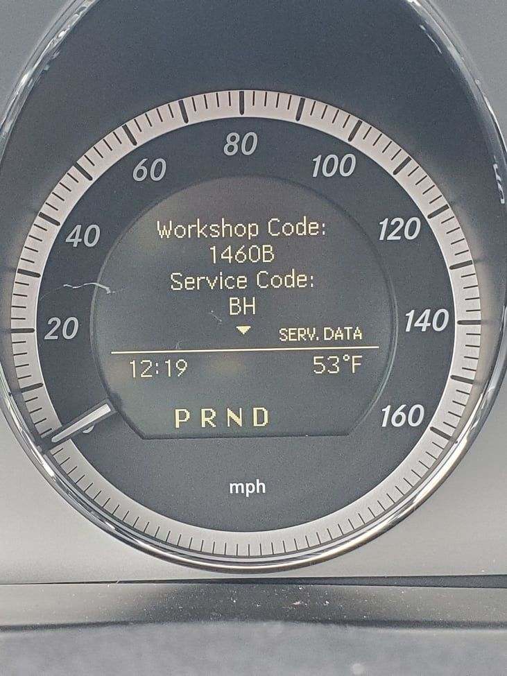

thank you ! Also since this is my first MB . What does “Service A “ and “service b “ require ? I was doing research and it’s kinda all over the place . But the same concept . I just want to know the right order to do it.

You should have an Operators manual in the glove box, along with it should be a Maintenance manual. It lists all the things that should be done by age/mileage. Just go thru it and make sure everything has been done.
Service A (every 10,000 miles) is basically an oil change and then visually inspecting fluids.
Service B (every 20,000 miles) is an oil change, replace brake fluid, replace cabin filter and then visually inspect fluids.
Replace air filter every 4yrs/40,000 miles.
I think for your transmission its every 4/yrs/40,000 miles for trans fluid and filter. I could be wrong.
Just look in the manual and make sure everything is up to date. Yours is 13yrs, or go with the mileage if its over 130,000 miles.
The car will also tell you which services it wants done. I'll use mine as an example. On the dash it was showing "Service BH Due". Go into ASSYST PLUS menu and it will list all the services. It listed Service 2, 3, 11 and 13. Looking on the chart that is Service B, oil and filter, fuel filter and coolant flush. These services made sense because my car had turned 150,000 miles and these services were listed in the Maintenance manual.
After you do the recommended work you will go into the ASSYST PLUS menu and reset the service reminder.

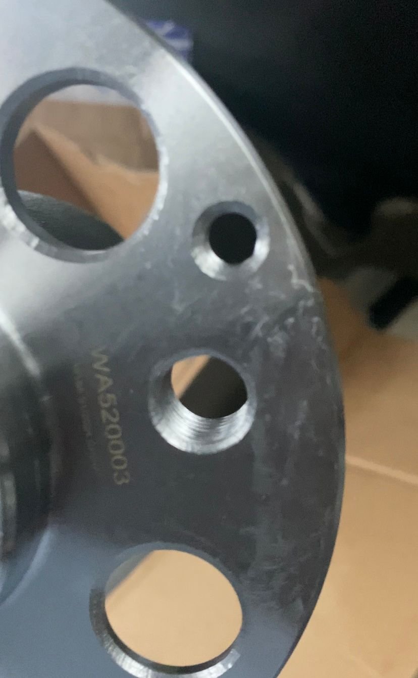

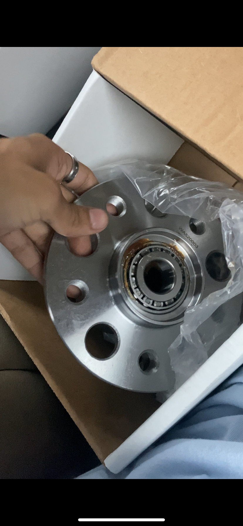

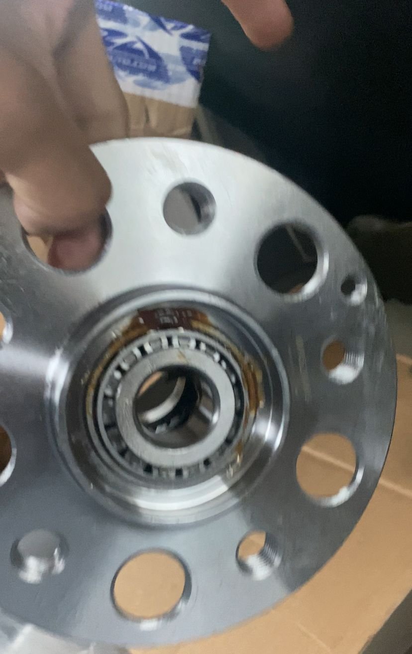

so I bought these wheel hub and bearings and apparently it didn’t fit. My mechanic said it’s better if I buy a new spindle . He said I bought the wrong part .

The instructions I have say to replace the hubs, though I have seen people re-use the hubs. Either way. Not sure they come with the bearing already on.

those little teeth on the inside , what is that? He said he couldn’t replace the hub because the other I bought doesn’t have them . Now I got to buy one that does

Those are the splines, the end of the cv axle has them also, they lock the hub and axle together.

I looked up that hub you bought and appears it's for a 2012-2015 C250 rear wheel drive. Like your mechanic said it won't fit with your 4matic.

oh ok , yea I figured I bought the wrong ones when I took the tire off and I checked the wheel hub . But my mechanic said he can do the bearings but it’ll be good if I do the hub as well . Just wanna know what kind of size bearing do I need? How can I find out? Also if I don’t change the hub is it bad? Can it cause damage to my car over time?

I posted all the part 3's above in Post #9 in the diagrams.
- Bearing 2219810406
- Hub 2213370245
I would re-use the hub, unless it is obviously damaged somehow. When you press out the old hub from the wheel carrier the old bearing will get destroyed, part of the bearing will remain on the hub. To re-use the hub you will have to pull off that part of the bearing. If you cannot remove the bearing from the hub then sure just replace the hub.
