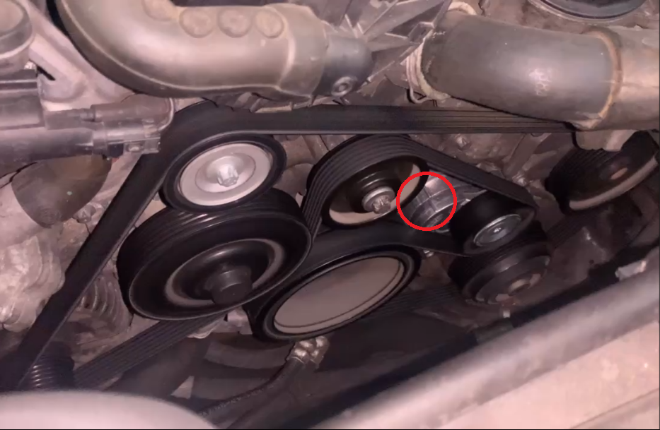

I wont have my car until Monday so I cant check mine. But from my photos it does look like there is a small space between the front face of the belt and the front leg of the smooth pulley. You can remove your smooth pulley and look for any abnormal wear on the inside face. On my old smooth pulley i did not notice any abnormal wear. But then again i do have that washer installed on the back of the pulley.
Where does your tensioner marks line up? Maybe take a photo, like i posted of mine above. It should be within the two guide marks.
What exactly do you have installed for the grooved pulley? because you mentioned some spacer in a tsb.
Post #5 you mention black paint rubbed off the smooth pulley, do you mean its worn off on the smooth surface that the belt rides on? Because that is normal, can see the pain worn on my old pulley as well.
Here is the picture of markings on my tensioner. It is in the middle of the two markings. I installed a 1 mm spacer behind the lower guide pulley just like the TSB states but upon startup it was constantly squeeling. I had to remove it again. I don’t understand the issue with my car.

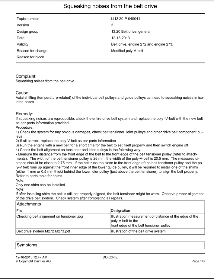

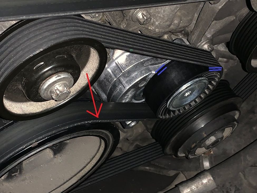

In the photo above I notice some lines on the smooth side of the belt, I dont see the same when I look at the photo way above of my belt and ive had mine installed well over a year now. Are those wear marks, frays? I cant tell.
I just finally opened up that TSB to see what it said. It says to basically look at the pulley on the belt tensioner and use that as a guide to set the idler pulleys, if a shim is needed. On my smooth pulley i have a regular washer back there, its not a recommended shim, id say my washer is 3mm. Then I look at my photo of the tensioner pulley and I can see the wear marks and my belt looks to be running a bit too forward, but ive had it like this without issue to im not going to touch it.
When I zoom in on the photo above of the belt tensioner it looks to me that the belt is in the correct position, or maybe a little forward. It does not look like it needs a shim on the smooth pulley at least.
The white marking you see on the edge of the belt is the white lacing or whatever you call it. Everything seems like it’s in line but I do see the belt wobbling around. Let me see if I can record a video of it. Do you need a picture of the grooved idler pulley?

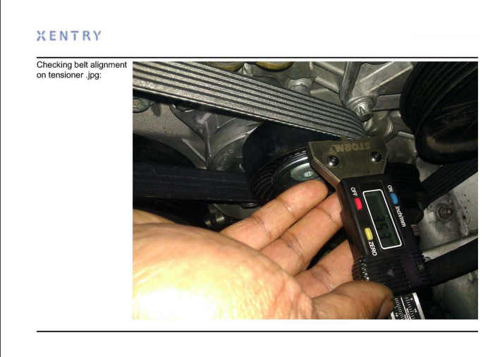

Above you mention having a shim at the GROOVED pulley? The notice for the shim refers to the SMOOTH pulley only.
Have you gone through the procedures outlines in the bulletin, measure the location of the belt on the tensioner pulley?
What I was able to notice is the tensioner appears to be really moving up and down. I dont think mine is like that, I think mine is smooth with hardly any movement. Ill have to double check. I tried to focus in on the crankshaft pulley to see if that is wobbling, couldnt really tell.
I also noticed the belt wear marking is all the way near the end, at the line that shows it should be replaced? What size belt do you have on there?

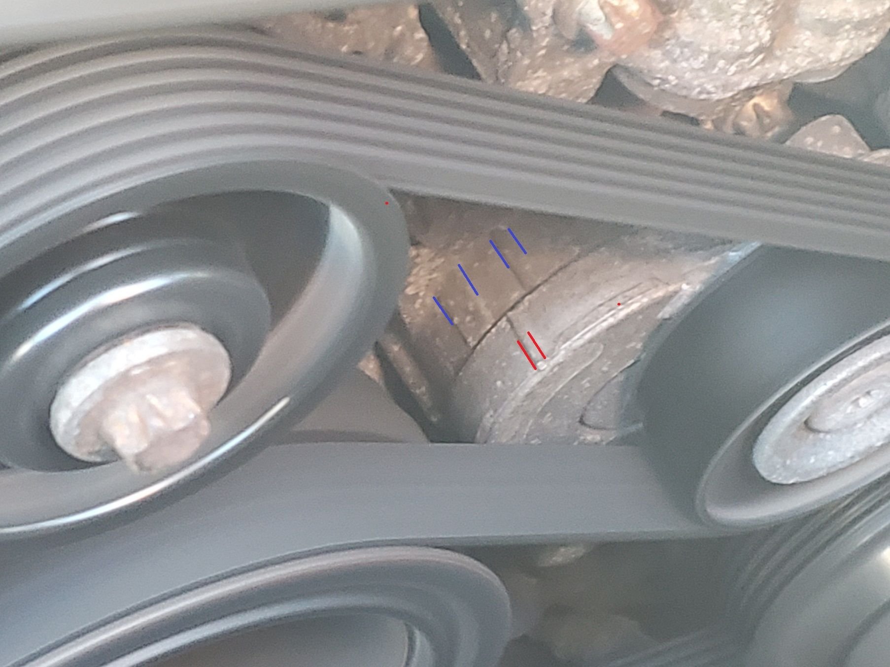

I was curious how much my tensioner moved with the engine running so just went out to check. The marking on the tensioner doesnt seem to move much with the engine running.
engine not running:
Engine running:
Old Nov 30, 2024 | 02:30 PM

the markings don’t move much either on my car regardless of the engine is running or not. Right now what I found is that putting a smaller belt is loose and making so much noise compared to the 2397mm
