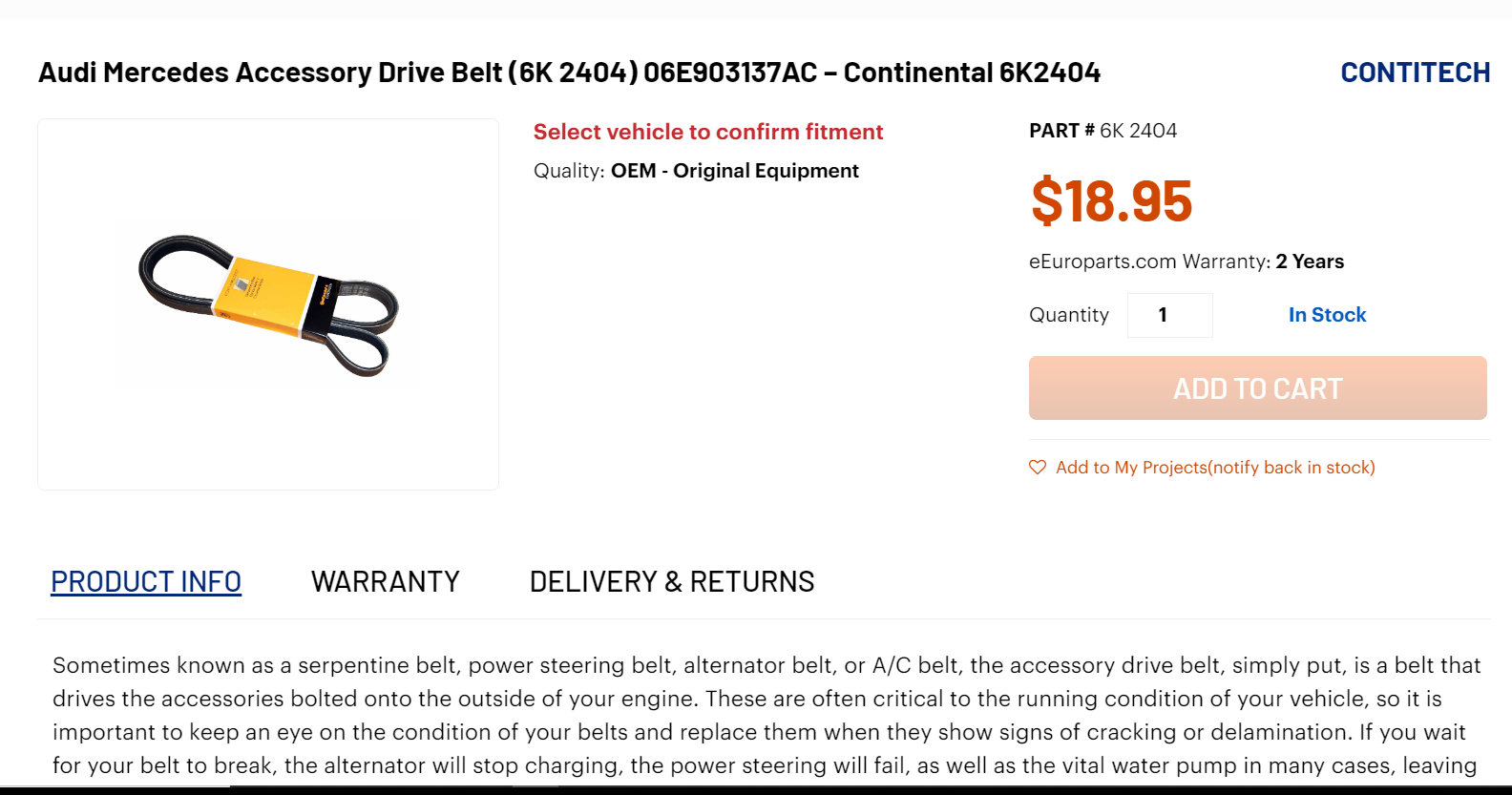

My Operators manual says "Poly-V belt 2401mm". I bought and installed a Continental 2404mm and it fit great. I bought the gates brand tensioner and it ended up looking exactly like the Mercedes tensioner i removed from the car, the Mercedes tensioner was even stamped Gates on it. For the two idler pullies i bought INA brand. It has been running great, no noises. When I recently replaced the smooth idler pulley I noticed there is a washer on the back between the pulley and the engine, good thing I was paying attention of i would have dropped it.

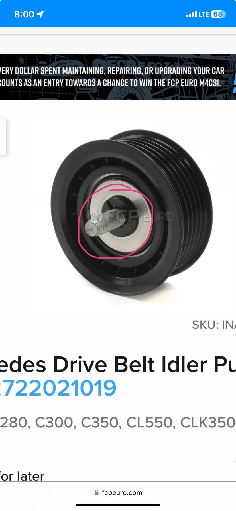

I just installed the upper idler pulley as how you see it in the picture. Am I supposed to remove the black plastic you see in the picture before installing the pulley? I don’t have a washer behind it.

That plastic thing stays, no problem. If you remember the old washer coming off with the original pulley, then you’re good. I have no ideas beyond this.

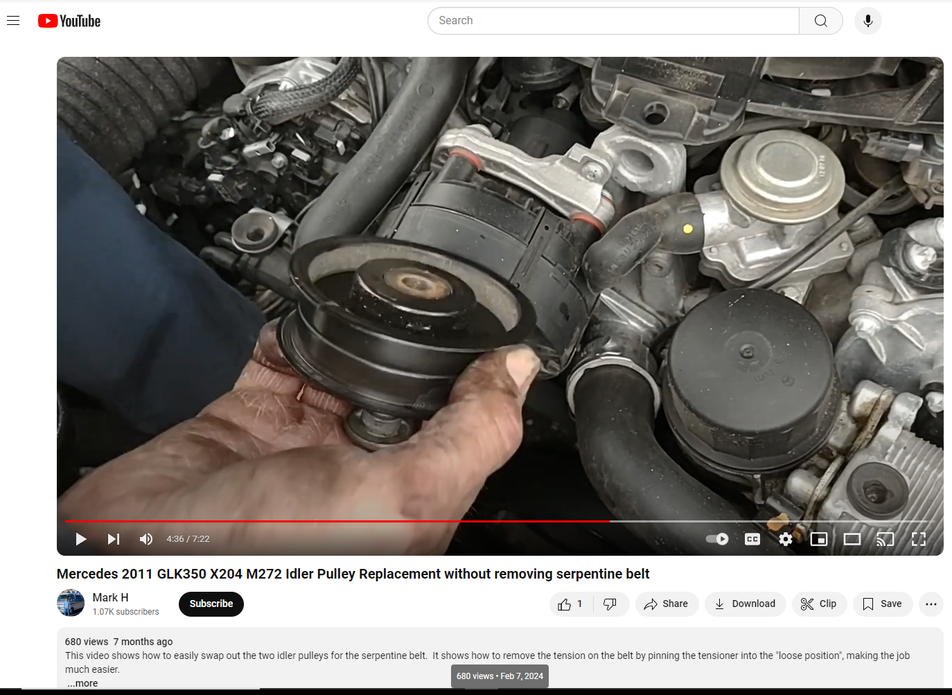

I watched a youtube video and this guy doesnt appear to have a washer on his smooth pulley. So I dont know why mine does to be honest.
Reading the Pelican Parts article on replacing the idler pulleys they dont mention the washer, though i wrote a comment about finding the washer on mine previously.

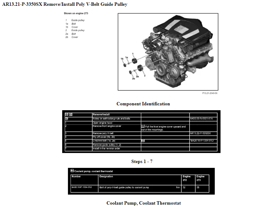

are the bolts for the tensioner and pulley on tight enough. I have 35nm for the tensioner bolts and for the idler pulleys i think i used 25nm (follow-up operations).

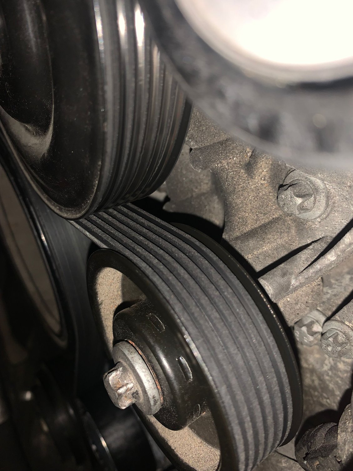

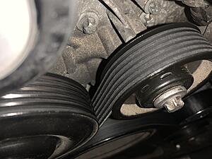

While looking around in the engine bay today, I noticed that the belt is running very close to the front of the lower guide pulley and there is about a 1 mm gap between the back of the belt and the rear portion of the pulley. Is that normal? It is seated properly on the water pump pulley however.

Hello,
I put a straight edge on both the pulleys and with the naked eye everything seems like it’s lining up as it should. I have some pictures that I will attach. As you can see in my picture, the belt is running close to the front part of the smooth pulley and there is like 1 mm gap at the back. Idk if that is normal. It does look centered on the water pump pulley grooves.

I wont have my car until Monday so I cant check mine. But from my photos it does look like there is a small space between the front face of the belt and the front leg of the smooth pulley. You can remove your smooth pulley and look for any abnormal wear on the inside face. On my old smooth pulley i did not notice any abnormal wear. But then again i do have that washer installed on the back of the pulley.
Where does your tensioner marks line up? Maybe take a photo, like i posted of mine above. It should be within the two guide marks.
What exactly do you have installed for the grooved pulley? because you mentioned some spacer in a tsb.
Post #5 you mention black paint rubbed off the smooth pulley, do you mean its worn off on the smooth surface that the belt rides on? Because that is normal, can see the pain worn on my old pulley as well.

OP in that smooth pulley, is there a washer between the bolt face and pulley? I have a washer in that position if I recall, but it's on the inside.

I have a washer on the smooth pulley, its on the inside between the pulley and the engine. Strange that I do not see this washer on any parts diagrams though.
