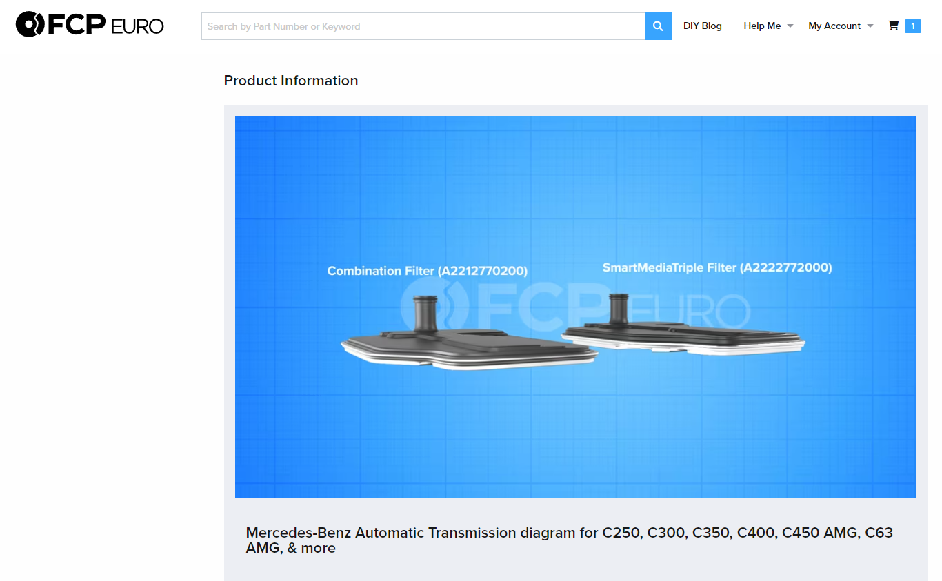

Is that the upgraded transmission oil pan? It doesn't look like it. If not, I highly recommend you go that route because it uses a much improved oil filter. To answer your question, it takes a little while to get to 45°C. You should be able to monitor it with your Foxwell scanner. You will have time to do what you need to. Just don't go to lunch.
https://www.fcpeuro.com/products/mer...n-001989680310

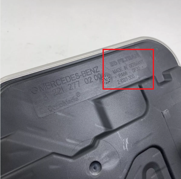

I bought the pan from FCP awhile ago so probably cant return it for the A89 pan. Plus I figured if it was really necessary then MB would have made the change mandatory, like they did for the earliest pan swap? I did get a Filtran brand filter which I believe is the OE Mercedes filter. Mercedes pan, Elring gasket and bolts, Mercedes overflow tube, and the Shell atf134 which I read is good fluid. I found it for a good price on Amazon and see its even cheaper now, $42 for 6 quarts.
I was a bit surprised to see made in China when I received the filter. I researched Filtran and they do have factories all around the world.

...I was a bit surprised to see made in China when I received the filter. I researched Filtran and they do have factories all around the world.
Actually, you can return the pan. I did when I got a kit for my 2004 SL500 and never used it because I traded the car shortly thereafter. It was several years later I went through my garage and returned all the stuff I was going to use but never did. FCP will give a store credit, but they will take it back.
Filtran is supposed to be good quality, but I use FCP as my litmus test and they do not offer that brand. All of their non-Genuine filters are out of Taiwan and only the Mercedes Genuine filter is out of Germany. Honestly, for the price and time and trouble it is going to be to change the filter, I would definitely get the Mercedes filter (as Ken on MercedesSource says).

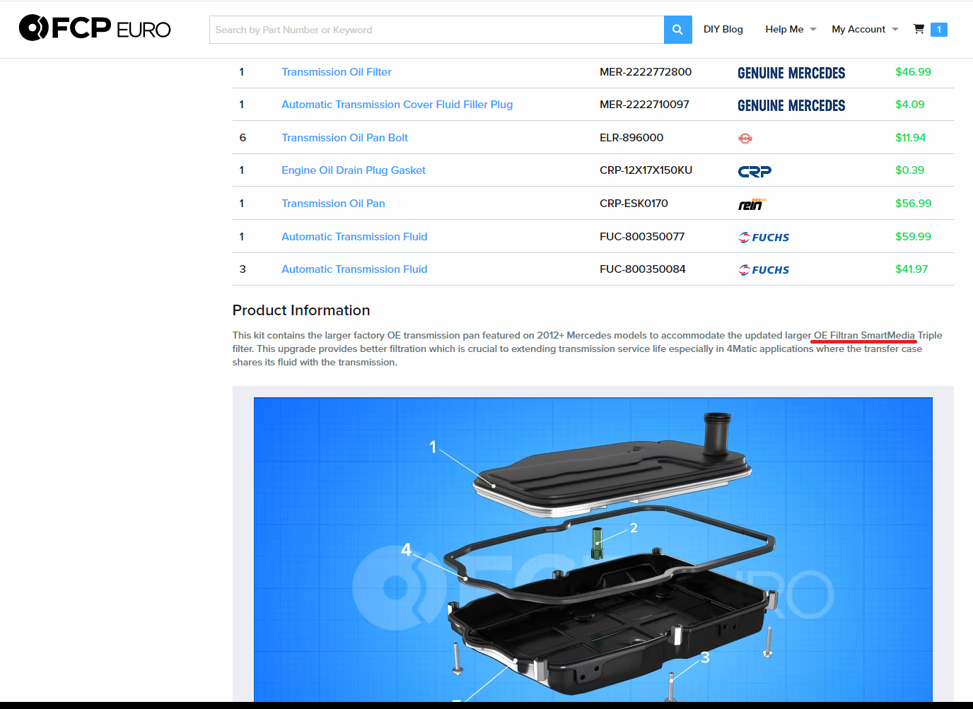

I guess I can see an argument for swapping the pan and filter and also against swapping them.
For - The A89 pan/filter offers more fluid capacity and better filtration.
Against - The A89 filter is not made for the atf134 red fluid. Isnt the red fluid thicker? Also isnt the fluid capacity not that much, maybe 1/4-1/2 quart more? And Mercedes does not appear to recommend this swap.
I tried searching for the difference between the Combimedia vs Smartmedia filters, im guessing the Smartmedia filter has an additional sheet of filter material, since its label Smartmediatriple filter.
I first came across the idea that Filtran made the Mercedes filters when it was mentioned on IDParts, so i searched for photos of Mercedes filters and sure enough they say Filtran, they actually say IBD Filtran made in Germany, at least the ones im finding. They both say Combimedia, so should be the same filter material. My thinking is this is like buying the Mann air filters, should be the same thing.

Did you watch the MercedesSource video above? The capacity is the same. Also, he explains the value.
You can use the red fluid with the newer filter.
